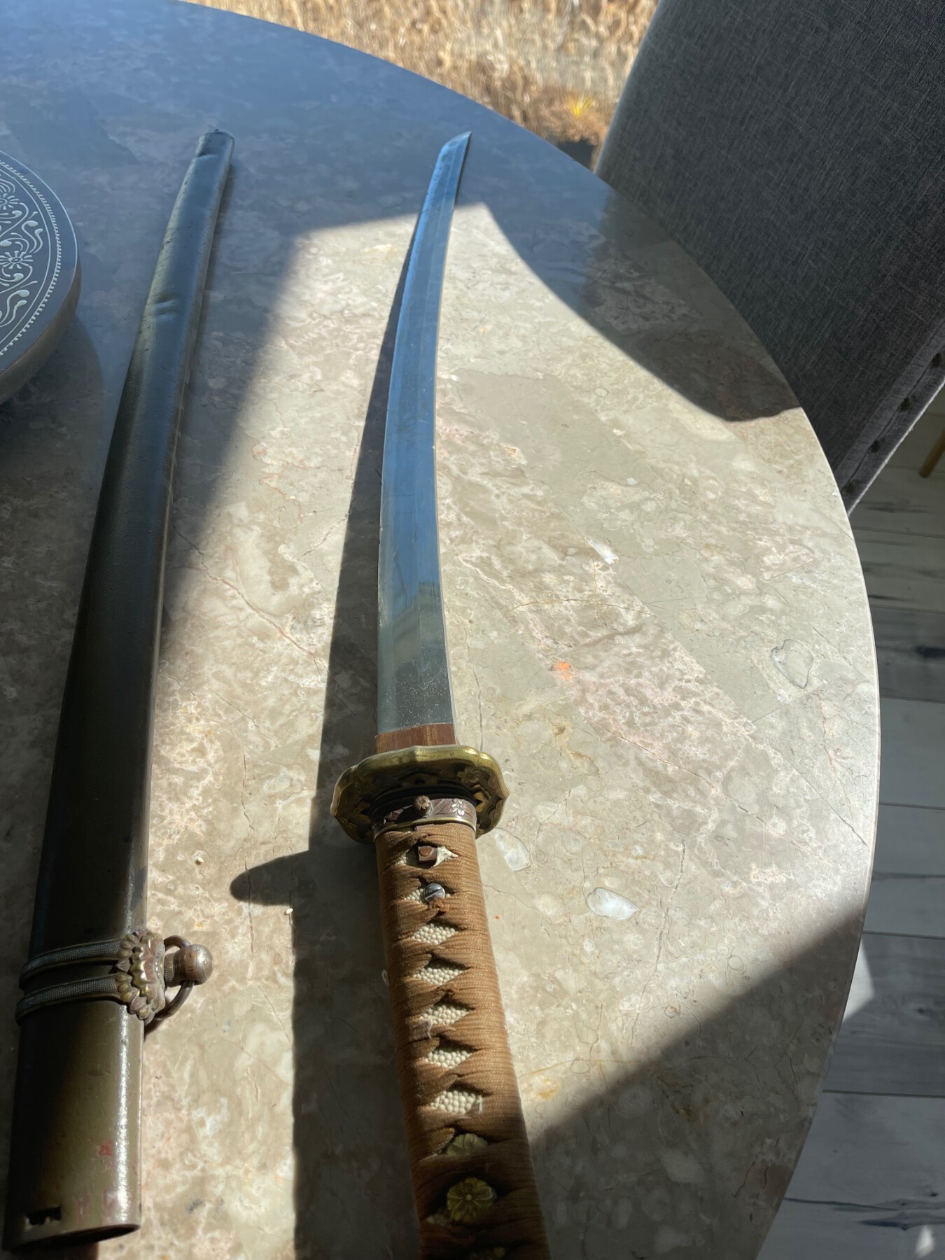

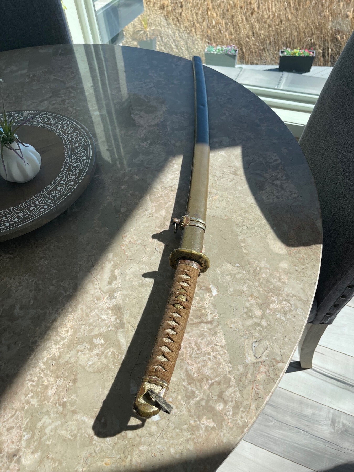

I was looking at a bring back sword in type 98 fittings for a friend today and helped him get it apart and was very pleased to find an Emura signed blade underneath.
The books and references I’ve seen posted all have his longer mei references or “Emura Saku” but I haven’t seen many references to just a 2-character mei except for a small handful of posts here. Someone said that blades signed just “Emura” might be made by Emura himself and not one of his prisoner swordsmith apprentices? Any confirmation on that?
The blade is in rough polish and the monouchi area has nicks and chips in the ha but it is stout enough that I think the owner might look at a polish for sentimental reasons. I was pleased to still see a pretty bright suguha based hamon with lots of nice small activity throughout even through the old polish.

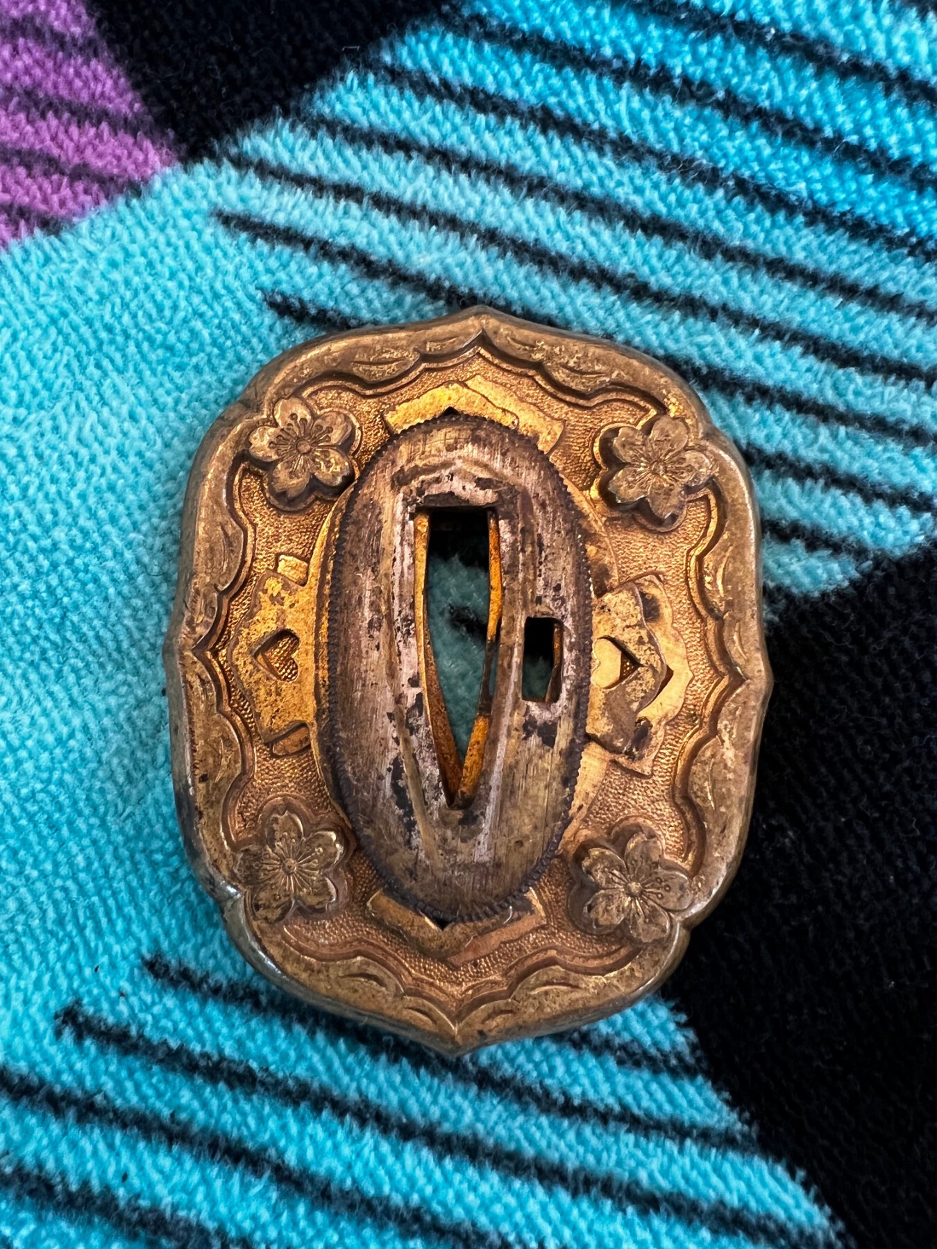

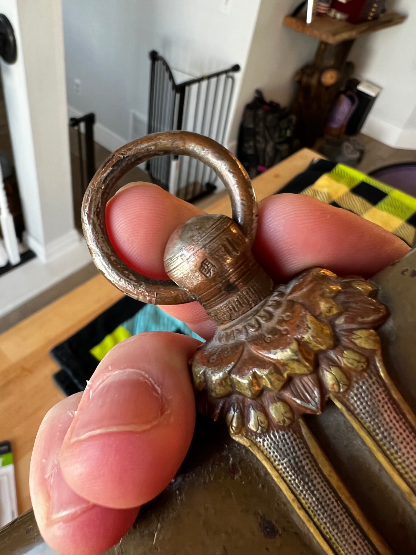

The saya is the most damaged part of the package and is missing a lot of parts and probably needs a restoration or just a new saya to complete the set. The other fittings are all stamped 231 and match the paint marks on the nakago which was good to see.

The sugata looks typical Emura,stout base gradually narrowing,mine has distal taper too,nice hamon which should reveal ashi and the mounts look to be of superior quality,all in all a really nice bundle!

What a great find! Mountings are convincing (also assembly numbers on nakago).

I have exactly same variation mei paired with this nakago jiri (typical more for Nagamitsu then NBTHK acknowledged genuine Emura blade). Mine also have bad tsuba swapped from particular type of replica with numbered habaki.
