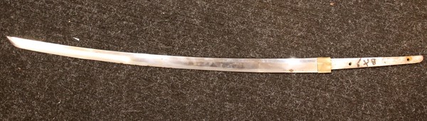

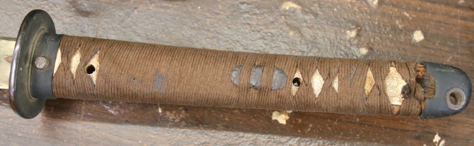

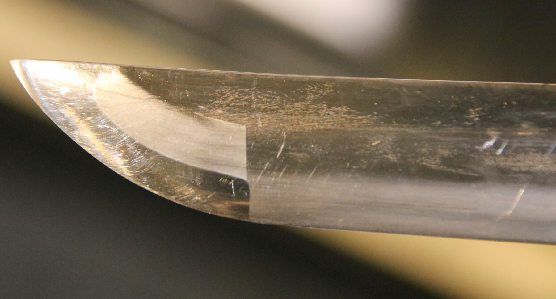

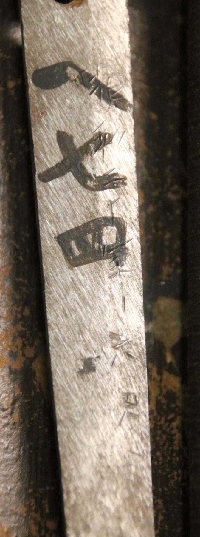

Patinamax Posted February 19 Report Posted February 19 Hey all, it's that time again! I have a sword here a client has asked me to identify/valuate - and it is interesting. Any information will help - smith name, date, etc. I don't have any details or provenance, but he has a lot of vintage swords, vintage US military gear, etc, so possibly a relative who collected artifacts from WWII. Appreciate the help in advance, and please feel free to ask me for more pictures, and I will get around to them when I am able. I will post the additional pictures in replies as they are a little too big to upload all to the main post. Quote
Patinamax Posted February 19 Author Report Posted February 19 Total length (sheathed and with all parts attached) is approximately 39 1/4" or 99.6 cm Quote

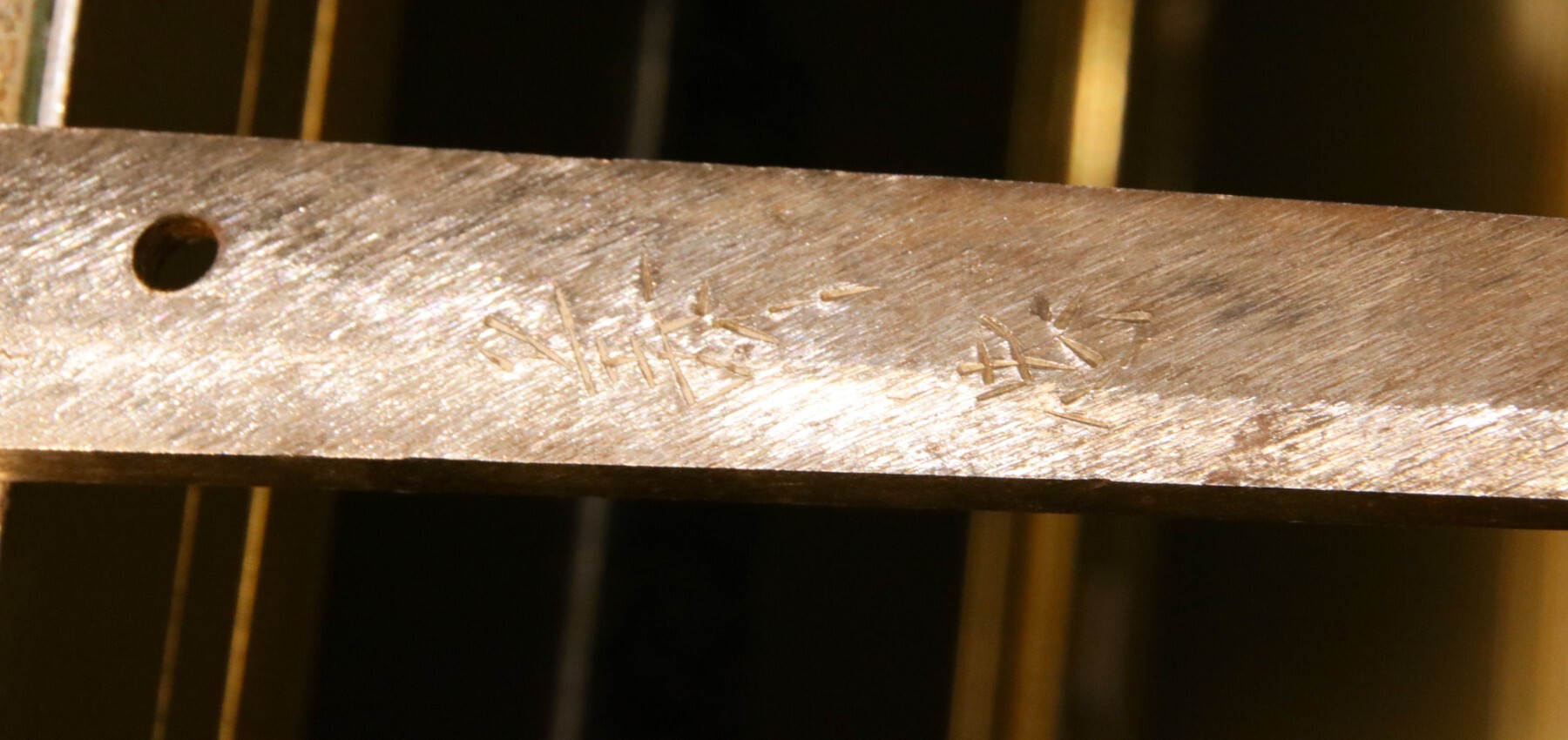

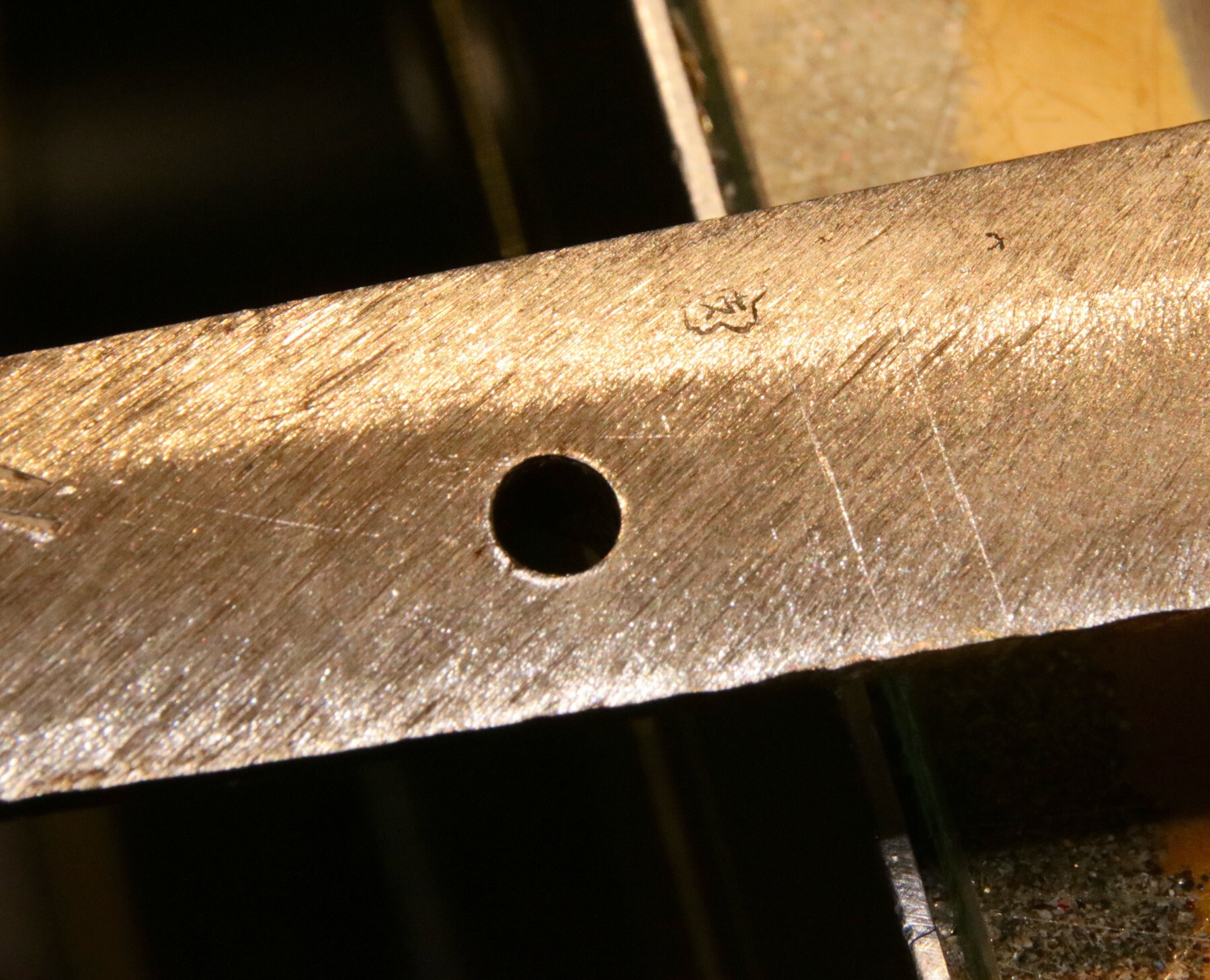

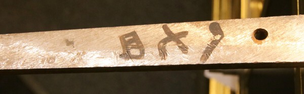

Conway S Posted February 19 Report Posted February 19 Hi Lance, It looks to be signed Yoshitada and dated June 1945. It’s in Type 3 Army fittings and is not traditionally made. The black painted numbers are subassembly numbers and may match the fittings (八七四=874) or the first character could be hiragana. There is also the Gifu inspector’s stamp on the nakago. 1 Quote

Patinamax Posted February 19 Author Report Posted February 19 18 hours ago, Conway S said: Hi Lance, It looks to be signed Yoshitada and dated June 1945. It’s in Type 3 Army fittings and is not traditionally made. The black painted numbers are subassembly numbers and may match the fittings (八七四=874) or the first character could be hiragana. There is also the Gifu inspector’s stamp on the nakago. Hey there, thank you for the information. I had an extremely short period of time to list this as my store has been extremely busy, so apologies for the errors. Quote
Scogg Posted February 19 Report Posted February 19 (edited) No harm no foul. I move around posts quite a bit, and it’s really no problem at all. I just want to make sure we get the right eyes on your sword Your stamp appears to be the Sakura flower with Gi inside. You can read a little about it in Bruce’s stamps document in the download section. I have a tsuba with this same stamp, of which can be seen on my post in the link below: https://www.militaria.co.za/nmb/topic/5999-arsenal-stamps/page/51/#comments Are there any stamps on your tsuba? All the best, -Sam Edited February 20 by Scogg Correction Quote
