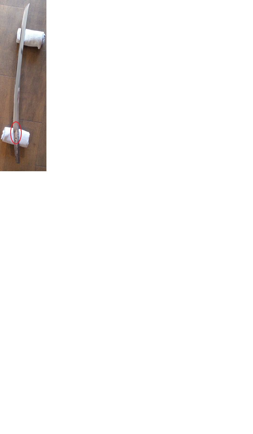

OK, these don't help much because they are bit out of focus, and the machi area of the blade (not the spine) is what I wanted to see (see the red circle in the photo below). All I can say is that it is possible this sword could have been shortened down.
But then you have an anomaly because I don't think any of the Kanabō smiths made any tachi. They are from an era when the tachi production was dwindling. And, I don't know if any of them signed with just the two-character Kanabō name. Also, I haven't looked at any of my references to see if there were any smiths besides the Kanabō group who used these two characters as a name (Kanefusa). So, not a lot of concrete info for you.
