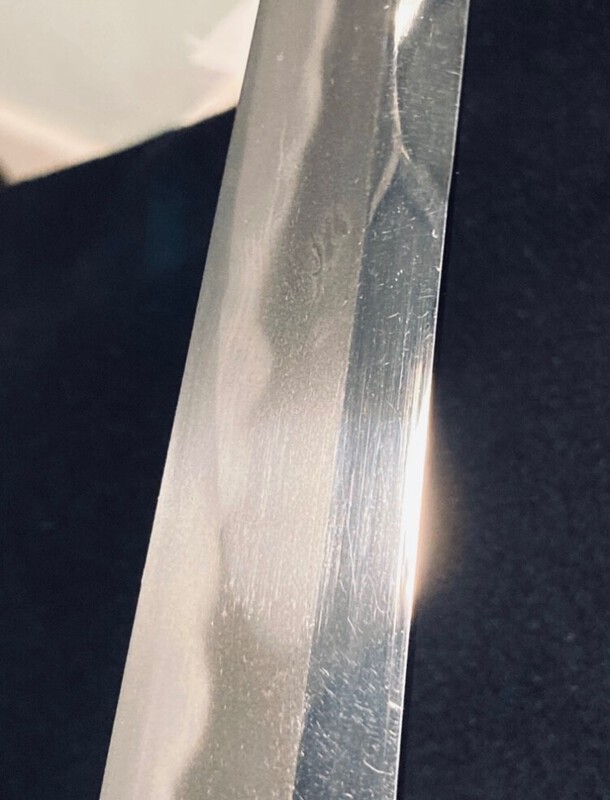

Maff Posted October 8, 2025 Report Posted October 8, 2025 Hey folks, hope everyone’s doing great. I’m looking at a line running from the shinogi into the hamon and running a bit within it - hopefully these pics will come out ok. Any advice on what this might be? Thanks! Quote
George KN Posted October 8, 2025 Report Posted October 8, 2025 Is it in the steel, or kind of on it? Its shape makes me think it might have been lying on a cloth or pillow (that may have had grease or something acidic on?). Quote
Maff Posted October 8, 2025 Author Report Posted October 8, 2025 16 minutes ago, George KN said: Is it in the steel, or kind of on it? Its shape makes me think it might have been lying on a cloth or pillow (that may have had grease or something acidic on?). Hi George, yes it’s in the steel. I oiled the blade earlier and it really popped out so to speak Quote
Robert S Posted October 8, 2025 Report Posted October 8, 2025 It does look a bit like a slightly acidic liquid may have gotten on the blade at some time. Don't think it's a forging (deep) issue. 1 Quote
Rawa Posted October 8, 2025 Report Posted October 8, 2025 Especially if there is no mark of it in shinogi ji part. Quote
Maff Posted October 9, 2025 Author Report Posted October 9, 2025 9 hours ago, George KN said: Is it in the steel, or kind of on it? Its shape makes me think it might have been lying on a cloth or pillow (that may have had grease or something acidic on?). Hi George, yes it’s in the steel. I oiled the blade earlier and it really popped out so to speak Quote
Maff Posted October 9, 2025 Author Report Posted October 9, 2025 Thanks guys! I’ll try and upload some better photos. Appreciate your time in taking a look Quote
