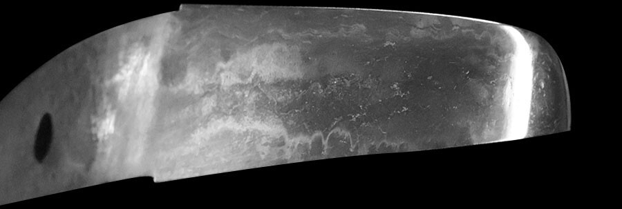

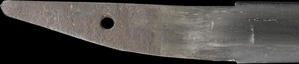

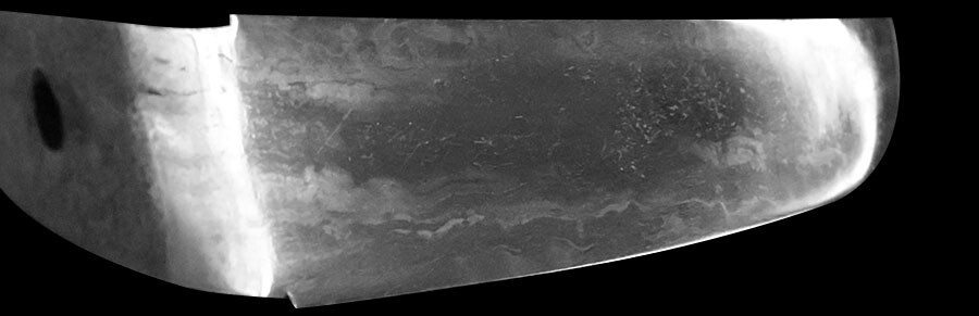

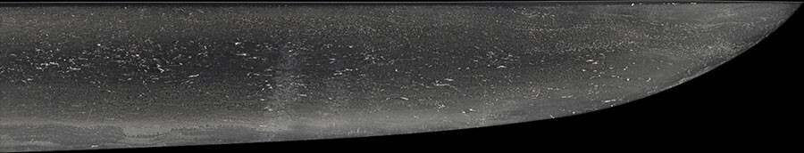

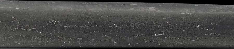

Rivkin Posted September 24, 2025 Report Posted September 24, 2025 The blade is in polish. It might be not the best, but its a relatively recent job. Hada is opening, as on many Muromachi pieces, and is rather unsightly. Otherwise, it is Soshu, with very long muneyaki and relatively quiet hamon, which could be lesser senjo or something like Masahiro lineage. The nakago's rather sharp tapering would lean towards the former, but there is a weird outline "jump" when it starts to narrow down, might be nothing, might be it has been reworked from a more broad version... I would get papers first. It is a big question if another polish will substantially improve anything and there is one place where hamon runs very close to the edge, if not passes it. Still, it is late Muromachi Soshu, quite possibly Masahiro or Senjo school. 3 Quote

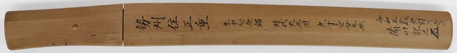

Bugyotsuji Posted September 24, 2025 Report Posted September 24, 2025 勢州住 is living in Seishu (Ise), and the date given in the sayagaki is 天正 Tensho period. 1 1 Quote
