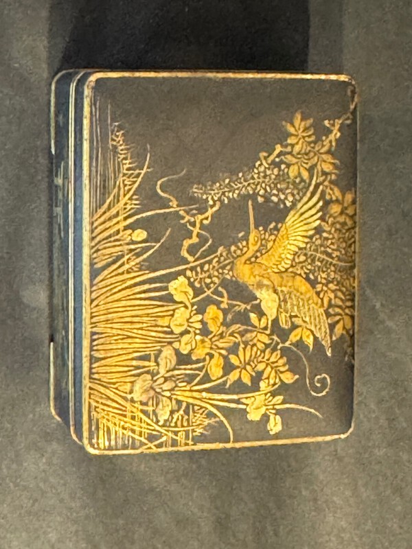

One of the last pieces Ford restored for me was a box by Jomi Eisuke, decorated in Nunome Zogan upon patinated Iron.
Please enjoy :
The Fuji Yoshitoyo box is Bronze and the subtlety of the etched work far exceeds the flatness of Nunome Zogan on Iron.

I'll post some Hi Res images next week, which will show the differences.
