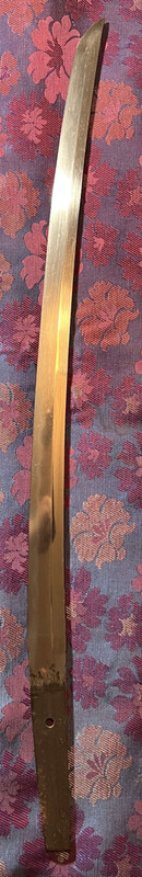

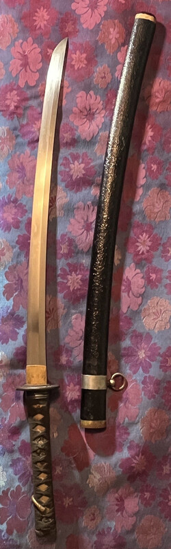

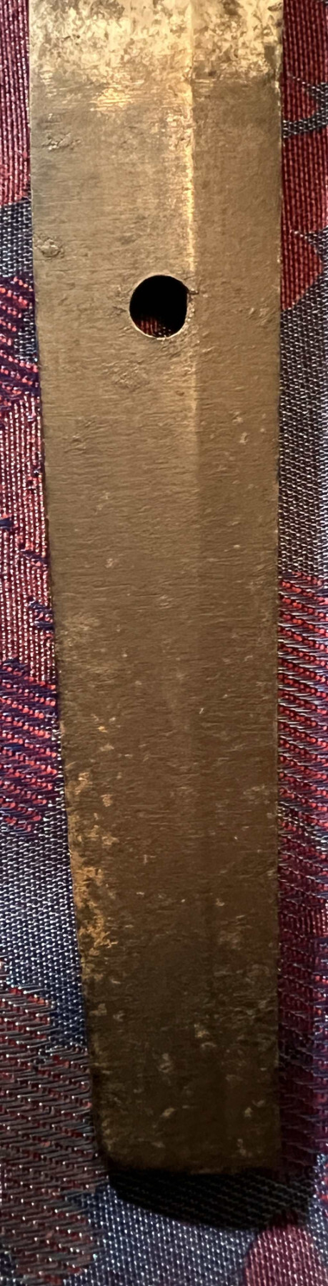

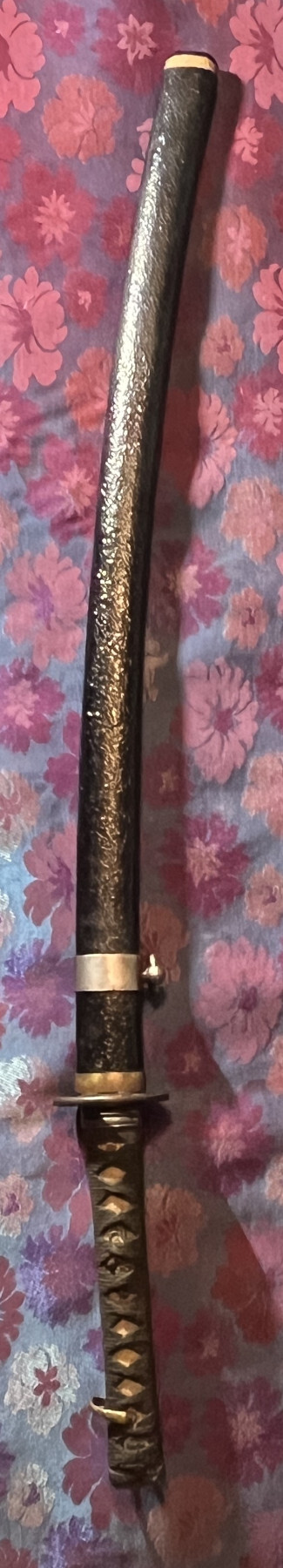

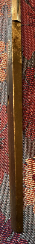

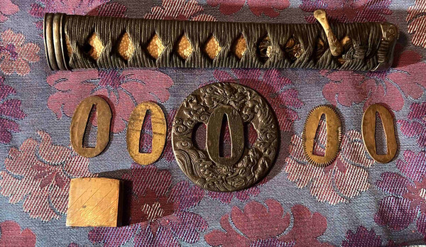

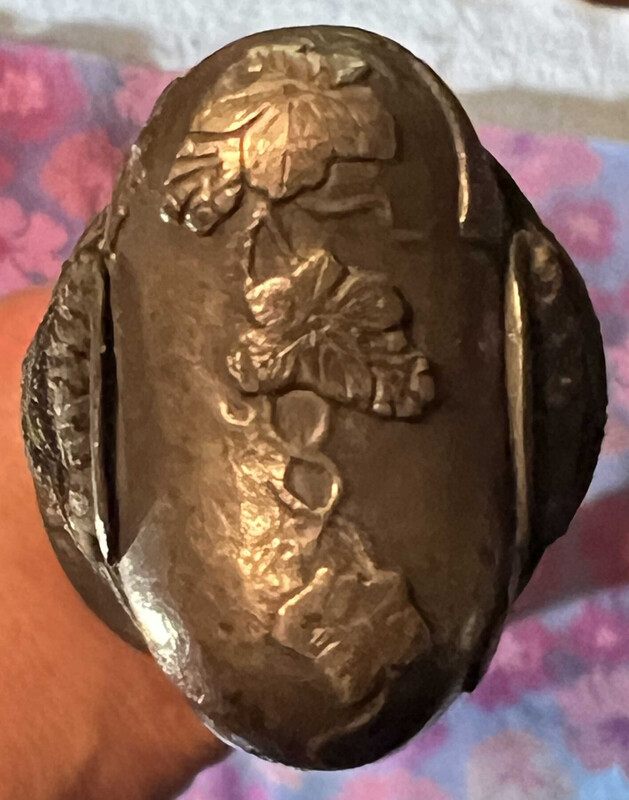

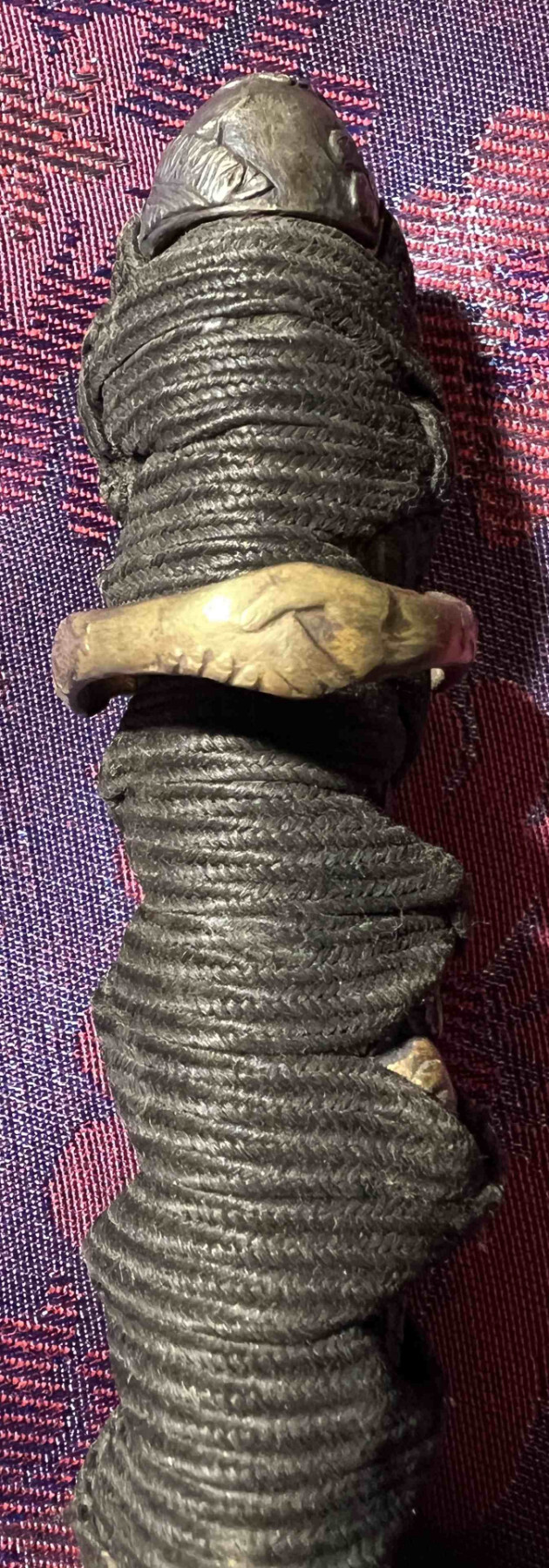

Dogditcher Posted June 12, 2025 Report Posted June 12, 2025 Wakizashi 20 1/4 This sword seems to have unique attributes Decorative Kashira Clasped Hand Sarute Saya is different Nakago shows age Enjoy Any information is appreciated Thank you Steve Quote

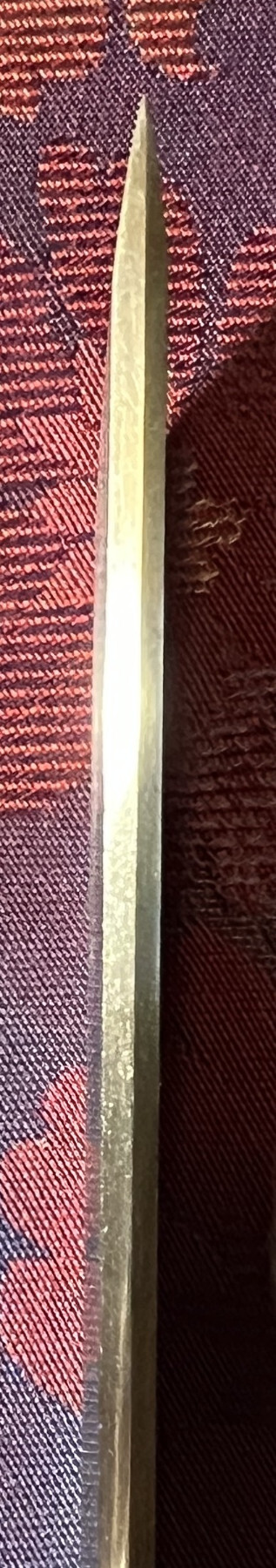

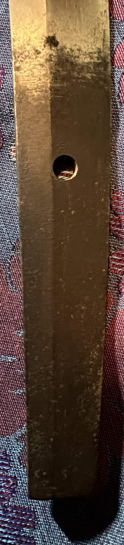

David Flynn Posted June 12, 2025 Report Posted June 12, 2025 Osuriage, cut down from a Katana, maybe. Also, it looks like the kissaki has been re-shaped. Quote

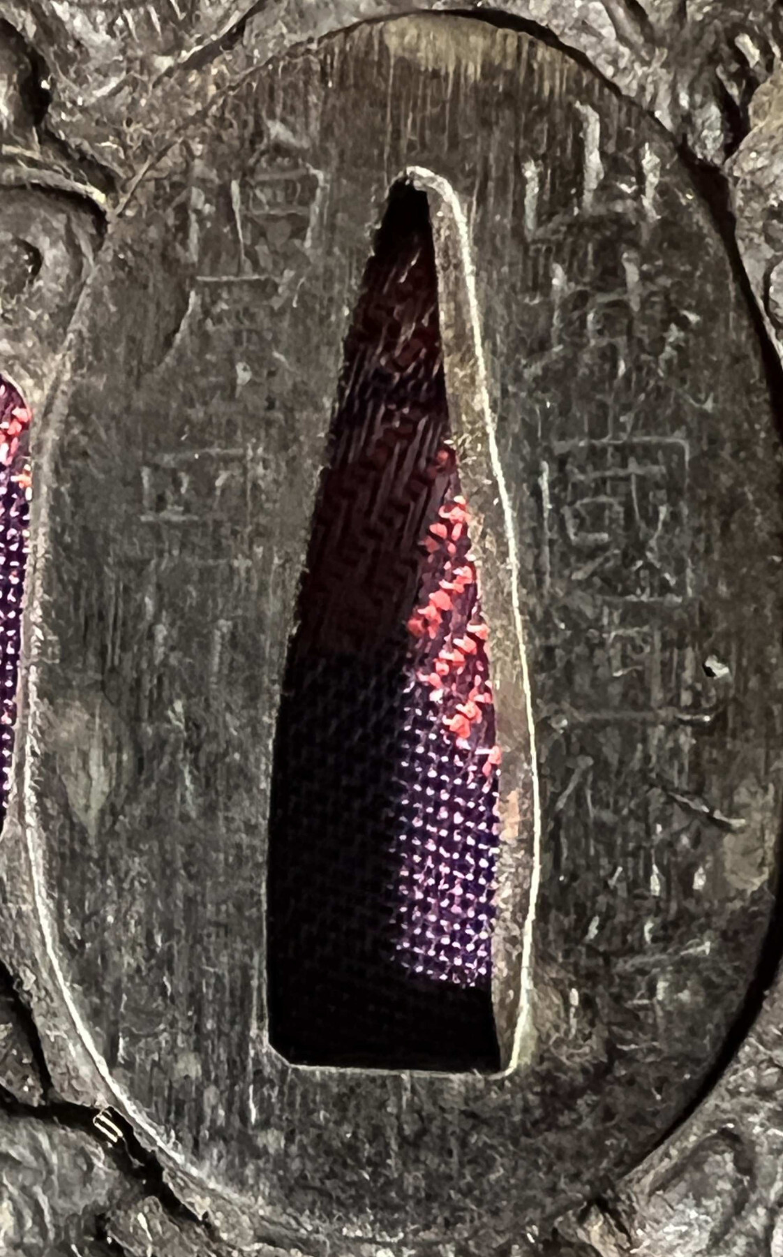

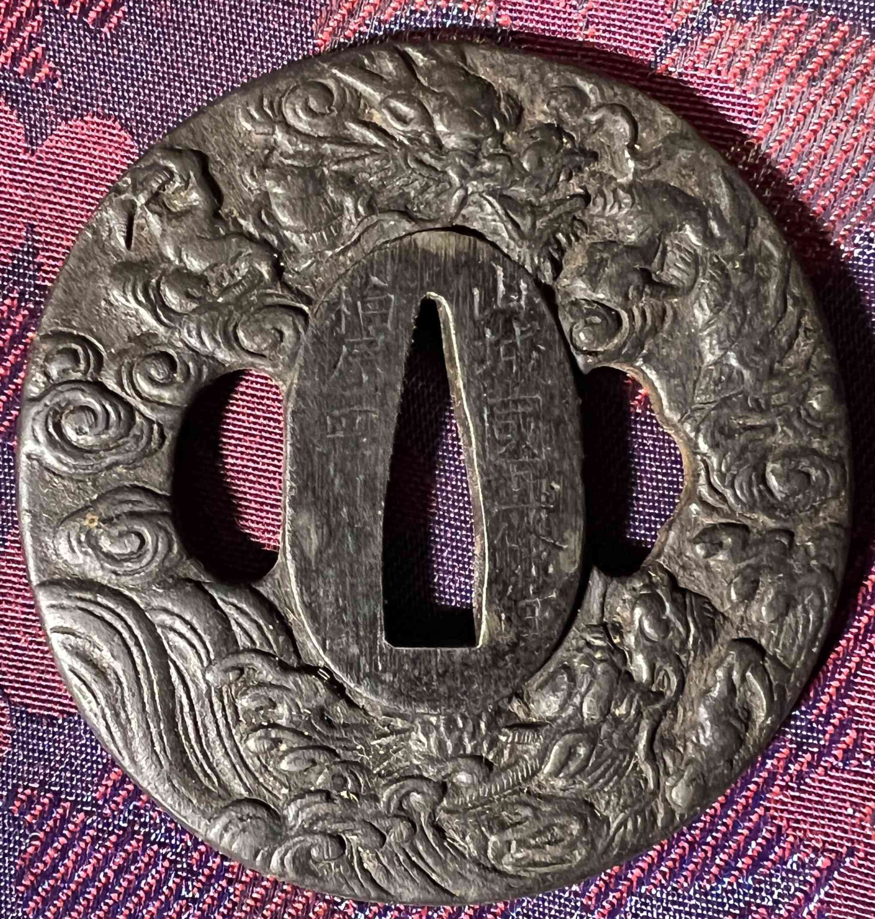

Geraint Posted June 13, 2025 Report Posted June 13, 2025 Dear Steve. Just to add the tsuba is a cast copy,(straight lines all over the seppa dai and blurred mei). The photographs are not detailed enough to tell much about the fittings but it is not uncommon to find swords quickly militarised by the addition of a hanger and a sarute, probably originally a leather combat cover. All the best. Quote
