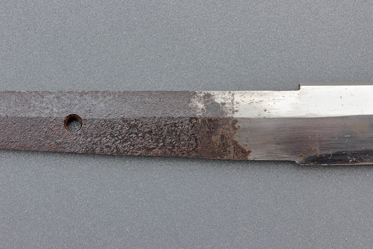

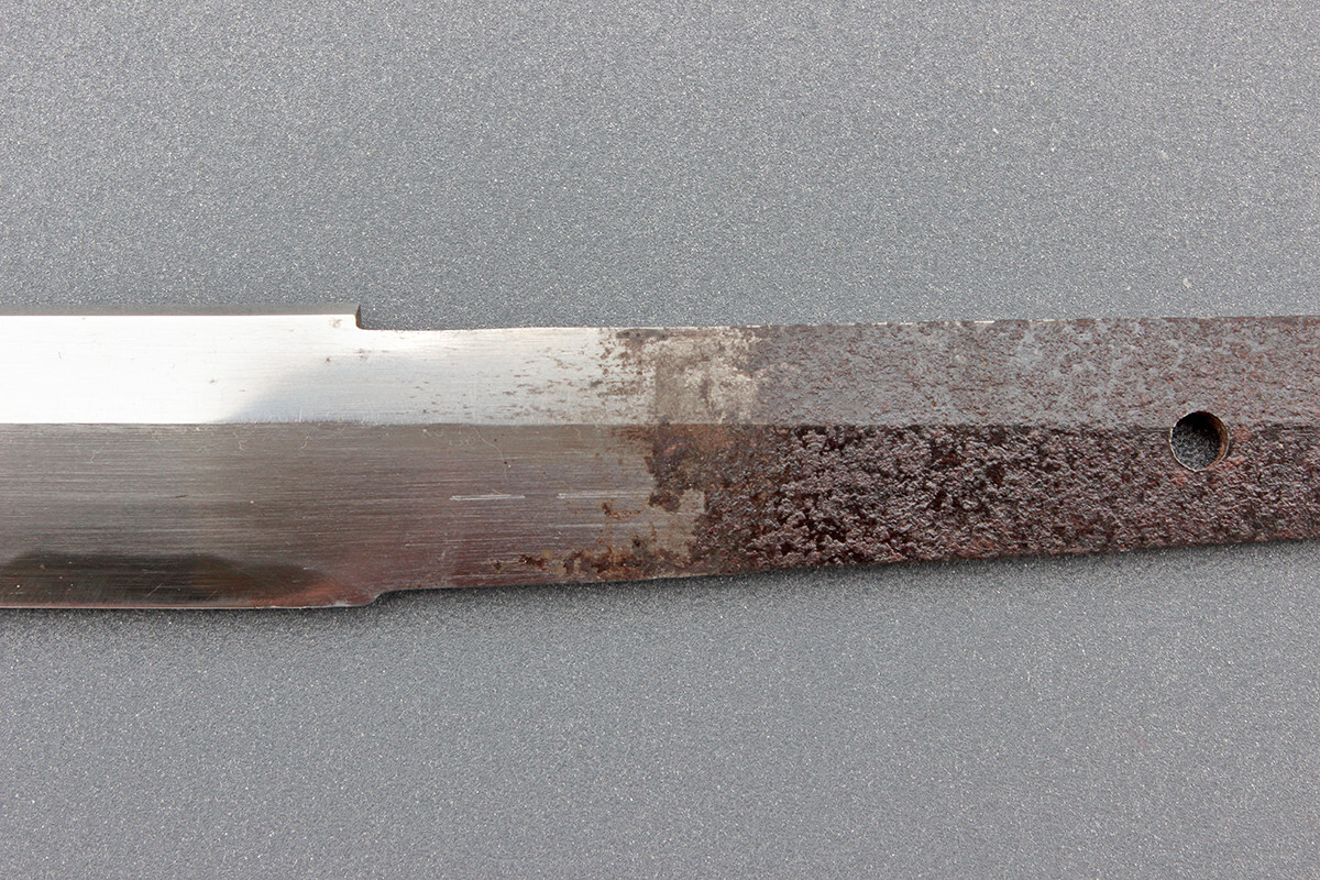

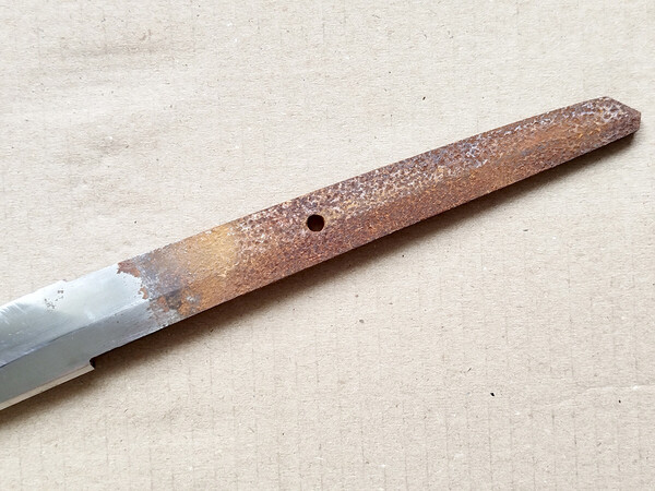

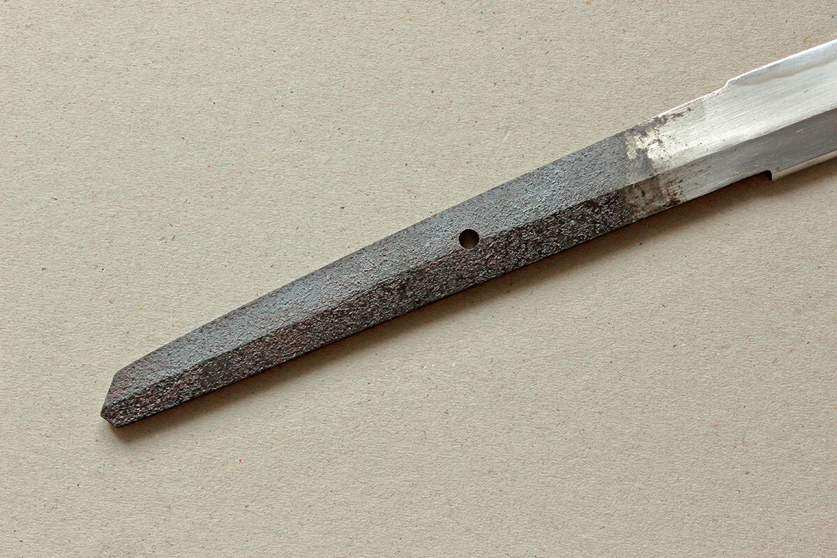

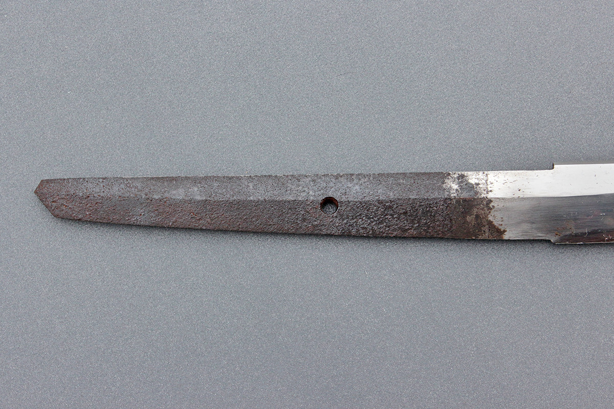

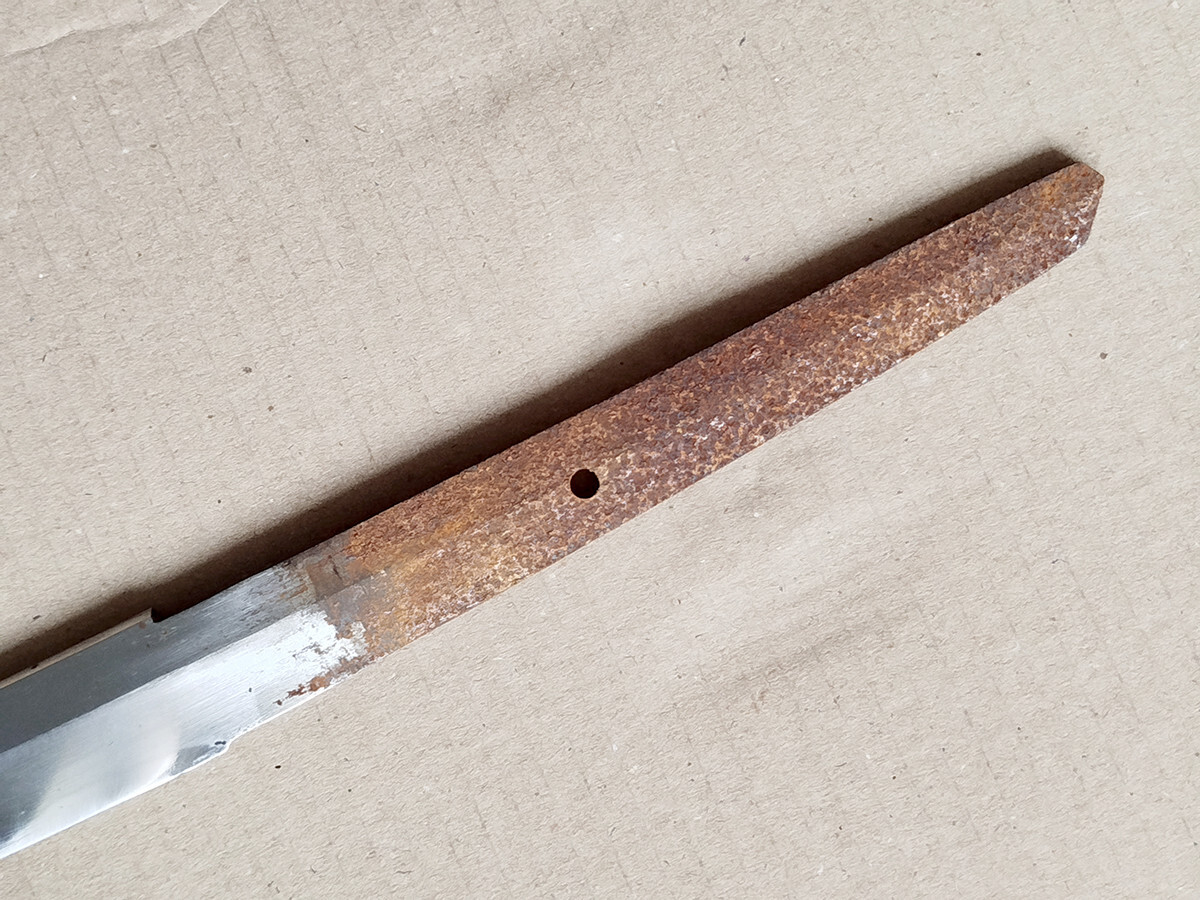

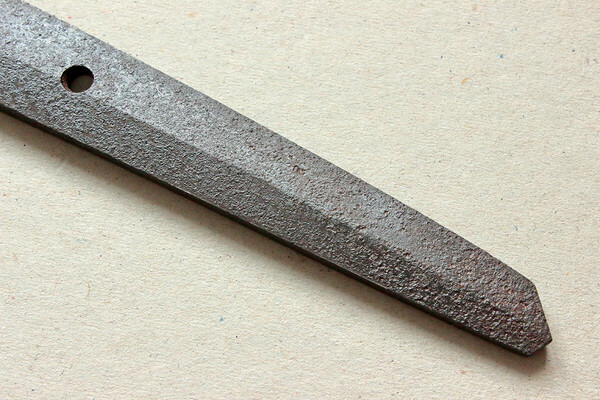

I removed superficial red  rust from the nakago. I worked very carefully and slowly.  The only markings I found on the nakago is number 2. No arsenal stamps, no any kind of inscription. The thing that I thought may be an arsenal stamp turned out to be just a play of light on rust. Same number 2 I found on habaki, wooden halves of tsuka and chuso. So, at least these parts belong to the blade. Here are photos nakago before:

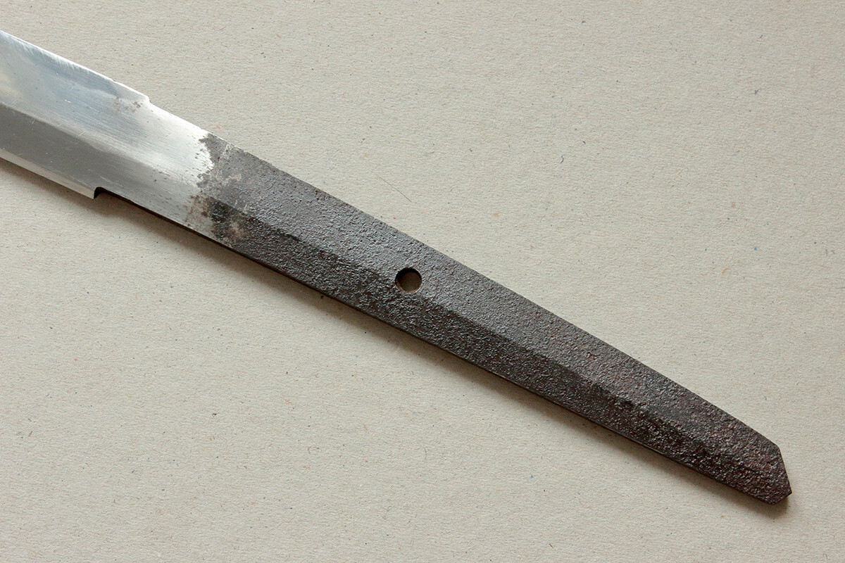

And after:

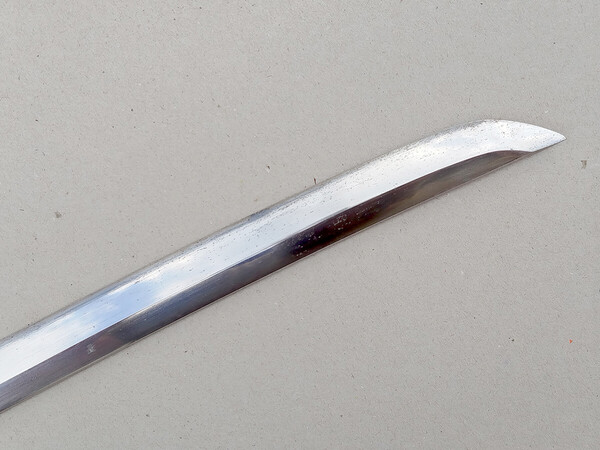

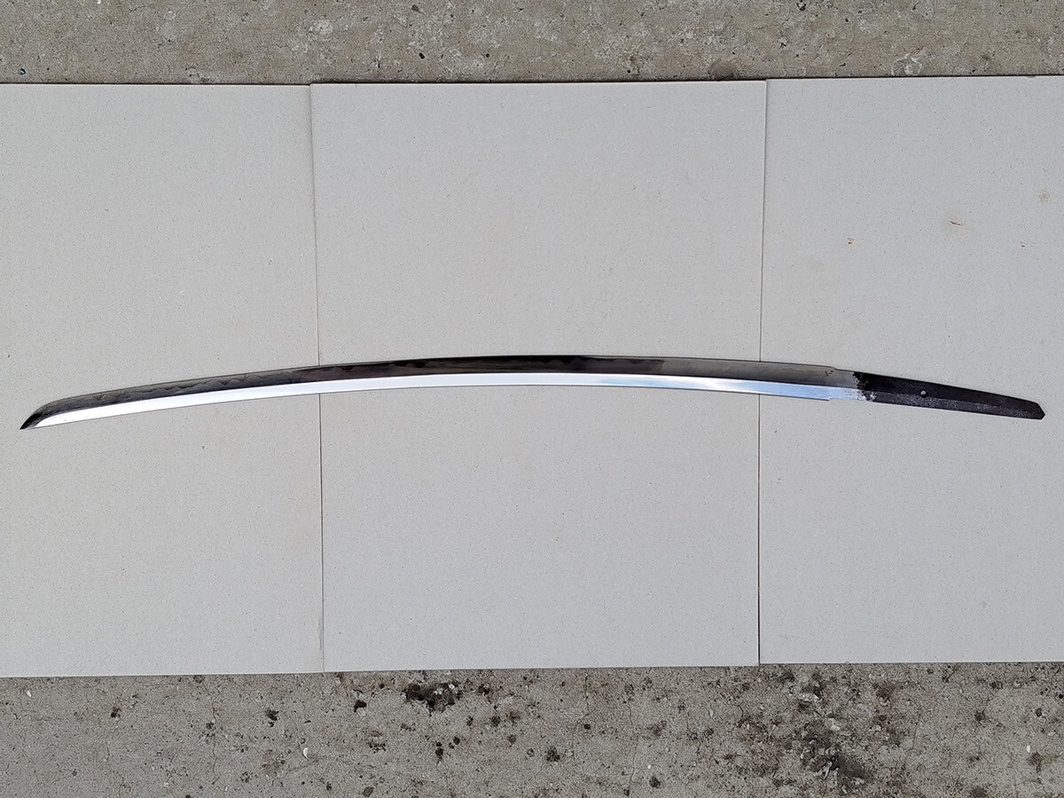

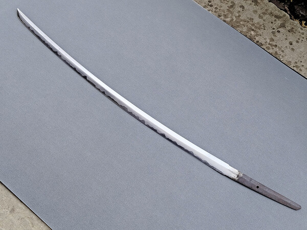

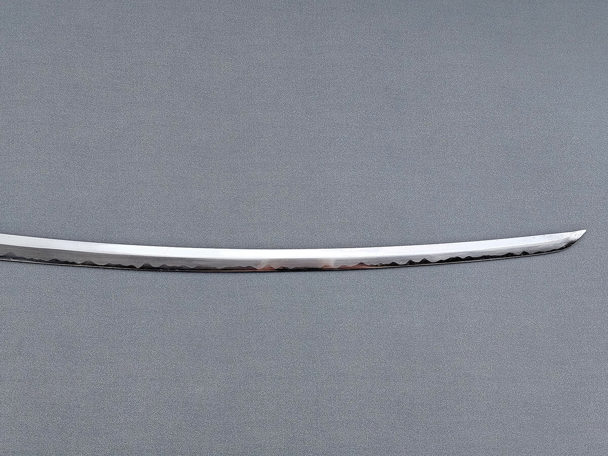

The Nagasa length is 67cm which is pretty standard for a gunto. Photo shooting the blade that was buffed is quite an issue. I did my best though.

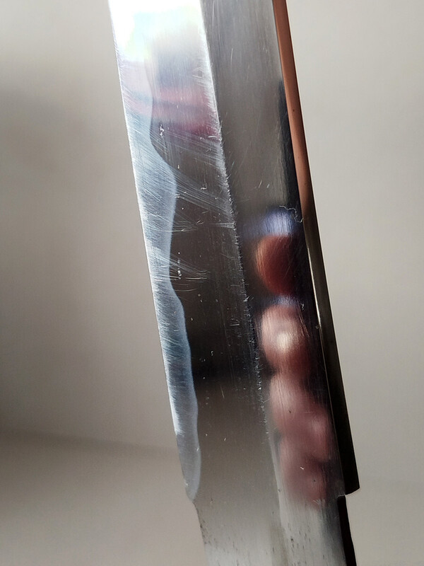

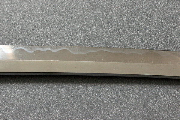

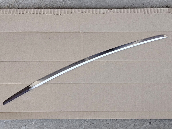

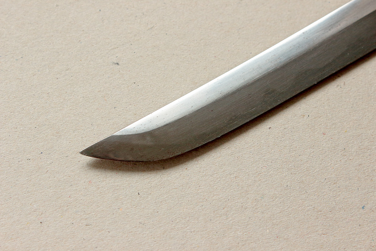

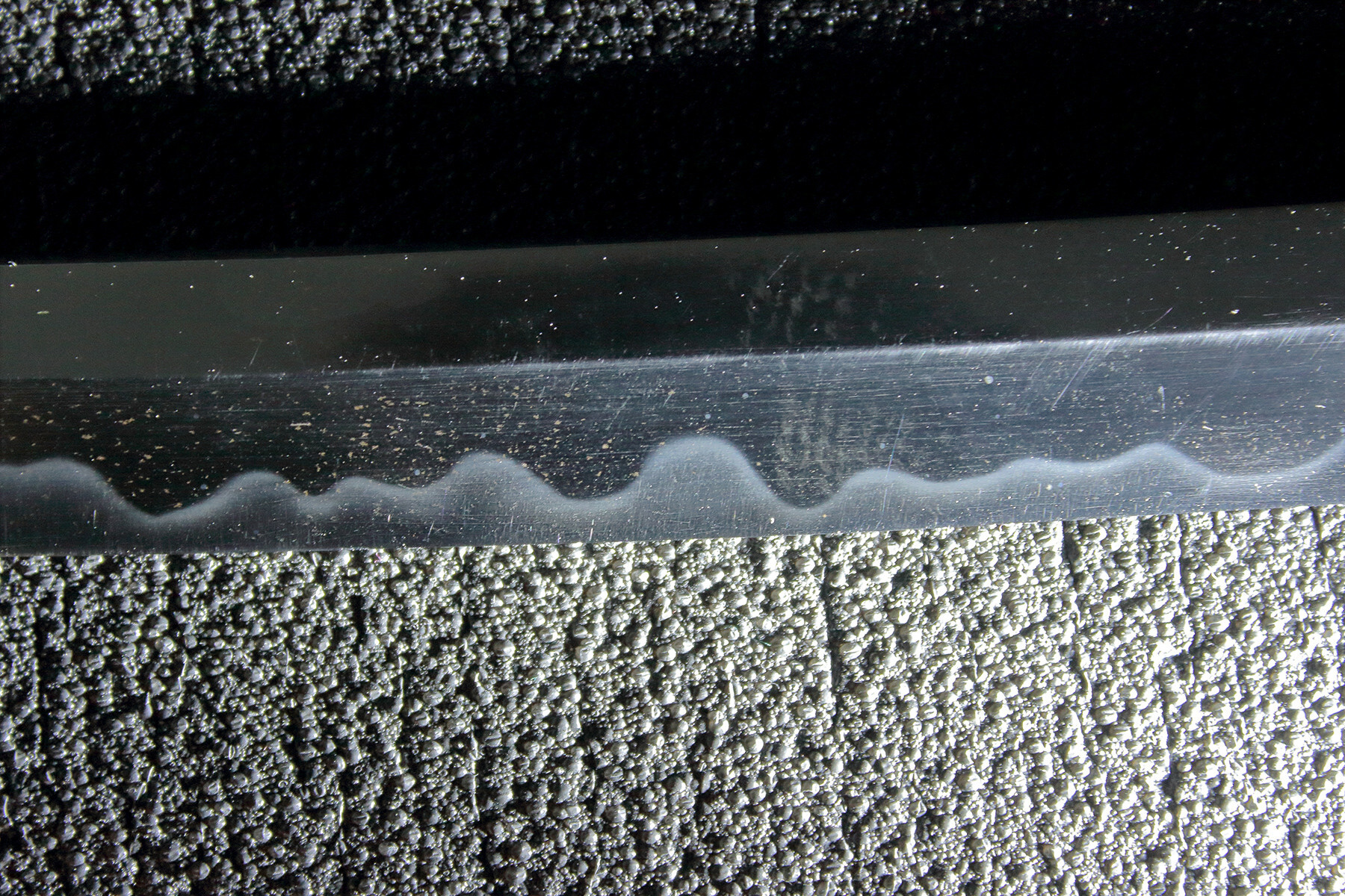

The hamon of this blade looks beautiful (at least for me). Its waves caught my eye from the starter. But I noticed that the hamon line is too close to the edge of the blade. At the extremes it is as close as 1.5mm according to my caliper. Now, as I understand, such a thing is typical for older blades that have seen a lot of polishing. That's when I started wondering if it could be an older blade in kai-gunto mounts or if it is just another war blade that was polished too frequently. Here is how the hamon looks on both sides of  nagasa . It was simpler to catch it on photos like this.

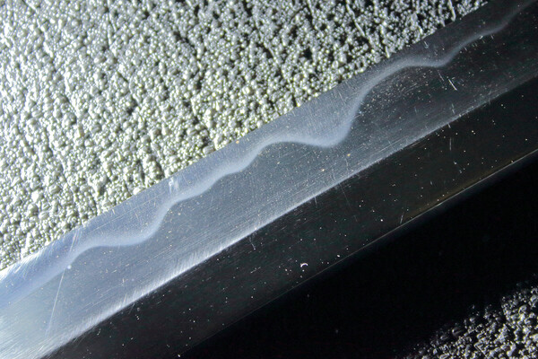

With this kind of buffing it's simply impossible to see if the nagasa has a grain. So I tried to figure out what type of hamon it is: water or oil quenched. If it is water quenched it will confirm the theory of  traditionally made blade. Before I went through a couple of topics here I did my best to catch the gleam of hamon by daylight. It worked on the least buffed space of hamon.
Thanks to the members of this very forum for tips on how to shoot photos of hamon using darkness and source of light. It is much better. Yet, with all that buffing made by some 'restorator' I am rather confused.  What do you guys think about this blade and its hamon?

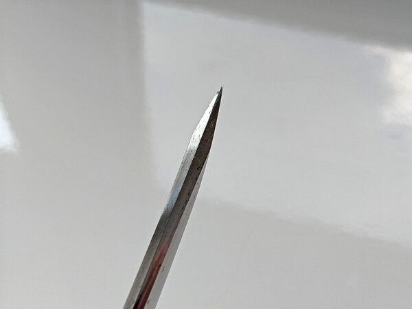

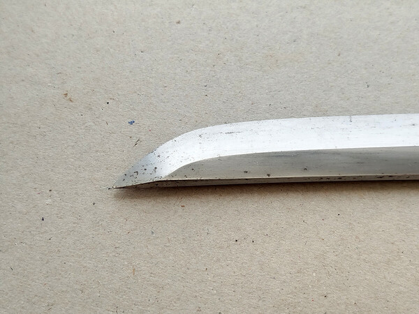

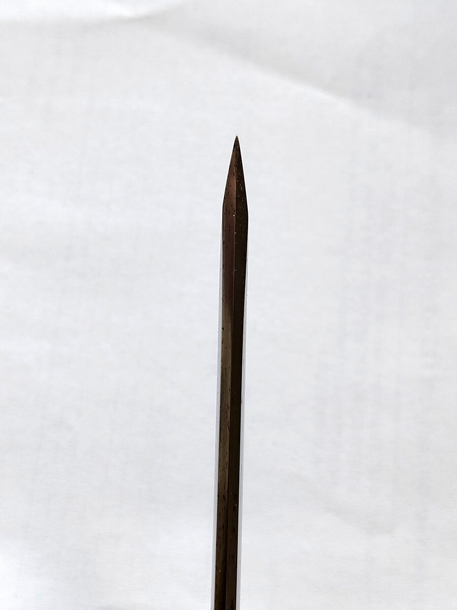

That thick kissai (tip) is very common for the wartime Showa blades. Also I don't see much jigane activity in the steel. I have a couple Showato blades in Shin-Gunto mounts that look similar. Looks to be a nicely-made WW2-era arsenal blade using western-type steel. Legit hamon, probably water-tempered rather than oil-quenched.

Thank you Bradley,
That's why I got confused. From one side the sword has typical features for war blades, from another, there is this hamon and  wear of the blade. And so much for my limited knowledge: somehow I got myself under the impression that a non traditionally made blade wouldn't have water quenched hamon.

Other evening I was oiling the blade and some evening sunshine was gettin through half closed roller blinds. And  I was  turning the blade this and that way and hamon was catching light. Sure, I couldn't help myself to shoot some photos.
