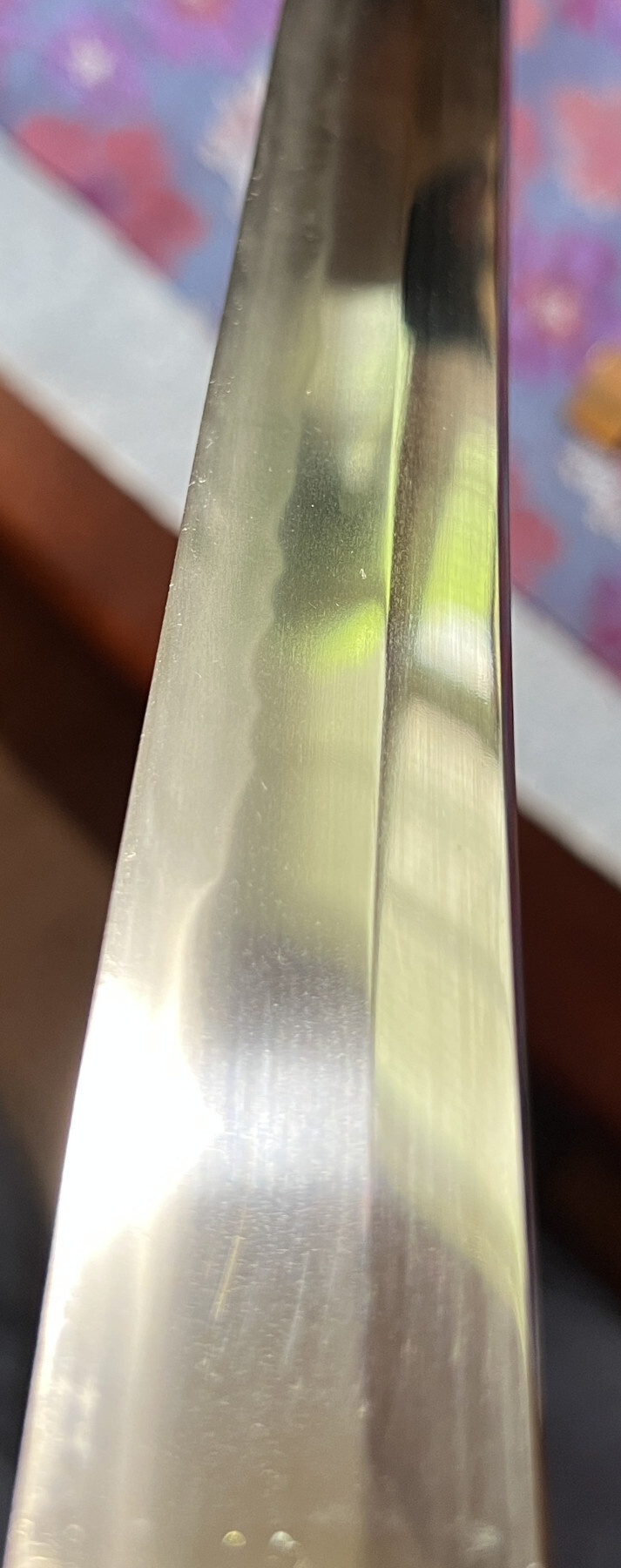

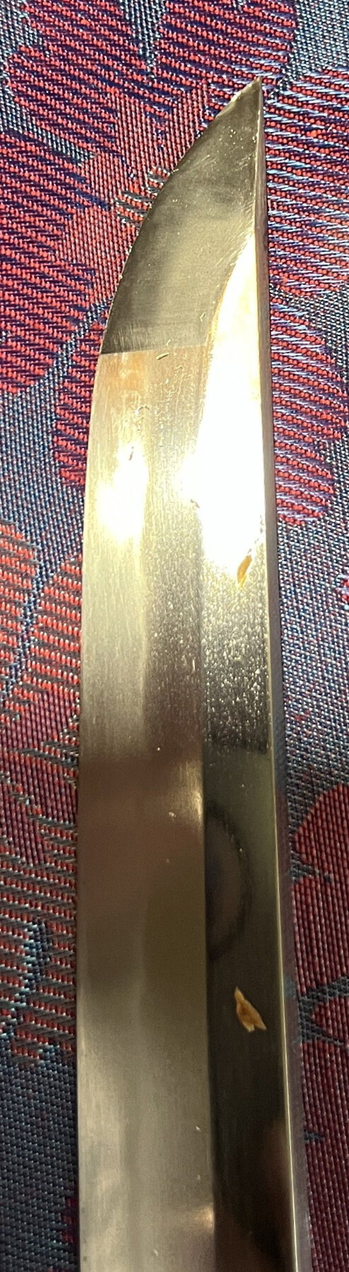

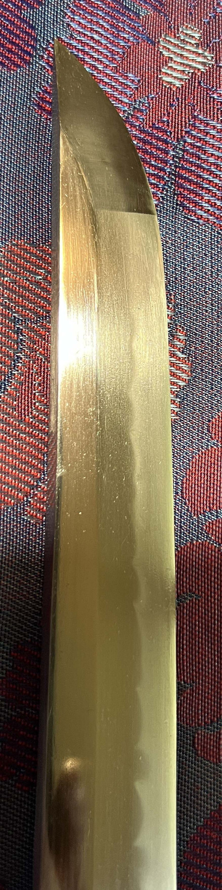

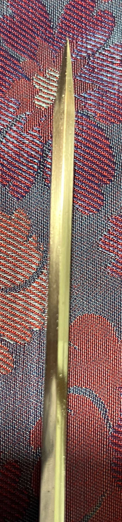

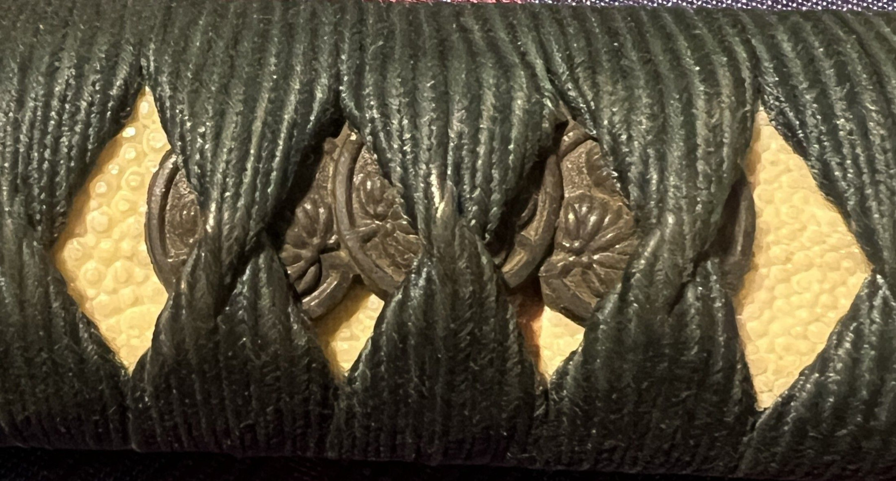

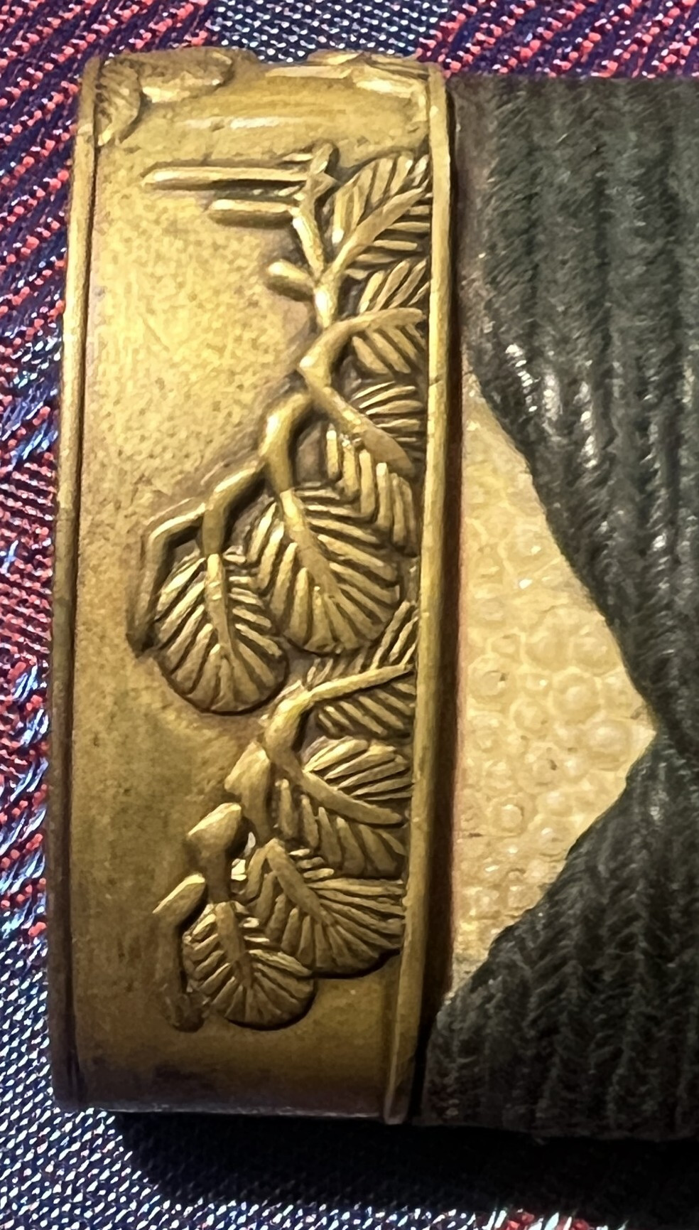

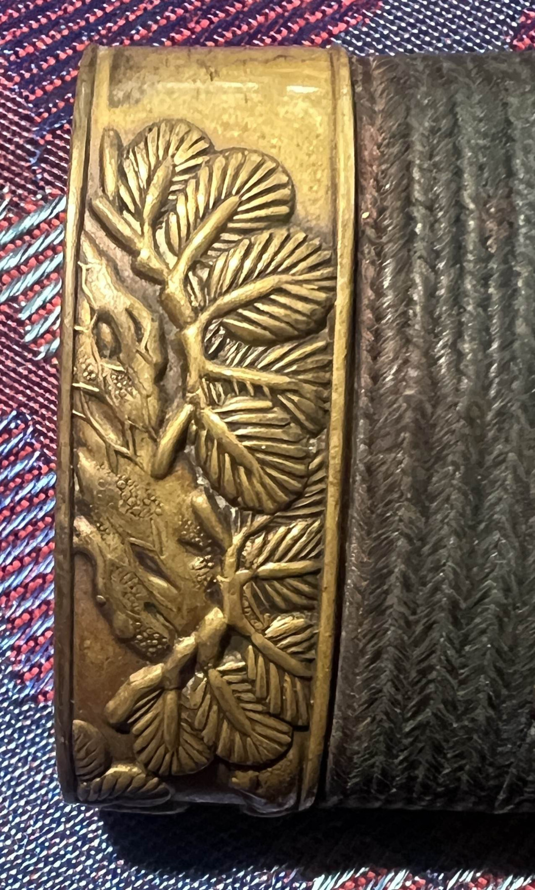

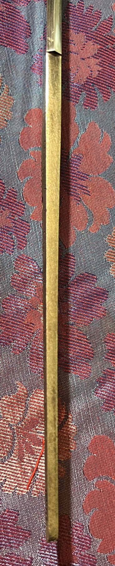

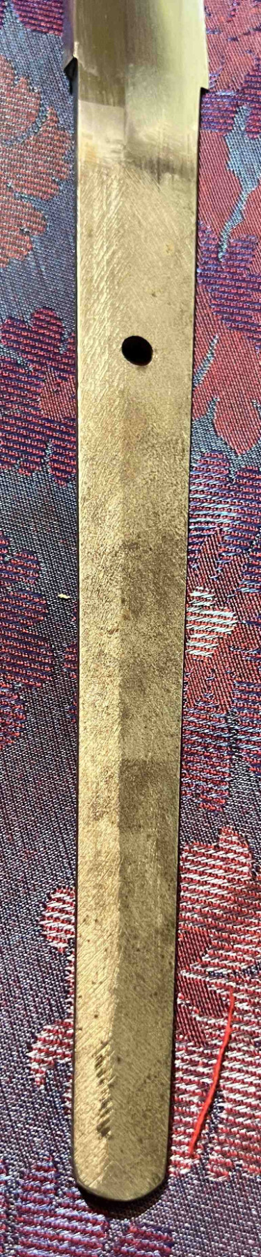

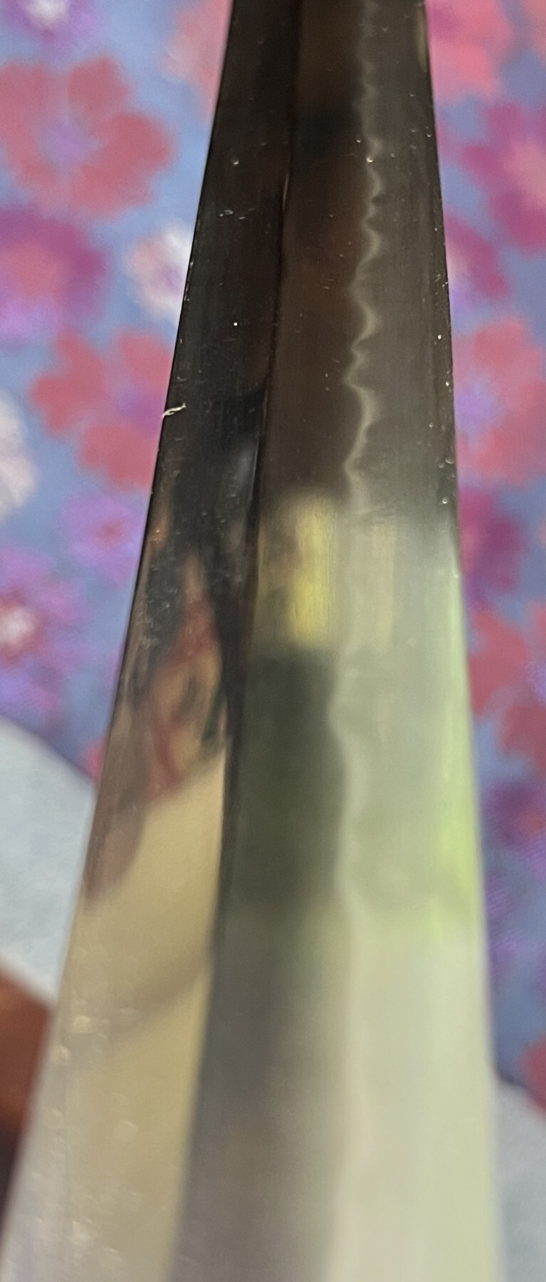

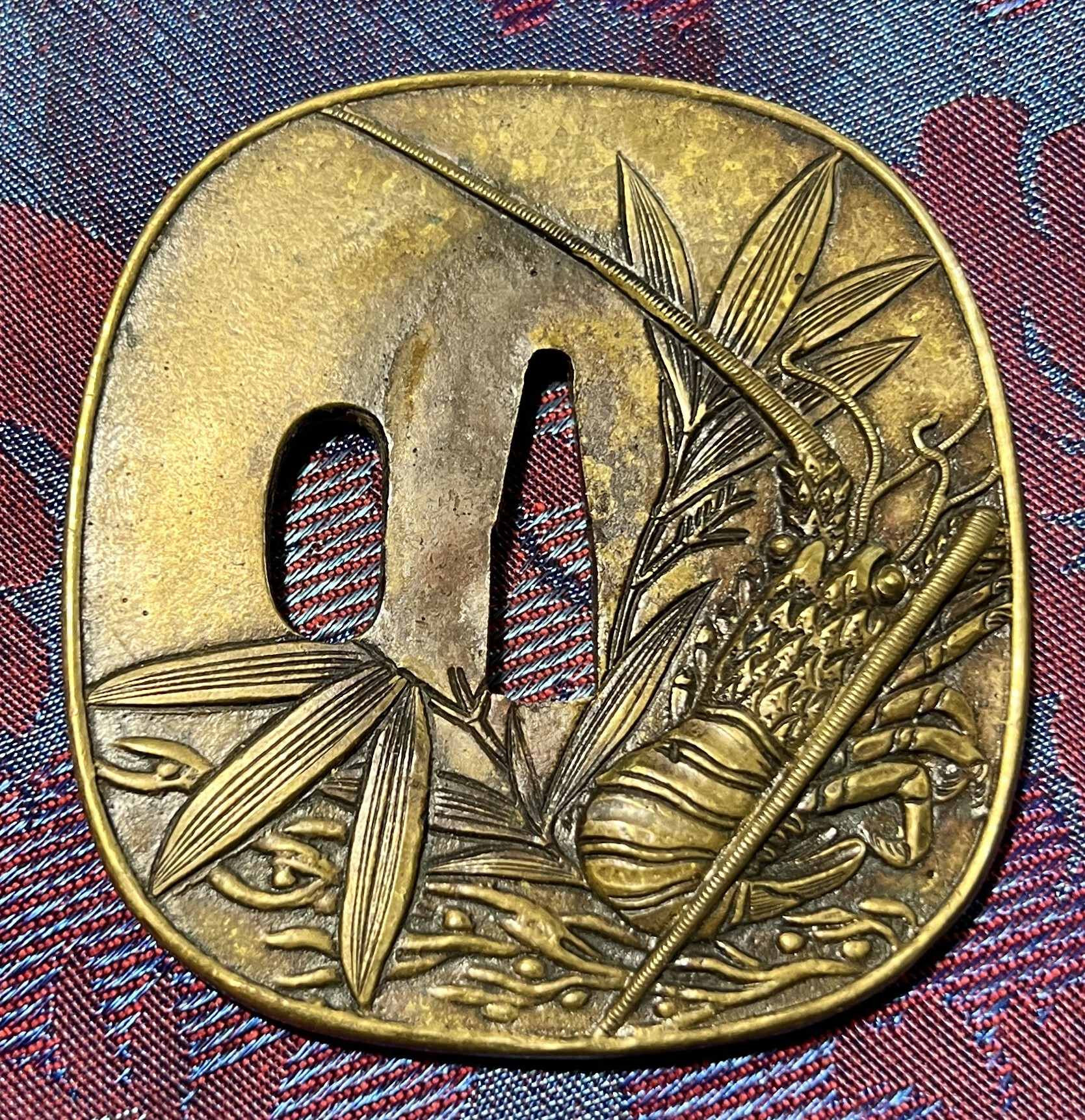

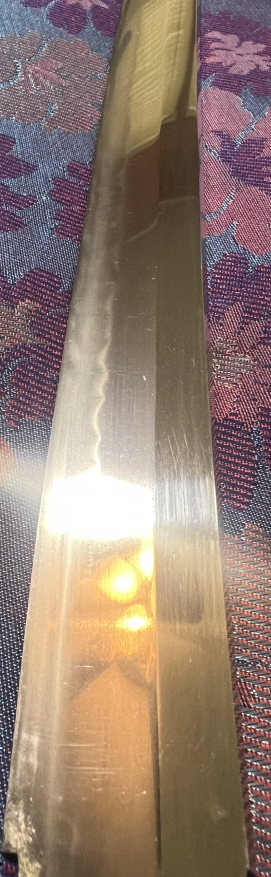

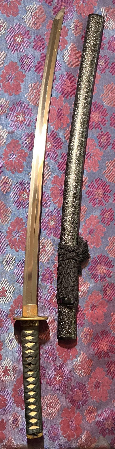

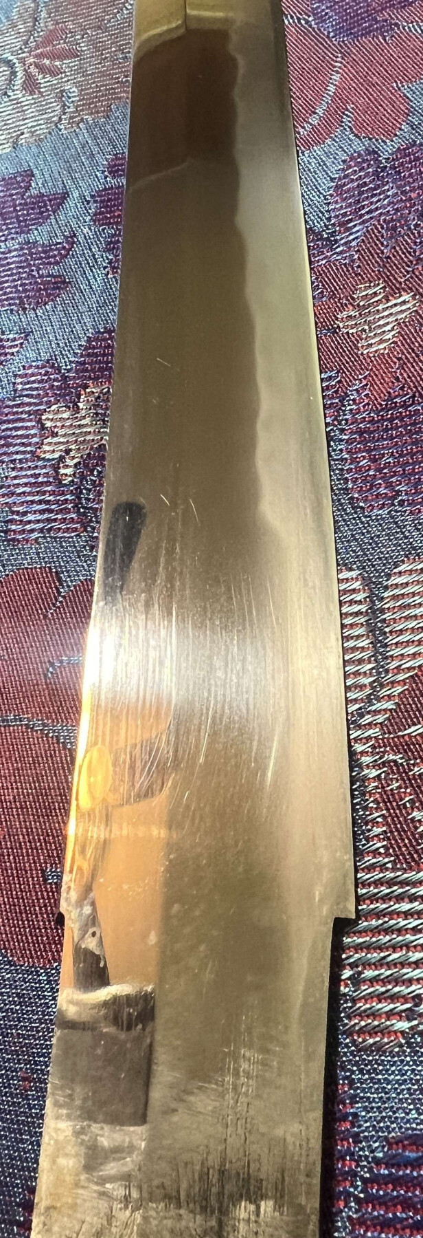

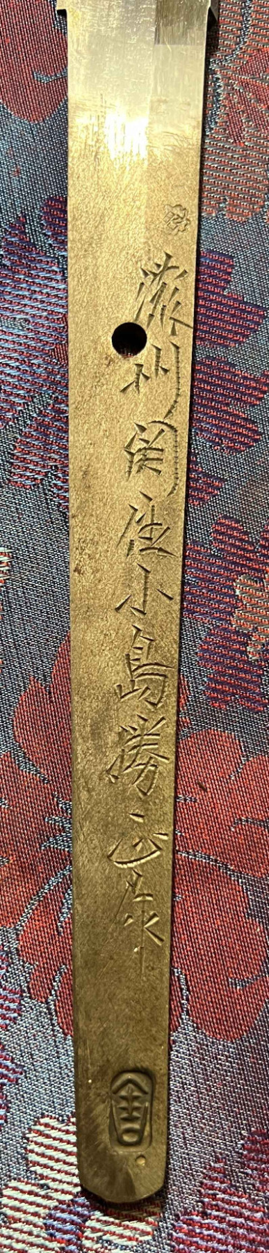

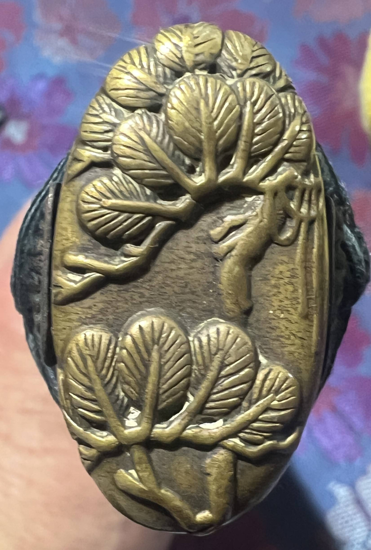

Listed as  FAMILY MOUNT 26 3/4 MASAYUKI
Go easy on me-

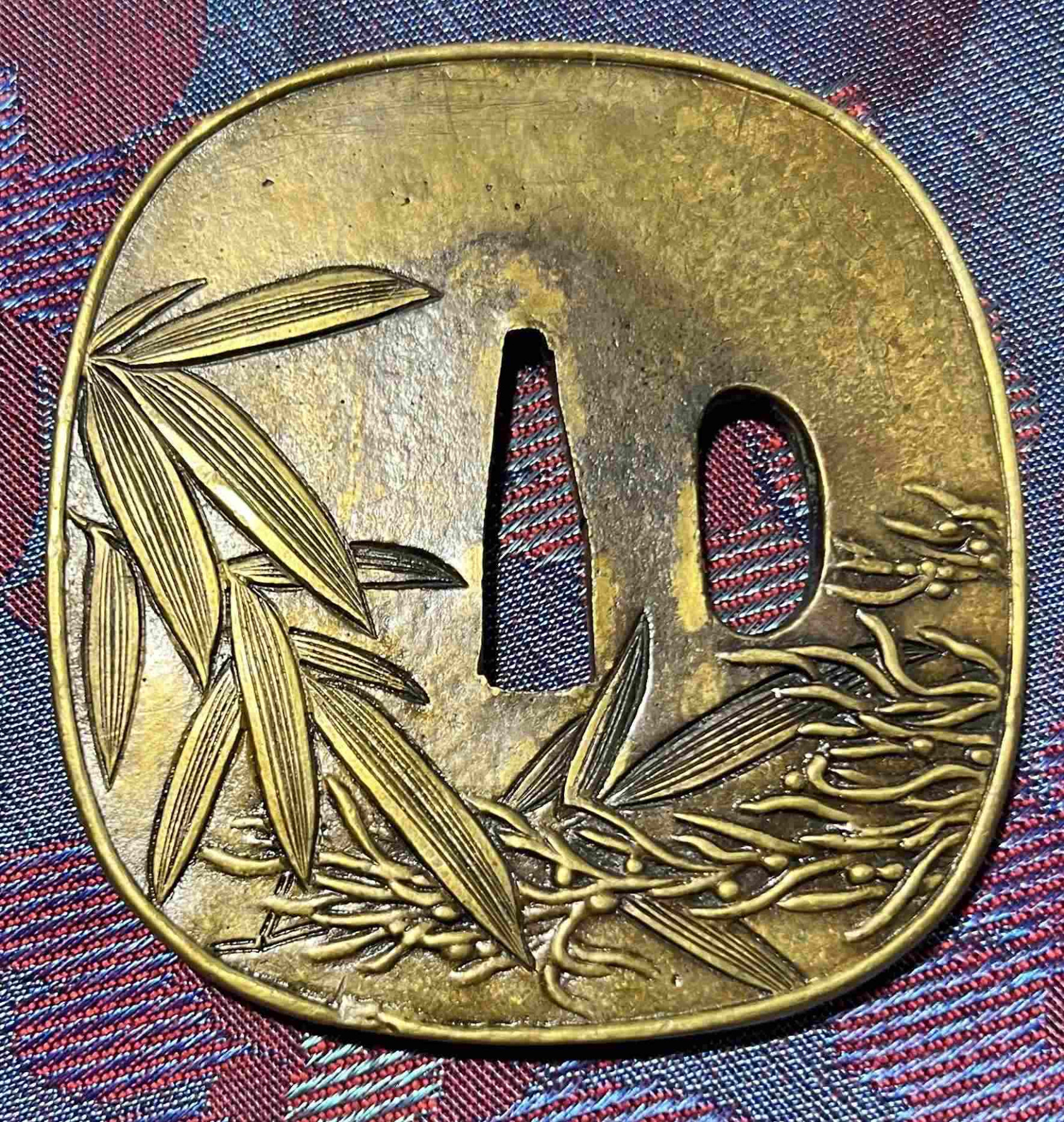

Kashira-Fuchi &Tsuba Are quite Detailed
Saya is confuses me since not military

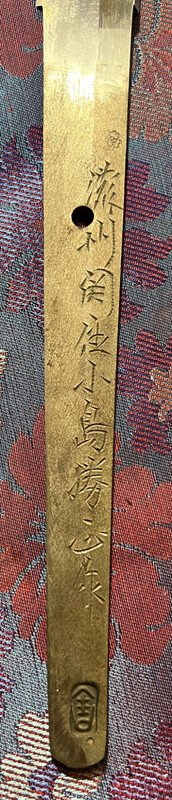

Blade has  nice Hamon

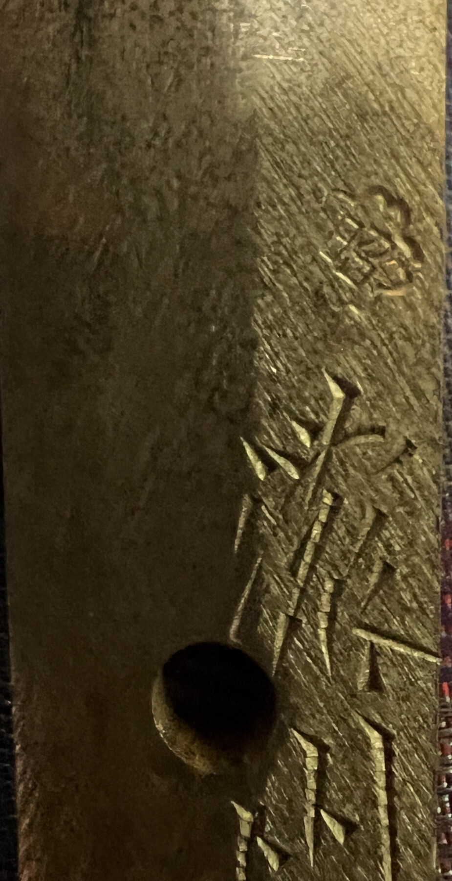

Nakago has clean Mei

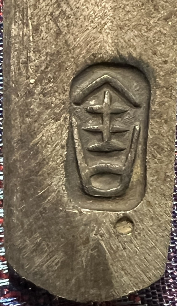

and a  Showa and Kojima Katsumasa stamp
 (page 34 from Bruce Pennington  Stamps of the Japanese Sword) :)
As always Translation and any information is appreciated
                          Enjoy-Thanks Steve

Great sword, Steve, is this yours or are you shopping?
I see you've been doing your homework! Ha!  You get an "A-", though.  The stamp is
"Logo of the Yasugi (Yasuki) Steel Co., headquartered in Yasugi City, Shimane prefecture. (Slough, pg 98)".
I have Kanemichi, Katsumasa, and Masafusa so far, with the logo.
Bruce-these are still from my father in laws collection
I thought that was the name of the stamp was above each picture  - i realize now that is the sword smith  :(
So please tell what the Mei translates
I hope everyone is amused by my lack knowledge-it adds a little excitement to the forum
Thanks all for the replies
Steve,  for details and examples of Kojima Katsumasa go to NMB Downloads (line at top on page)  and find paper " Kojima Tokijiro Kanemichi etc"    .
That is interesting example of a wartime civilian koshirae.
Boy, that sellers description threw me way off.  I thought this was a Masayuki blade, but it's not.  It is Katsumasa.  I've edited my post above.
The mei:
Noshu Seki ju Kojima Katsumasa saku 濃州関 住小島勝正作
