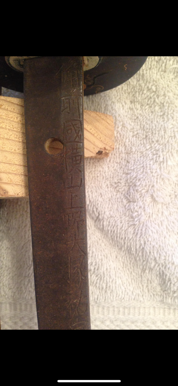

Kyle68 Posted March 31, 2025 Report Posted March 31, 2025 Hello everyone! Can someone translate? Quote
xiayang Posted April 1, 2025 Report Posted April 1, 2025 備前國横山上野大掾祐定 = Bizen no Kuni Yokoyama Kōzuke Daijō Sukesada 3 Quote
Kyle68 Posted April 1, 2025 Author Report Posted April 1, 2025 Thank you Xiyang! Any opinions from others about if it’s authentic or gimei? Quote
Geraint Posted April 1, 2025 Report Posted April 1, 2025 Dear Kyle. Obviously you will do your own research on this one and others will express opinions but at first glance this does not have the 'handwriting' of the school. As you look at examples you will note a particular style of cutting which is distinctive and I imagine hard to copy well. All the best. 1 Quote
Stephen Posted April 1, 2025 Report Posted April 1, 2025 43 minutes ago, Geraint said: As you look at examples you will note a particular style of cutting which is distinctive and I imagine hard to copy well Right he is, this is the first one I ran across but if you Google you'll see more examples that are even more precise. https://nihontoantiques.com/project/yokoyama-sukesada-sword-fss-760/ Quote
