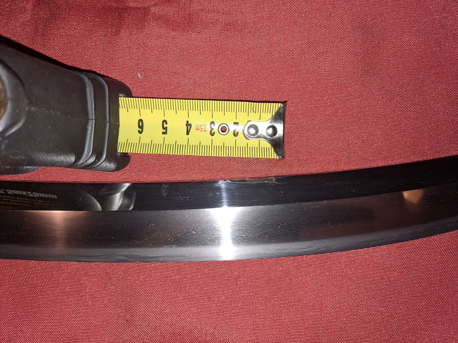

Scythian123 Posted January 1, 2025 Author Report Posted January 1, 2025 16 minutes ago, Gakusee said: Reasonably (and more than expected) common Are any serious flaws, such as a small chunk of the spine missing encountered? (The photos is not of a Japanese blade, it’s just an example of the flaw I was thinking of) Quote
Gakusee Posted January 1, 2025 Report Posted January 1, 2025 12 minutes ago, Scythian123 said: Are any serious flaws, such as a small chunk of the spine missing encountered? (The photos is not of a Japanese blade, it’s just an example of the flaw I was thinking of) Have not seen anything as bad unless battle damaged most common are kitaeware such as in the various JuBi+ Masamune below. Quote
Jussi Ekholm Posted January 3, 2025 Report Posted January 3, 2025 Here is a chunk of a spine missing from Nanbokuchō period naginata that has been attributed to Ko-Uda. It is about 2 cm piece missing. I know for many flaw like this would be unacceptable but it doesn't really bother me. I will rather have flawed item like this that I like in my collection than a pristine item that does not interest me. 4 Quote

Matsunoki Posted January 4, 2025 Report Posted January 4, 2025 19 hours ago, Jussi Ekholm said: flaw like this Jussi…..you sure that is a flaw and not some type of impact damage? Is it possible that a glancing blow from something either heavy or sharp or both could have caused it? Or rather than being hit, could it have hit something?….a stone wall corner, a boulder/rock…? Just doesn’t look like a forging problem, one end is very angular and appears to have shock cracks coming off it. Don’t know….can you get better sharper image? 1 Quote
Jussi Ekholm Posted January 4, 2025 Report Posted January 4, 2025 I think it might have been bit of a language barrier. I posted the missing spine chunk as a reference for the post by Ali D. where a chunk of spine is missing from European sabre? or other type of sword. Showing that you can find similar in Japanese swords. I don't think the flaw on the naginata I posted is related to forging. However I translated flaw in my head just meaning a flaw/problem etc. in general. I cannot say how the damage was inflicted but I think impact damage could be a plausible explanation. The naginata is in rough overall condition but I got what I considered to be amazing deal from the dealer. People in general just don't want naginata and I would think missing chunk of blade made people avoid the item. 1 Quote

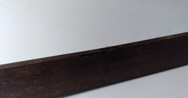

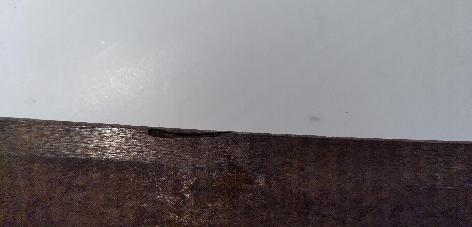

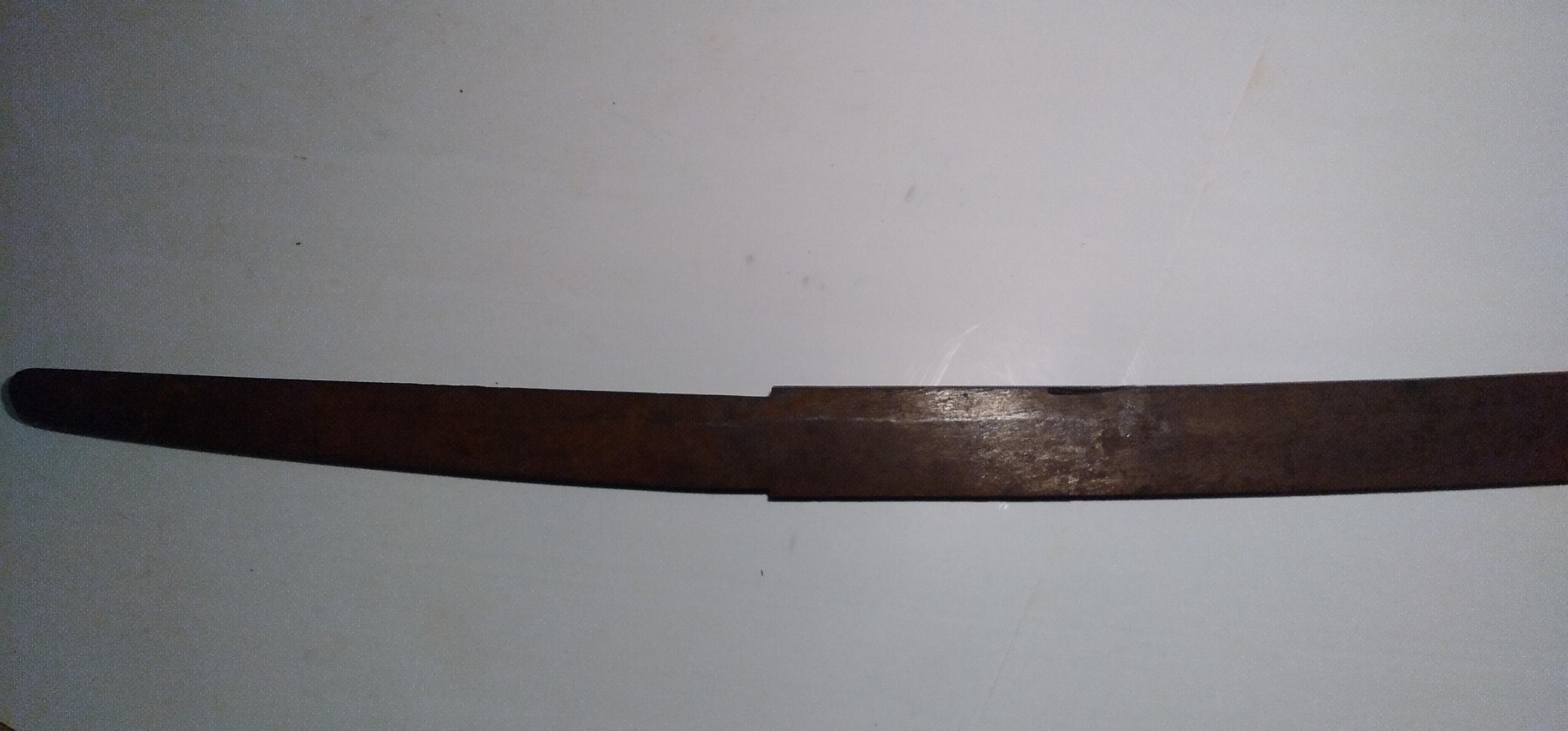

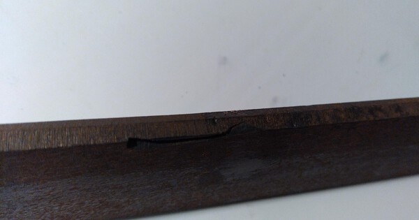

Khy Posted January 5, 2025 Report Posted January 5, 2025 Bit of a disclaimer, I'm quite new with limited experience and knowledge (normally just lurk and try to learn), however, I thought this might be of interest considering the topic. I'm an amateur smith and had a chance to acquire what appeared to be some unfinished blades. I thought it would be great to see and study some original pieces prior to polish, as I've never been able to see anything much "rough from the anvil". They were listed as pre Showa, (again... grain of salt here) and one in particular did appear to get the first stages of file/polish, but a flaw may have indeed halted the finishing? 1 Quote

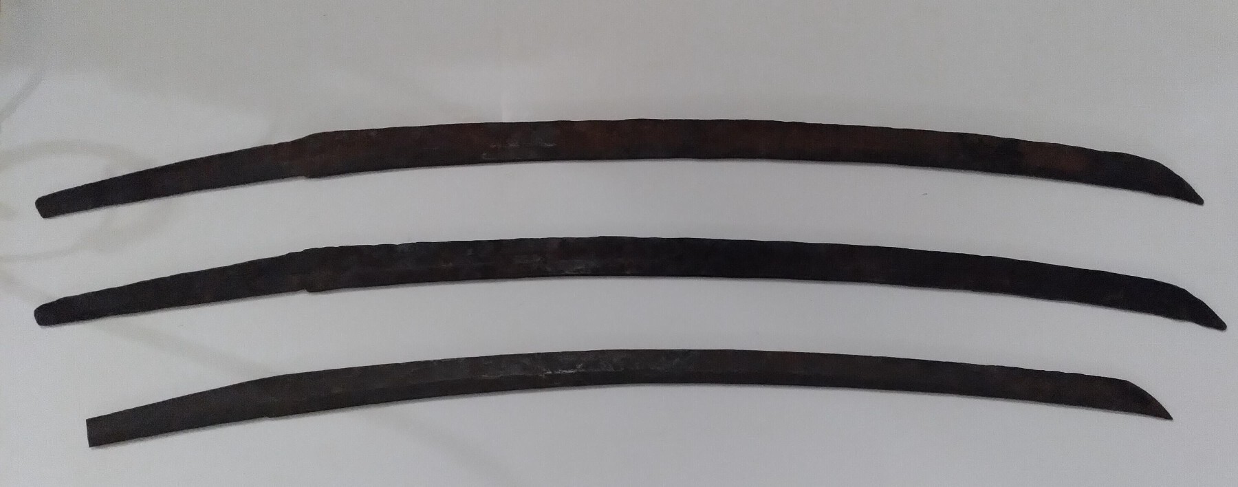

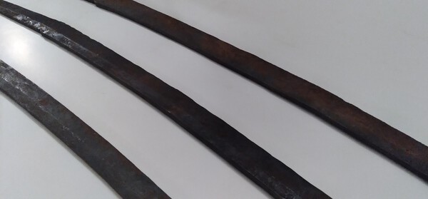

Khy Posted January 5, 2025 Report Posted January 5, 2025 The other 3 with no signs of even file work, if of interest. I have not had enough time to really give them a good study, so I'm unsure of what would have had them left as is. Quote
