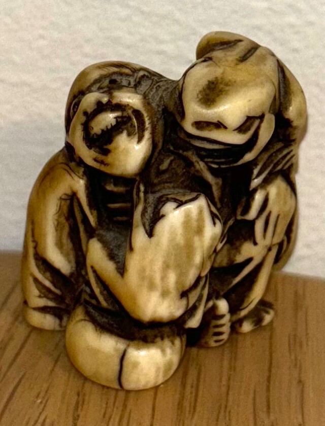

Svillpa Posted September 12, 2024 Report Posted September 12, 2024 This right here is my Netsuke that I got as a present from my grandmother. My grandma told me that this has been her mothers for as long as she can remember and she believe that her mother bought it when visiting london as she used to do alot during her lifetime. So we believe it to be bought around 80 something years ago and I was just coming here to get a second opinion on it. What's everyones thoughts on it? It depicts a man sitting down with two frogs climbing his body. One sitting on his knee hugging his stomach and one on his left shoulder. Quote
Bugyotsuji Posted September 12, 2024 Report Posted September 12, 2024 Gama Sen-nin was a Chinese sage usually shown with a frog/toad. These frogs often have only three legs. 1 Quote
Matsunoki Posted September 12, 2024 Report Posted September 12, 2024 The pics are a bit distant but the figure is most likely Gama Sennin, an immortal often portrayed with toads. You can Google that name and learn all about him. Often the toads have 3 legs! It is of a modest quality but that doesn’t really matter as it is a gift from your Gran. Probably dating from late 19th/early20thC edit…Piers was quicker! 1 1 Quote
Svillpa Posted September 12, 2024 Author Report Posted September 12, 2024 Thank you for the info! The frogs have 4 legs on this one, and I noticed aswell that it isn't of the greatest quality but I was not planning on selling it anyway! I am happy to own a antique item as it is, and I am also a bit of a frog enthusiast so I am in love with this piece. It holds sentimental value. Just been curious what it depicts and I got my answer, so thank you both 2 Quote
Bugyotsuji Posted September 12, 2024 Report Posted September 12, 2024 That all sounds healthy, William. This kind of rather crude craft carving is sometimes described as 民芸 Mingei (pronounced min-gay), but many were genuine honest hard-working Netsuke in their own right. Yours is heavily stained, so it is difficult to decide exactly what type of material it is from those distant shots. PS You could crop out 75% of the featureless foreground and background. Quote

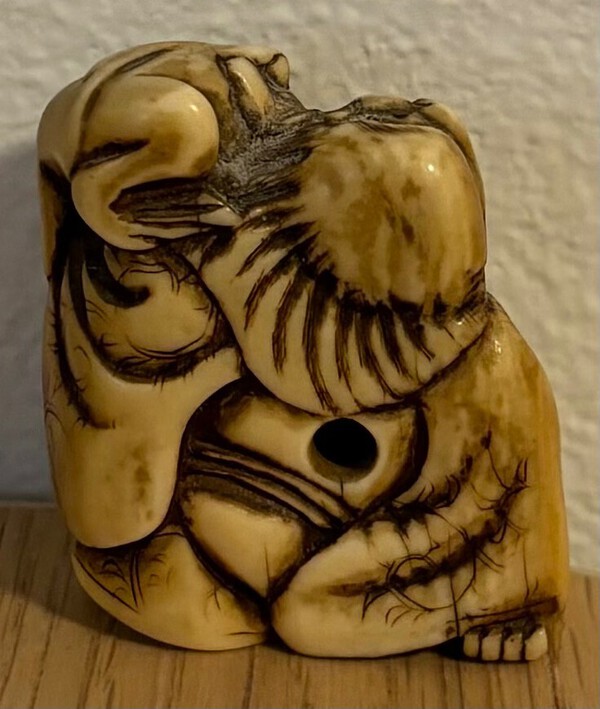

ROKUJURO Posted September 12, 2024 Report Posted September 12, 2024 I would like to see the base of the NETSUKE in magnification, photo taken with dark background, plus the HIMOTOSHI. Quote

Bugyotsuji Posted September 13, 2024 Report Posted September 13, 2024 Himo means ‘string’ or ‘cord’, tōshi means ‘passing’, so the string passages. Their type, size, shape and placement can tell you several things. You don’t need a microscope, just a closer shot of the underneath! Quote
Svillpa Posted September 13, 2024 Author Report Posted September 13, 2024 6 hours ago, Bugyotsuji said: Himo means ‘string’ or ‘cord’, tōshi means ‘passing’, so the string passages. Their type, size, shape and placement can tell you several things. You don’t need a microscope, just a closer shot of the underneath! Ok here are some closeups at least. Same pictures but with cutout background. Also added a picture of the underside. The Himotoshi are approximately the same size. I’ve seen others where one of the holes are larger than the other? What does that indicate? Quote
John C Posted September 15, 2024 Report Posted September 15, 2024 On 9/13/2024 at 3:48 PM, Svillpa said: I’ve seen others where one of the holes are larger than the other? What does that indicate? William: Here is at least one explanation: "The reason for the larger hole in the netsuke was that once the cord had been threaded through the inro (or Sagemono) and ojime (the netsuke would then have been threaded on last) it was possible to completely hide the one and only cord knot inside the larger hole." https://www.jncohen....Netsuke/Cordhole.htm John C. Quote
Matsunoki Posted September 15, 2024 Report Posted September 15, 2024 18thC netsuke tend to have one larger hole but later ones usually have holes of roughly the same size. To properly carve a large hole requires more time and effort…it isn’t simply a drilled hole as many later examples are. It was internally hollowed out to accommodate the cord knot. Also, I’m 99% certain yours is elephant Ivory and the shape suggests it utilises an offcut for a larger ivory carving as was very common when tusks were roughly shaped before detailed carving of a large okimono commenced. . Quote
ROKUJURO Posted September 15, 2024 Report Posted September 15, 2024 To my untrained eyes, it looks as if the big toe of the left foot is broken off (last photo). Can you please check that? Quote
Svillpa Posted September 20, 2024 Author Report Posted September 20, 2024 On 9/15/2024 at 8:58 PM, Matsunoki said: 18thC netsuke tend to have one larger hole but later ones usually have holes of roughly the same size. To properly carve a large hole requires more time and effort…it isn’t simply a drilled hole as many later examples are. It was internally hollowed out to accommodate the cord knot. Also, I’m 99% certain yours is elephant Ivory and the shape suggests it utilises an offcut for a larger ivory carving as was very common when tusks were roughly shaped before detailed carving of a large okimono commenced. . Thank you for the input! When my grandmother gave me the gift she told me about it being elephant ivory but I couldn't take her word for it and wanted a few more eyes to look at it. I am pleased to hear that! Thank you Quote
Svillpa Posted September 20, 2024 Author Report Posted September 20, 2024 On 9/15/2024 at 9:21 PM, ROKUJURO said: To my untrained eyes, it looks as if the big toe of the left foot is broken off (last photo). Can you please check that? That is the case yes. The surface where the toe is missing is very smooth to the touch still so I am not sure if it was a mistake when making the netsuke or if it has been broken off later on and the material itself has smoothen over the years. 1 Quote
ROKUJURO Posted September 20, 2024 Report Posted September 20, 2024 In case the toe broke off in the making, the NETSUKE would never have been finished and left the workshop. So it was very probably an accidental thing. 1 1 Quote
