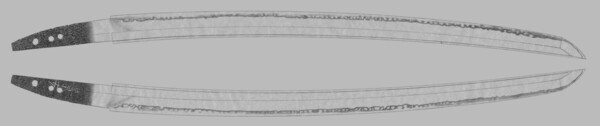

Here's an oshigata of the sword.
1 shaku, 6 sun, 6 bu, 5 rin, so same length as my sword.
The shape of this oshigata sword has significant differences to my eye. So, while lengths may be similar, time frames of manufacture are not.
One reason lengths may be similar is that later swords were attempting to copy earlier examples.
If i'm not wrong the number of mekugi ana doesn't match ...
These are two different swords. That one is a Ko-Bizen Kageyasu I was using to state that kodachi did have a 1 shaku, 6 sun size during the Kamakura period.

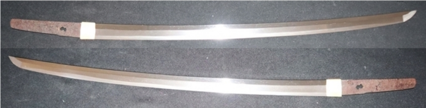

There are several things that bother me: the sugata doesn't match the era, the kissaki is too long, the mei is oddly placed and the characters are too large. Where was this sword purchased? In Japan?

I can't tell from the meï, but the place seems wrong on the nakago (I can be myself wrong) it is under the mekugi ana and not enough on the mune side...
Bought in Hiroshima, Japan.

I'm personally in the belief after working with this board and another board that the sword might be from the Bizen Norimunes of the Oei to Bunmei eras.
….however, did he not sign with an Osafune mei..rather than the nijimei evident here…..
->Norimine (則宗), Ōei (応永, 1394-1428), Bizen – “Bizen no Kuni Osafune-jū Norimune” (備前国長船住則宗) signature
Listen, nothing wrong with having a nice gimei blade that you can live with. Especially if a gift from your father. Mine, as much as I loved him and vice versa, would never have made me such a present and in fact was against “weapons” and such “fads” and collectible “varieties” - perhaps due to his very modest character and humble upbringing.
Fair point. However, the Bunmei Norimune signed both with an Osafune mei and a nijimei signature. It may very well be gimei, but until shinsa confirms, I'm just trying to learn more where I can. That way I can better understand and appreciate the gift my father gave me.
Nope.
What puts away, however, the Bunmei Period? That falls within the late Muromachi period (1469), with a Norimune that had a nijimei signature, and the Bizen features of the blade?
Then, please provide examples of the nijimei Muromachi Norimune and we can explore.
However, the hamon and other features of the kodachi do not point in that direction.
The file on the Nihontoclub website features a Norimune during the Bunmei period with both an Osafune signature and a nijimei signature which was recorded on page 753 of the Nihonto Meikan.
