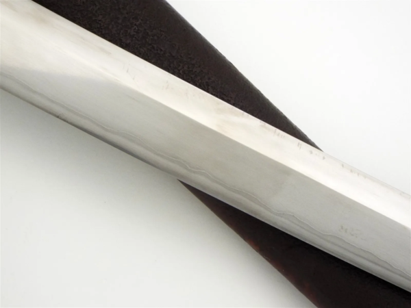

This is being sold with that title "Interesting Japanese WWII Officers Katana Sword With Hand Made Pattern Welded Blade"  Anytime you see the word "pattern" in the description, it is a red-flag.  Also, what the heck is a "welded blade?"

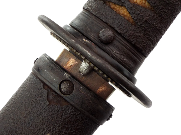

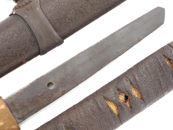

Sadly, this comes in a set of custom Rinje seishiki fittings with double release buttons that would normally house a nice gendaito RJT blade.  It looks like that blade was removed an a mumei substitute showato was added.  The dust cover seppa is missing, hence the gap in the fit.  Strangely, the latch is too short to even reach the saya throat.
