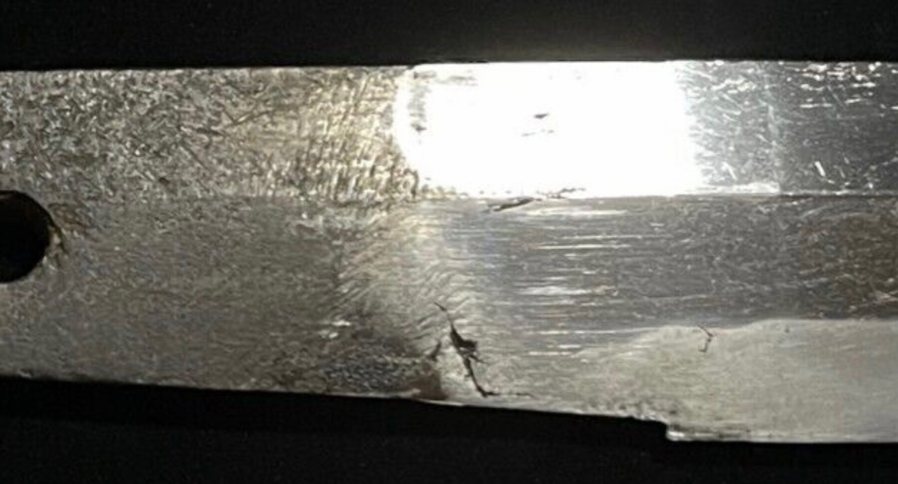

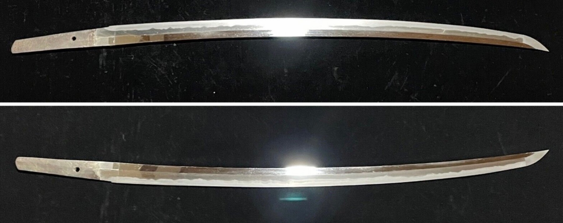

Just been looking at some cheaply auction blades and came across this really interesting kizu, but I’m not sure what it actually is  apart something that looks really nasty.
Looks like it's simply an open side to a fukure (or just a kitae-ware). It's not that uncommon to see flaws around the area of the habaki-moto where the blade transitions to the steel of the nakago.
