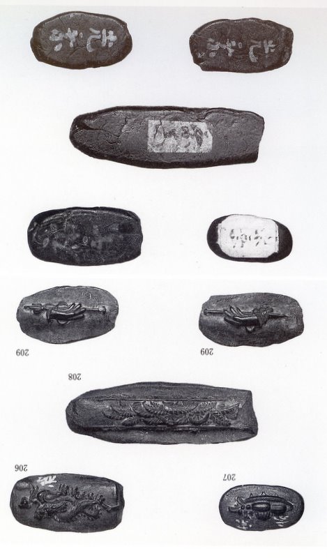

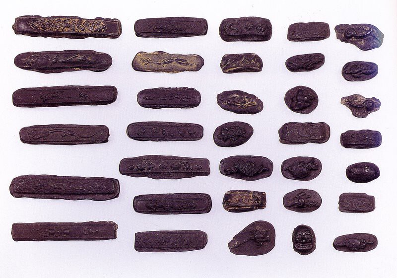

Ford Hallam Posted June 11, 2009 Report Posted June 11, 2009 Hi Ian, with reference to the Goto actually casting gold menuki I would add the following. I've seen those casts taken from apparent moulds. The first time I saw them I immediately realise what they were and their purpose. The moulds are in fact simply imprints taken from the original uchidashi made menuki, either in clay or some similar plastic material. The copies are then created by pouring warm matsuyani into the mould. Matsuyani ( pine rosin) is the stuff we use to hold the work when being carved and inlaid etc. Once it begins to cool you can further work it into the mould with your thumb. I think that it was a misunderstanding of these reference models in pine rosin that has led to this erroneous idea that some Goto menuki were cast. There are a number of practical reasons why this would be unlikely. The most problematic being getting molten gold to adequately fill a mould that necessarily only had an inner cavity with a thickness of less than 1.5 mm. It's tricky even with centrifugal casting. Vacuum ( very modern process ie post war) casting on the other hand does the job beautifully. Therein lies a little concern. If I had in my possession a genuine pair of gold Goto menuki I can, by utilising the technology I was trained in, create copies that would be virtually indistinguishable from the originals. Here's a picture of the moulds you mention...they still make me smile at the misunderstanding. You can see the traces of clay on the rosin. If this was a way of creating waxes to cast you'd still have to hollow out the back as they are solid. Also, it would probably not be any quicker to make them by casting by the time you factor in all the additional clean up etc. Quote
