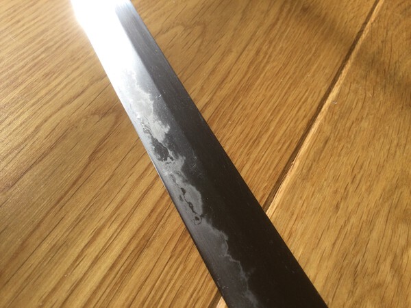

Hi Guys,
Three questions please.
1. What is this and how was it caused?
2. Is this considered a flaw? If so how serious?
3. It’s also in an awful acid etch. Any way of reducing the impact of an acid etch without repolishing?
regards
Gwyn
Hamon is intact, so not a serious flaw. Maybe just a lack of control over the clay coating?
I know many advise against uchiko, but in this case repeated and careful uchiko application may dial back that acid finish. Otherwise maybe Nev-R-Dull?
Hi Gwyn, the deep perpendicular scratches makes it look like someone was cutting with the sword, damaged it and then tried to remove the scratches with a finger stone or something else that burnished/disfigured some areas of the hamon?
I am sorry, on  one  hand  an acid accident on the  other hand sluggish  yakiire. Part  of the  claycoating has fallen of.
Is this a fatal flaw, no it is not.
Is there a way to repair the acid desaster without  a new polish, sorry again the answer is no.
