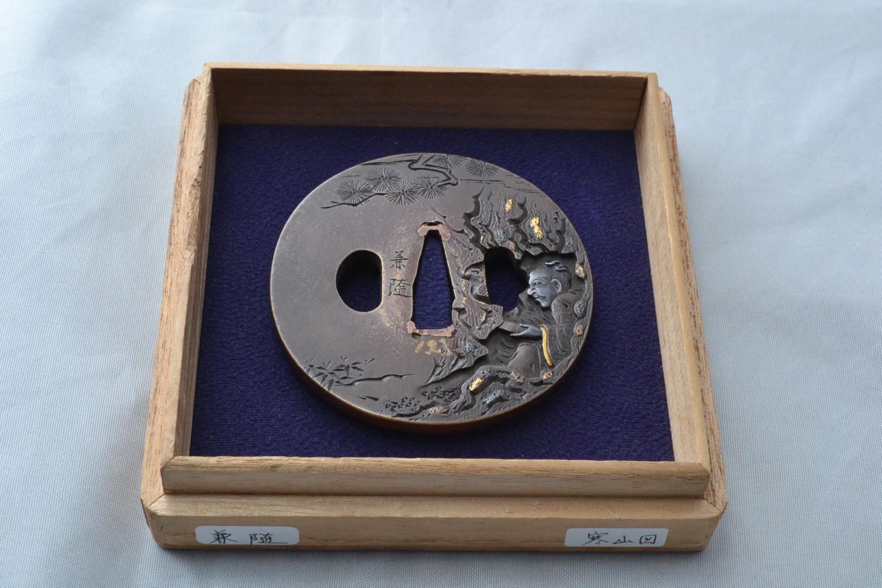

I stumbled upon this tsuba on ebay today: https://www.ebay.com/itm/Sale-Tsuba-Japanese-Samurai-sword-Katana-Koshirae-guard-Kanzan-figure-Antique/264213053098 and I was wondering if I could get any info from about it. It's quite expensive for a non nbthk authenticated tsuba but I just absolutely love the design and aesthetics on it. Specifically, I was wondering:
-It seems the figure is Kanzan. Where is Jittoku and why is he alone? what's with the firey background?

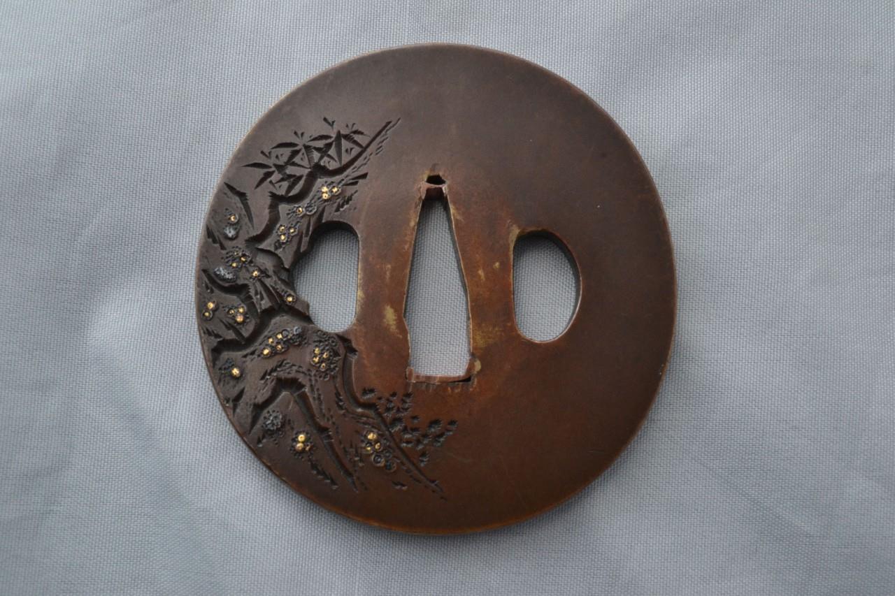

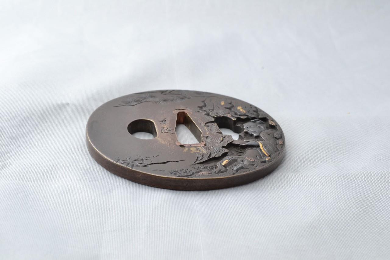

-Of course, do you think it's real? seems to be from the Kaneyuki (Hamano school). The front looks textured and gritty while the back is super smooth, could that be a tell it's fake? are tsubas usually like this?
It is not a fake, it is Hamano school.  The surface is the result of a badly damaged patina,  it is in need of professional help.  If the patina were properly restored it would be much more attractive.
-S-
The two are not necessarily always shown together, and the "fire" in the background looks to me like the trunk of a (partially) hollow tree.
Oh I see it now, Yea he def looks like he's reading a poem in a tree hollow.
