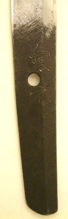

i have this little wak, slender, with a suguha. the limited resources i have does not have anything that match the strokes on this signature. can anyone peg this one?
thanks.
eric
hi grey,

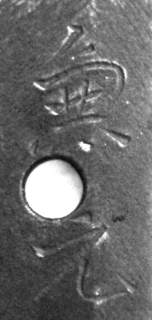

yes it is kanemoto. my question is, when i tried to match it with other signatures, the lower strokes of my "moto" does not look like the lower strokes of other "moto". the typical ones have a sharper bend at the lower right stroke. so this not one of hte big guys, but does this match up with anyone in particular?
eric
Guess you knew that. The closest match in Fujishiro's Koto-hen is listed as Kanemoto, Kodai. Kodai means unknown later generation, I believe. The nakago definitely looks Seki, but later than Sue-Koto.
Hope this helps. Grey

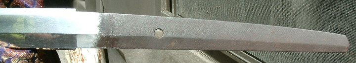

yes, the file mark is typical mino shinto or later. the clarity of the mei cut also suggest a nto particularly old blade.
eric
The point is that even later generation of Mino Kanemoto put sanbonsugi hamon, and you mentioned suguha, so this is something you have to check. Mike

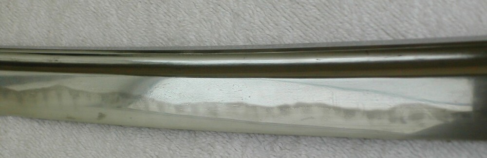

I had an O-suriage katana, very slender ( but in proportion ) , suguha hamon with one TINY " bump " in the hamon near the hamachi area............
shinsa by NTHK to sue-koto MINO !!!!

milt, i have a sugu katana that nthk put to late generation tadayoshi den. however, i almost think i detect a very mild bump on the sugu as well. and the yasuri is kesho, not typical hizen. but i kind of like the tadayoshi den attribution......
