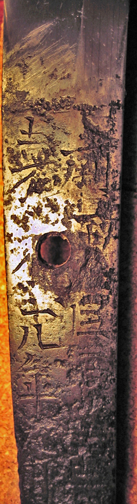

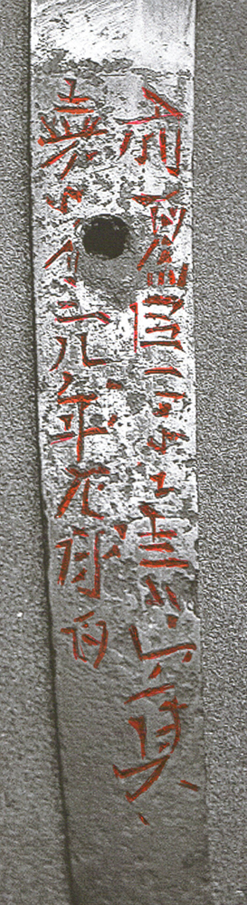

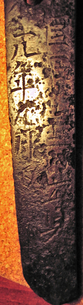

drbvac Posted March 25, 2008 Report Posted March 25, 2008 I believe this is masa?? ? The nakago is pretty rusty and the inscription on the other side is the date I think BUT if I could read this I wouldnt have it here!! Quote

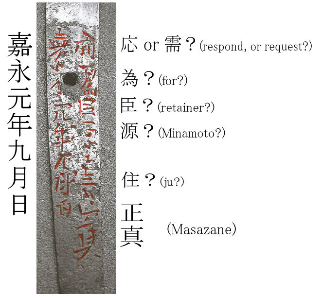

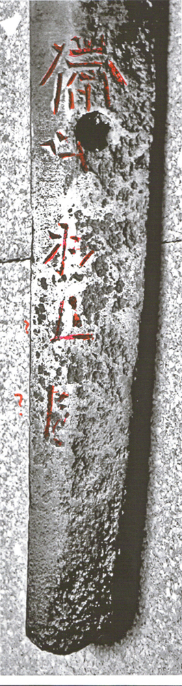

Nobody Posted March 26, 2008 Report Posted March 26, 2008 The upper pic: I guess the first five kanji as follows; 備中松山住(or 藩?) Bitchu Matsuyama ju (or Han?) The lower pic: 前田xxxx 正真– Maeda.....Masazane 嘉永元年九月日– Kaei Gan nen Ku gatsu hi = 9th month of 1848 Quote
drbvac Posted March 26, 2008 Author Report Posted March 26, 2008 Matsuyama in Hawley is Mizuta group from 16th century, so I hope the school continued into the shinshinto period and /or at least someone did!!:? As a point of interest, Okayama Bitchu-Matsuyama-Jo (Takahashi) is the highest castle in Japan< Quote

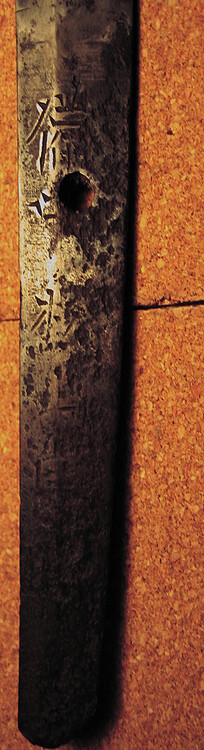

drbvac Posted April 1, 2008 Author Report Posted April 1, 2008 I found that if the last three Kanji are Bitchu Matsuyama han - this is the name of the Japanese domain in Bitchu during the edo period. I suppose this could be simply the area where it was made. So the smiths name is next to the date on the other side of the nakago? Quote
drbvac Posted April 1, 2008 Author Report Posted April 1, 2008 This is the other side of the nakago which I believe states the blade was made in the bitchu - matsuyama -han Quote

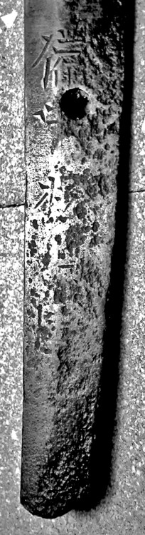

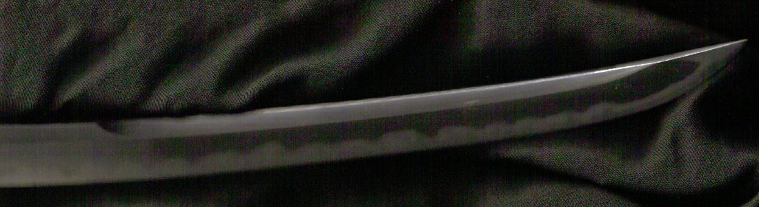

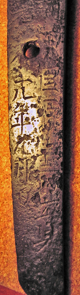

drbvac Posted April 12, 2008 Author Report Posted April 12, 2008 I have tried by looking at the nakago and the pics to highlight what I think the chisel marks are! The writing beside the date may be a who the blade was made for? the smiths signature is a mystery - and I am assuming it is on the side opposite the date and owners. The blade is slender ubi-no-kubi-dzukuri, long turn back of the hamon on boshi and gunome midare hada I "think". Any assistance greatfully accepted! Quote

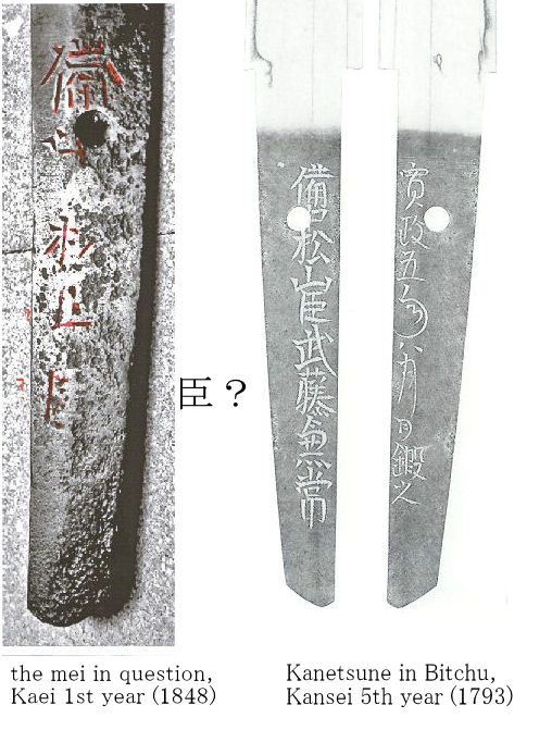

Nobody Posted April 18, 2008 Report Posted April 18, 2008 I was watching the modified pictures for a while, but I could not find any reasonable answer. As for “Bitchu Matsuyama (備中松山) +something”, I found and attached a similar mei. Though that is not the same smith, that suggests that the 5th kanji may be 臣 (shin = retainer). As for the other side, the date may be the 9th month of 1848 as I wrote in my previous post. The inscription on the right of the date might be Tamemei (為銘), but I cannot read or understand that. I may be wrong in reading those kanji, as they do not make enough sense. Quote

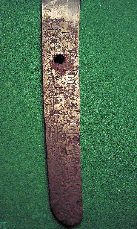

drbvac Posted April 21, 2008 Author Report Posted April 21, 2008 Thank You !!! I will keep trying as well. The photos are certainly less clear than the blade and I may try to ermove a little of the red rust on the nakago. I did read some inscriptions that did have "ertainera' in them as the smith worked specifically for a daimo but will have to continue looking. Wher do you feelt he smiths name would be in the list of characters? Quote
Nobody Posted April 21, 2008 Report Posted April 21, 2008 I suspect that the smith’s name had been just after “備中松山+something” and the name is now worn away. Quote
drbvac Posted April 21, 2008 Author Report Posted April 21, 2008 Thats what I thought so maybe with the date, and the inscriptions that we know if I put it on general Nihonto and ask for possible attributions I may get some luck! Arigato Domo for your expertise Quote
