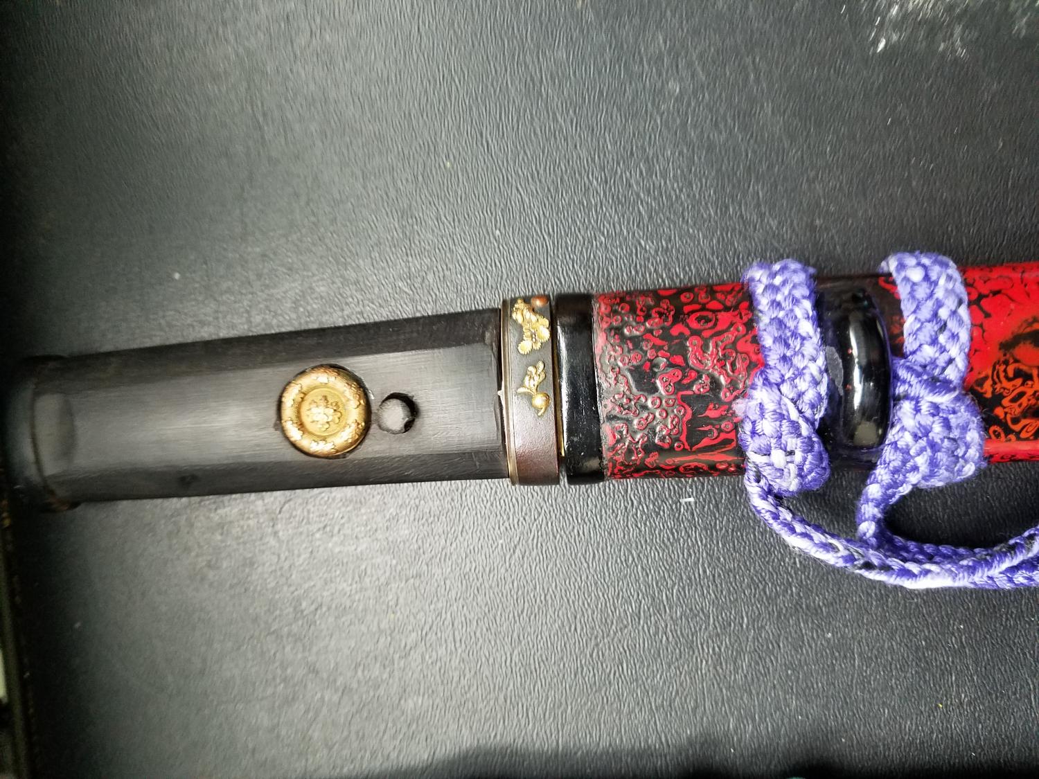

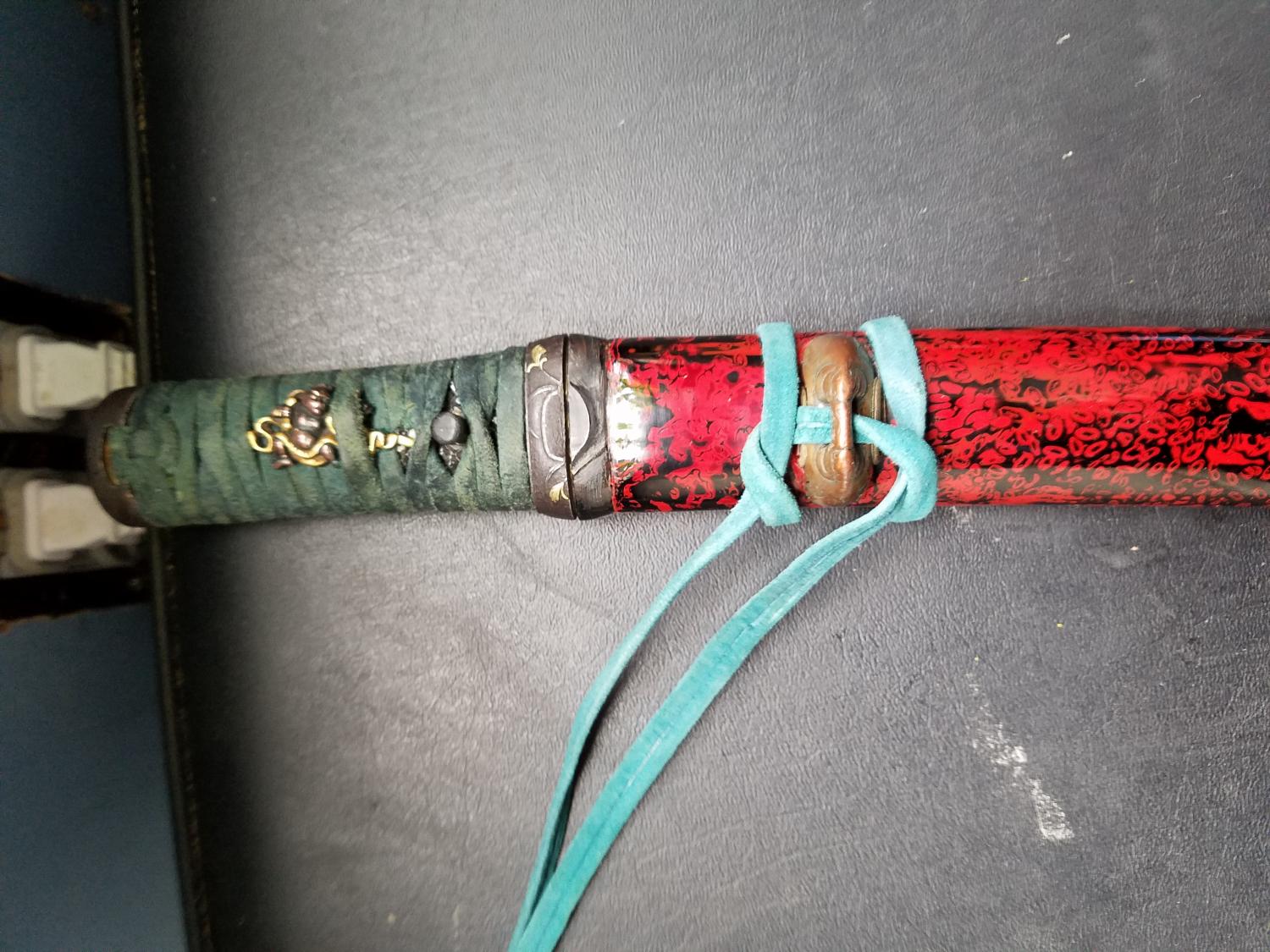

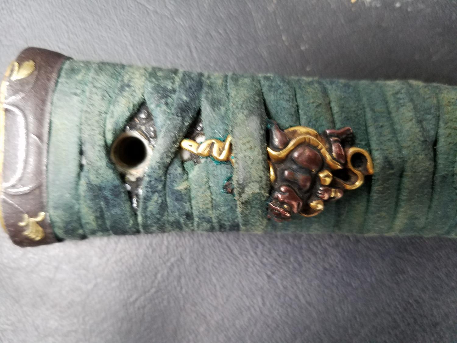

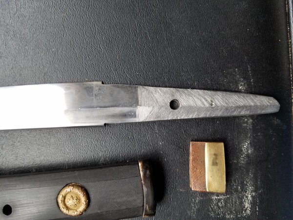

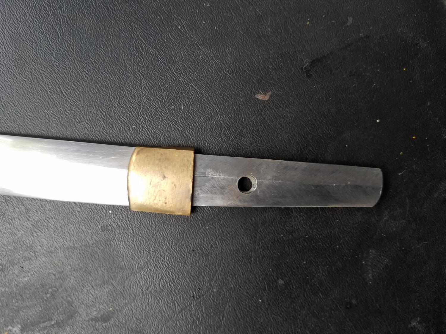

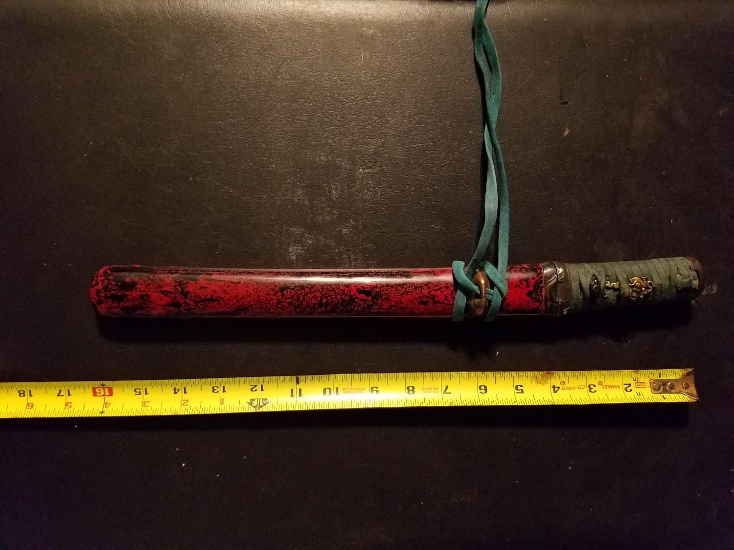

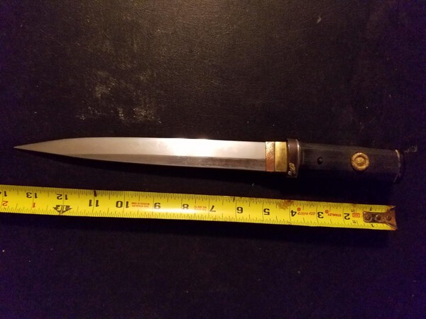

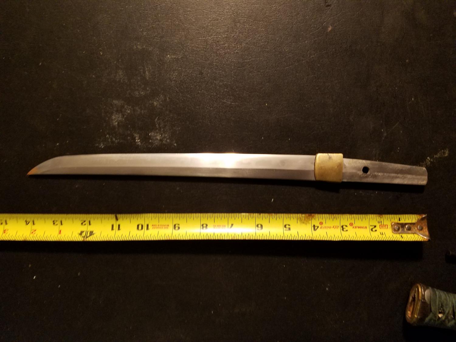

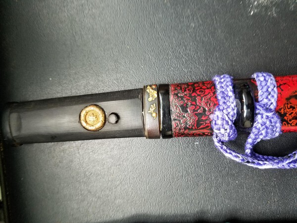

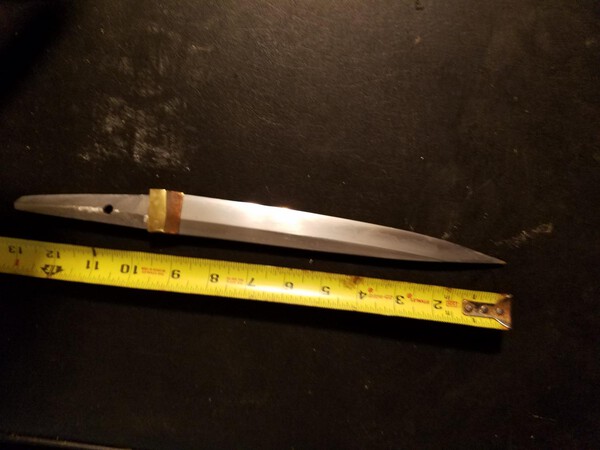

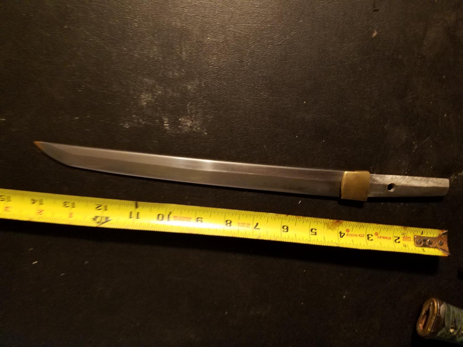

2 tanto made out of a blade that was snapped in the middle (broken past the shinogi, then someone attempted to hammer it back together).  They probably thought they could cut a tree down or something akin to that. A great deal of the furniture was made by the gentleman who cut the blade down  (the o-suriage and the satsuma-age), also the laquering and the tsuka.  The menuki, one kurikata, and one fuchi were from collections; habaki, tsuka, etc. were all made.  Took almost 8 years, but was worth it.
Yours,
john twineham

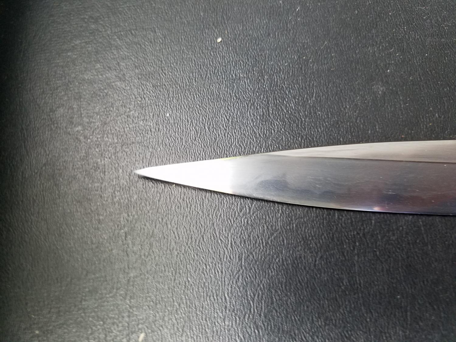

The base of the original blade was koshisori, and had large hardened formations, so the satsuma-age was tapered down into a hardened formation so it would have the requisite hardened tip.  Ended up looking like a yoroi-doshi in shape and relative thickness of the mune.
john twineham

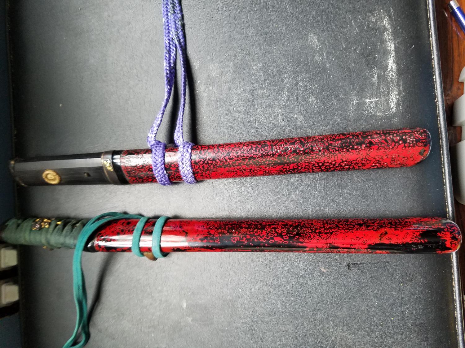

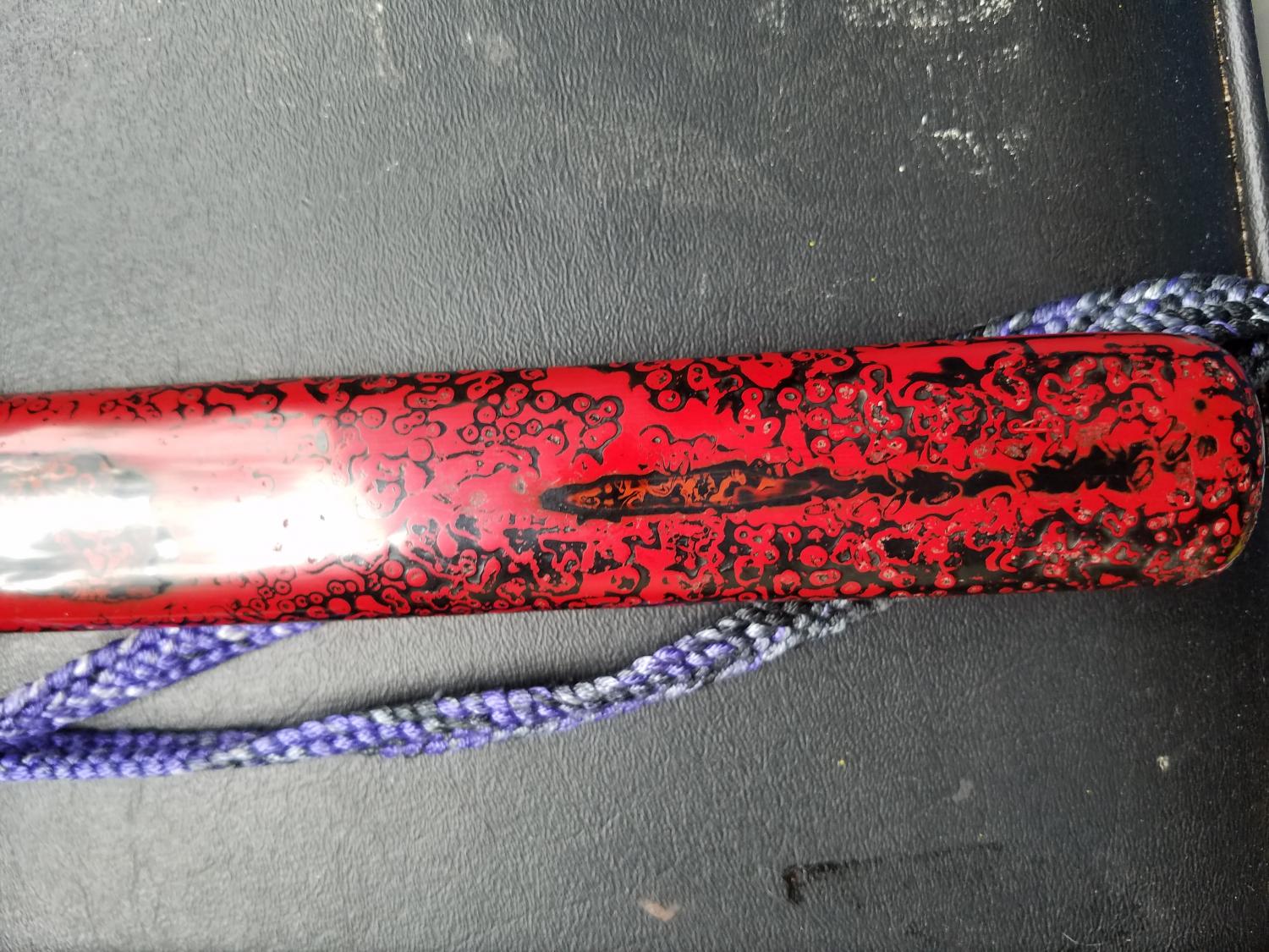

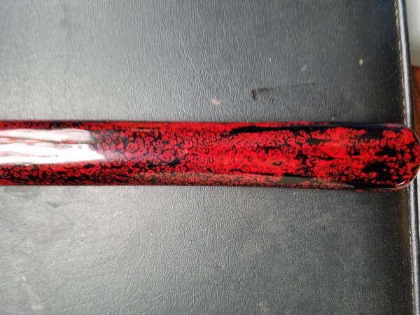

Here are a couple of pictures with shapes; seems to be a little moisture accumulating in end of both sayas causing some red rust; will eliminate that shortly.
