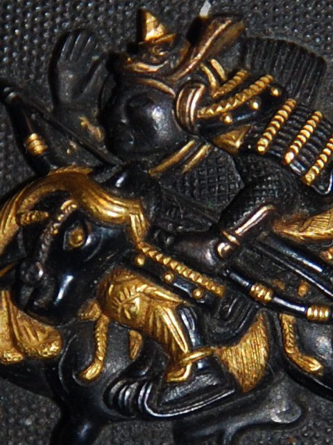

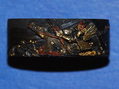

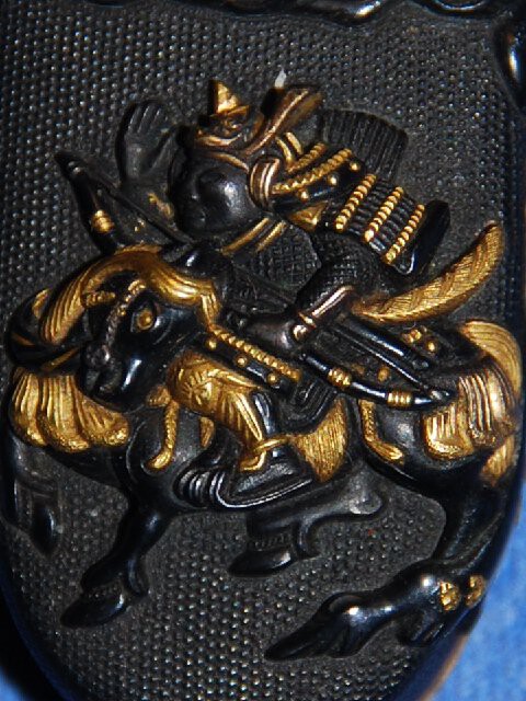

Hi Milt,
Very tasty piece, lovely bit of work.

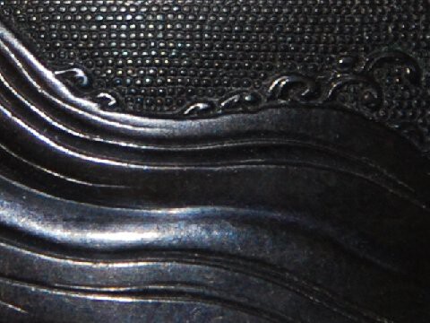

It does look as thought the nanako was applied after the inlay. The fine line around the actual inlay seems to suggest that. In fact it is evidence of the exact opposite.
The ground would be prepared and the piece to be inlaid, shaped to fit the curve of the top of the kashira. Then the outline of the inlay would be scribed around the piece directly onto the ground, ie; the kashira blank. At this stage it would be passed to the studio specialists who would create the nanako decoration. It can be seen that it would be much easier to keep the lines in a coherent arrangement before you have the inlay in the way, marking out the lines is also much easier this way.
When the inlay work is to be done the craftsman creates only the very finest raised edge to the recess into which the inlay design is to go. It's more like setting a gemstone. The sleight burr is then pushed back down taking great care not to mar the nanako beyond the immediate outline.
Obviously this sort of minimalist inlay technique requires a massive amount of control and experienced judgement to gauge the amount of metal to move that will still do the job.
There is in fact an iron tsuba by Goto Ichijo ( I think) in the Caldwell collection catalogue, that has a polished ground with a spray of flowers and plumb blossoms, that is set in the same fashion. In that case the the outline of the inlay is a fine incised line.
