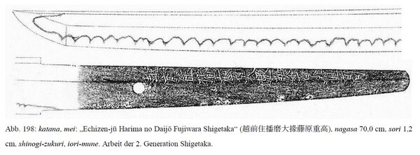

Is it possible for more trainned eye to find if this two mei are written from same smith. Black an white reference is NBTHK Hozon papered Shodai Shigetaka- brown photo is mine (dated 1623).I put two pictures together on mobile phone.

Hi Bojan,
The NBTHK Shodai Shigetaka mei looks very much like on your blade. If I remember correctly, the Shige Kanji for the Nidai looks somewhat different than the Shodai. I'm not an expert, but my guess is your blade is by the shodai. Because your blade is dated 1623 the NBTHK probably felt it wasn't necessary to mention which generation since the date on your blade should give you a good idea that it is the shodai. If your blade is coming from the sword polisher, you can always ask him which generation he thinks it is.
Thank you very much Ed. I was thought that shinsha put remark (shodai) allways when they are 100%. I realy find only reference oshigatas (shodai and nidai)that are not of the blades with inscribed dates.Posted signatures are real very similar.I will show pictures of the blade when it comes.

I am certainly no expert on mei, but to me it looks like your mei is by a different hand than the other one posted. I do not know enough to draw any conclusion from this.
Borjan, look very closely at the small box shape in the kanji for shige in the pictures of the two nakago you have above and compare them to each other. The kanji for shige in the left nakago shows the way the shodai wrote shige and the one to the right, where the horizontal lines are nearer to the bottom of the box with a space above is the way the nidai wrote shige. That difference should allow you to determine which generation made your sword.
Thank you Ed for this info. I looked at diferent nbthk papers and it confirm your observation on kanji Shige..shodai (lines in the center of the box) and nidai ( at the bottom). Another good reference of papeted Shodai.
