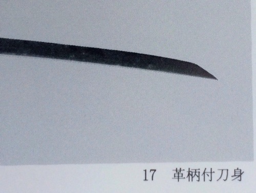

Marius Posted October 11, 2014 Report Posted October 11, 2014 Stumbled upon an interesting picture in the small booklet to the Uchigatana Koshirae exhibition in 1985 by the National Museum in Tokyo (please don't confuse this booklet with that big book on the same subject), A sword from the 16th century has what seems kamasu kissaki, which is said to have been the standard until the 14th c. So, this sword is either older or kamasu kissaki was used even during the Sengoku jidai,,, Quote
celt72 Posted October 11, 2014 Report Posted October 11, 2014 Aoi-Art post posted a shinsakuto today with a kamasu kissaki also. I had never seen one before. Very interesting. http://www.aoijapan.com/katana-mo-todai ... toshi-saku Quote
cabowen Posted October 11, 2014 Report Posted October 11, 2014 So, this sword is either older or kamasu kissaki was used even during the Sengoku jidai,,, Or it was broken and reshaped.... It is possible though that it was made as a throwback to an earlier age, which happens from time to time. That is what makes things so interesting... Quote
Marius Posted October 11, 2014 Author Report Posted October 11, 2014 Or it was broken and reshaped.... Hm... and given to a shrine? That would have been disrespectful, no? Quote
cabowen Posted October 11, 2014 Report Posted October 11, 2014 Or it was broken and reshaped.... Hm... and given to a shrine? That would have been disrespectful, no? MIshima Taisha had some blades that were pretty beat up so I don't know for sure....Don't forget many of those Nara temples/shrines had warrior monks and veritable arsenals...I'm just saying it is a possibility... Quote
Marius Posted October 11, 2014 Author Report Posted October 11, 2014 Ah, yes... I thought "votive", but you have rightly pointed out "arsenal"... Thanks :-) Interesting in any case Quote
