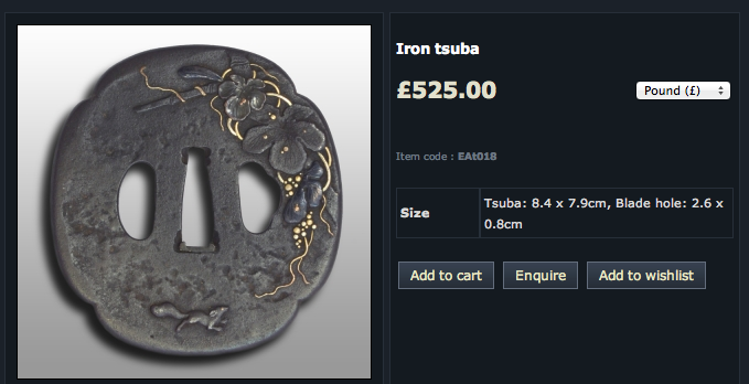

I am delighted to re visit this topic with great news. After thinking my line of enquiry was falling on stoney ground, I put my points to Grey, and he immediately responded in a very positive way. His consideration is, that he now includes in his sale descriptions of Tsuba the nakago hitsu ana measurements.
I would like to here thank Grey, from myself and others who are not collectors. And I will endeavour to favour his site for future purchases.
