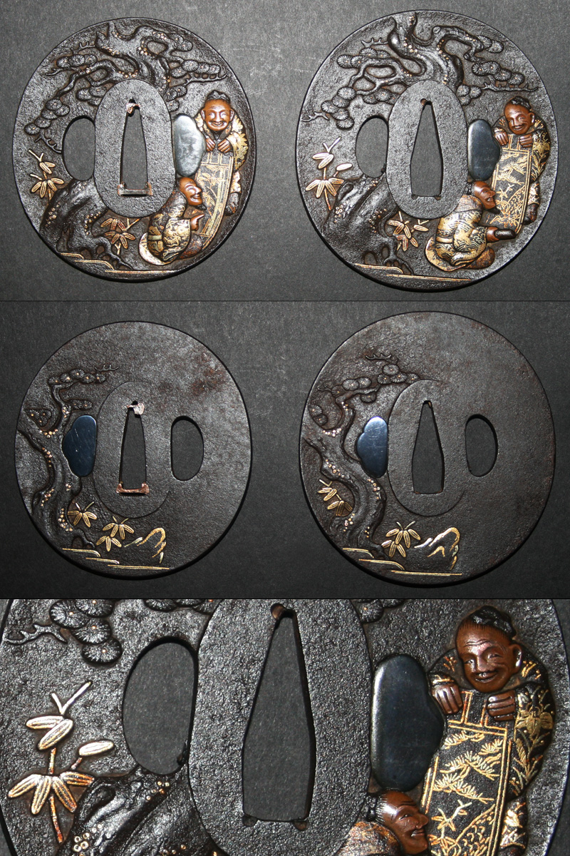

Hello friends,
I got this daisho tsuba set in trade as part of a recent sword sale, but I am not very much a tsuba/tosogu guy, unless that I think the tsuba's is very nice and seems well carved. I have tried to do my own research, and find it most similar to Soten school works... I am guessing age to late edo - 1800's... However it bothers me is that Soten works almost always seem to be signed and mostly done with some open work/sukashi?
As my experience in tosogu is very limited, I must admit I am not sure about any of above regarding to school, age, value and your oppinions and help about this set will be very much appreciated.
EDIT: I see what Jean mean and have changed the light settings and also used another camera to make new pictures. The new pictures shows better, but patina is a little more brownish irl.
Sizes are approx.:
Katana tsuba:
Length : 7.90 cm x 7.40 cm
Thickness of rim: 0.40 cm
Wakizashi tsuba:
Length : 7.40 cm x 6.90 cm

So you think it is Soten? I have changed light and camera and shot some new pictures, that shows better... sometimes photographing nihonto, camera makes everything look worse than really is (or I am just not a good photographer :glee: ).
