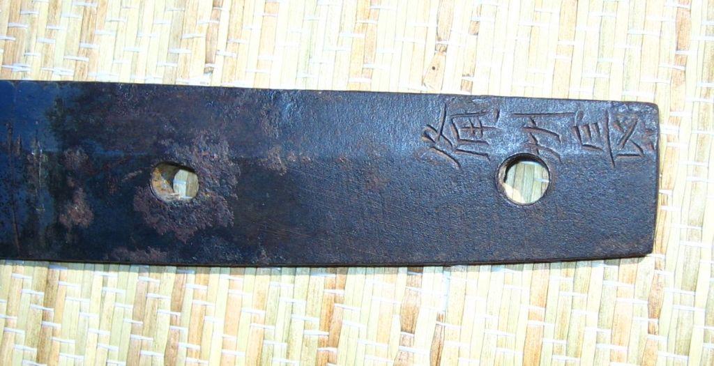

Let me ask about the tsuba with inscription:
"Odawara-Ju Masatsugu".
The only Masatsugu I've found was the "founder of Odawara tsubako", and lived in 17 century (information from "Nihon To Koza").
Is it possible that he made this tsuba?
Maybe someone knows other Masatsune from Ito school?

Very interesting tsuba, I hope to learn some more about it from our tosogu experts, why the larger Kogai bitsu and why the extra hole next to the Kozuka bitsu, the kanji under it?
Looking forward to more on this.
Thank you, Steve!
It would be interesting to see examples of works and signatures of both Masatsugu...
The additional hole: maybe it was made to fit to gunto? But the shape and the position is very unusual in this case, I think.
I agree with Steve that this very attractive tsuba is not the work of Itō Masatsugu (H 04687.0). This artist, the supposed founder of the Itō school, was working ca 1650-1700, and Andrey’s tsuba has nothing like that age. Neither is the mei like that of the master, illustrated on pp. 409a and b of Kinkō Meikan. It is more probably by the later Itō artist (H 04688.0), working ca 1800.
Could Andrey really decipher this mei as ‘Odawara (no)Ju …, or was that the eye of faith?
As for Stephen’s queries re the large kōgai-hitsu and the aperture on the seppa-dai; apart from wondering if the latter was a method of enlarging the nakago-hitsu, I am awaiting further enlightenment.
Regards, John L.
Good Afternoon All,
I'm probably casting more darkness on to this question than light 8) , but enlarging the images leads me to suspect that one or perhaps even both hitsu-ana plus the extra cut out were not original on this tsuba, as you can see bits and pieces of chiseling that remain along the edges of what had once been there before. If so, this might be a customized alteration simply to accommodate a set of koshirae.
PS nice tsuba as it is, now picture it without the additional cut outs!
Concerning the mei:
The seller indicated: 小田原住 正次
I think he is right, as the first kanji is visible, and the design resembles the Ito school. So, it's highly probable that the damaged part of the mei is "Odawara..".
... one or perhaps even both hitsu-ana plus the extra cut out were not original on this tsuba...
It seems to me too, that the openings are made later.
The strange hole between nakago- and kogai-ana is a late addition for sure: it's made over the mei.
The both hitsu-ana are probably also made later, as there are small parts of the original design on its edges:
