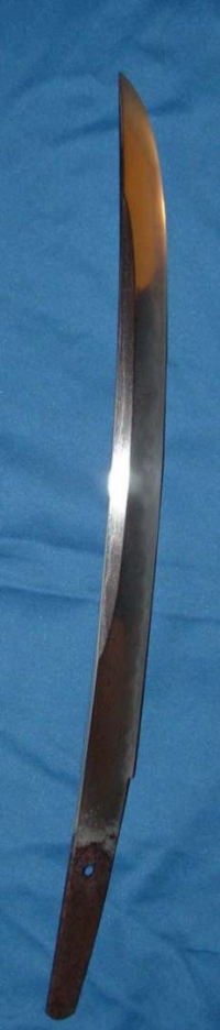

I have an unsigned wakizashi Chris was kind enough to submit for me at the recent Minneapolis Shinsa, unsigned, scored 75 points to Den Mito Sukemitsu, Ansei (1854) . I've seen Den referred to school or tradition but also having a different meaning from what is normally thought, as related in an article written by Robert Benson. I added a link below to the article as well as pasting in part of the article's text here:

Also, would anybody have any links or good close-up images of swords made by Mito Fujiwara Sukemitsu's hamon and hada they could share here or PM me? I'd like to compare mine with any other examples. below are a couple pics:

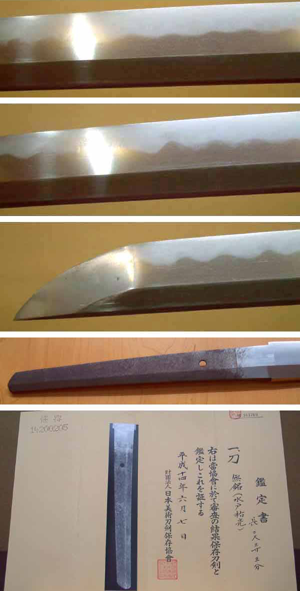

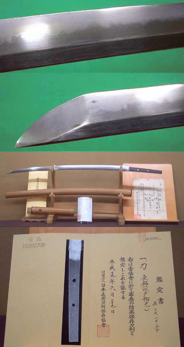

I had 2 Mito Sukemitsu katana a while ago. When I find the pictures, I will post them.
Regards,
Here they are!
Unfortunately old bad pictures and no details visible. Both blades unsigned but hozon papered. Mokume - masame hada and gunome hamon like on you sword are quite typical!

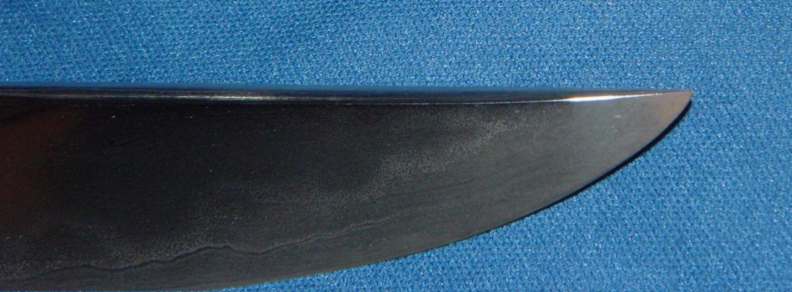

If I could be a pain again, I attached one more picture: part of the worksheet showing what the judges wrote down for the kitae and Hamon, I'd be very grateful if anyone could make out what it says, as it's beyond me. Kitae was filled in as other, as the grain is a little unusual.
