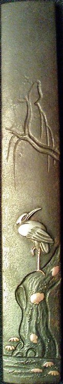

Greetings gentlemen.
This is another begging letter, once again displaying my lack of general nihonto knowledge. Perhaps someone can help me fill in some of the gaps (gaping voids) again.
Can anyone suggest a school for this one?
Regards,
Hi Alex,
not too sure this is actually of Japanese manufacture. It looks to be an honest piece of work but not pre-modern period in my opinion.
Is there anything on the back?
regards,
Ford
Ford,
thanks for the reply - how very interesting........ there is nothing on the back in terms of design or mei, just a simple smooth matt finish. I have seen tsuba with a very similar style heron/egrit rendering before, but always assumed they were Japanese. This came as part of a koshirea (no matching kodogu) that I obtained from Don B. in London about 18 months ago. Here is a slightly closer shot.
If not Japanese.....then......who/where? a "fake"?
Hi Alex
the heron theme is quite a common one on Japanese tosogu but the the actual composition and rendering that bothers me on this. With genuine antique pieces of this type either the maker was an accomplished artist and drew their own designs or they relied on design books that were produced for this purpose. This design seems to be "unaware" of the many conventions that would be almost instinctively followed by classically trained workers.
The technique is all genuine inlay and the materials all look reasonable although the leaves appear to be unpatinated, perhaps red gold. If it is red gold then it's definitely not Edo period.
The way the tree bark is carved is a bit vague and here there are quite clear approaches one would expect to see. Have a look at Hamano work to get an idea of how traditional workers would have treated a tree like this. The way the bottom of the design is abruptly cut off with that last section is simply wrong in Japanese design terms, it doesn't make any sense nor add to the composition at all. The 3 clusters of leaves on that bit are also a bit like clusters of chips, not leaves. The chiselling of the willow branches doesn't seem to know what it's supposed to be. In classical work this would be done with a kata-kiri chisel which leaves a cut that is reminiscent of the way a brush stroke swells and thins as it moves across the paper with one edge of the cut nearly vertical and the other gently sloping away at different widths depending on the overall depth etc.
I wouldn't call this fake though. Someone has obviously gone to a lot of trouble and the work, despite missing the mark compared to traditional work, is still a fair bit of workmanship. It may well be the work of a contemporary Japanese hobbyist or just as easily a western amateur.
I know Don Bayney well btw, please give him my regards when you next see him.
regards,
Ford
Ford,
Fascinating. I always thought there was something a little "odd" about the composition, and it didnt seem to fit into any school I have ever come across in my somewhat limited reading and online research, hence my asking. I know exactly what you are talking about regarding the willow being uncertain. The "leaves" also look somewhat weak - I believe them to be copper, but my photography skills here are poor and I cant be sure the colours are right.
What I meant about the heron was that I have seen almost identical heron rendered in the same style and manner in other works, but the rest of the scene seems a little strange. It is wonderful to have input from someone as knowlegeable as you on the matter.
