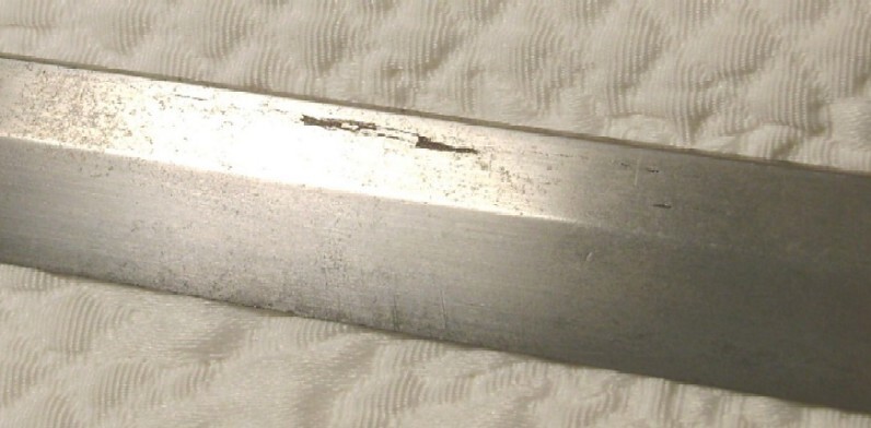

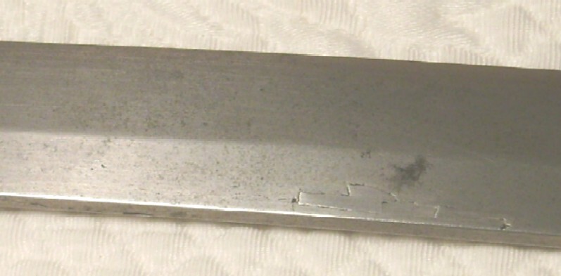

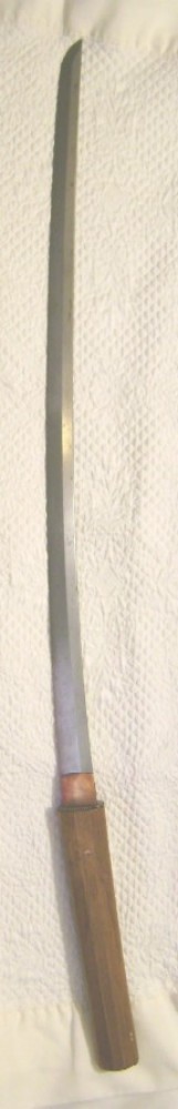

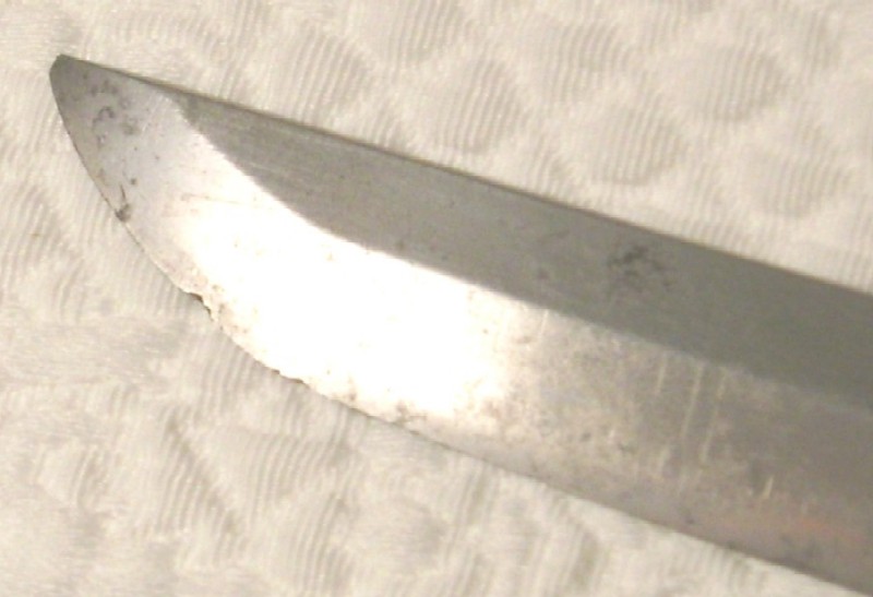

doug e lewis Posted September 7, 2010 Report Posted September 7, 2010 This is the sword I "rescued" many years ago, mentioned mysteriously in my rambling posts. My 1st attempt to photograph a sword. My sayashi friend, Mike V., gave me a hilt from his reject pile that amazingly lined up prefectly with the top mekugi ana. He took a quick look at the sword -- he was busy making shiasaya for paying customer -- and said from the sugata it was Koto, Uda school, ca. 1560, a mass produced sword, over polished so some shingane or defects were revealed, and added the steel looked "wet". ?? "Nice old, tired, uchi-gatana." finally felt I knew enough to describe the sword, take pix and see what the patient NMB members think --- dispite not being able to hold the blade in hand My reference books used for this are The Connoisseur's Book of Japanese Swords by Kokan Nagayama, and A Primer of Japaneseword-Blades by B. W. Robinson 1955 sugata - looks like End of Muromachi as shown in Connoisseur's tsukurikomi - shinogi-zukuri nagasa - 65.5 cm. sori - torii-zori, 2.1 cm. (shallow?) Mihaba motohaba - 3.2 cm. sakihaba - 1.9 cm. Kissaki - chu-saki size 2.1 cm. tip broken, about 1-2mm Boshi - not visable? Yokote - more visable on one side than the other hamon - Uma-no-ha midare - hard to see now, but in the right light some is visible, and looks like that ha-mon illustrated in Nagayama's book Iori mune Jihada - Muji-hada Nakago - Ubu, mumei yasurime - none 2 mekugi ana nakugojiri -- Ha-agari kurijiri In the shinogiji there is a kukure yabure on one side, and an obvious unegane on the other. the nice solid copper habaki it came with is tight and dirty under it. I was advised to gently clean under the habaki, taking care not to clean any of the nakago; I followed Mike's instructions. the togodu were placed in the late Edo. The tsuba were identified as an imitation Soten when I posted them on NMB a long while back. But made for this katana, and the menuki carry on the theme from the tsuba. Not relevent, according to Mike. Probably has been mounted several times if really a Koto. Hope the pictures are at least entertaining. I look forward to you comments. thank you. Quote

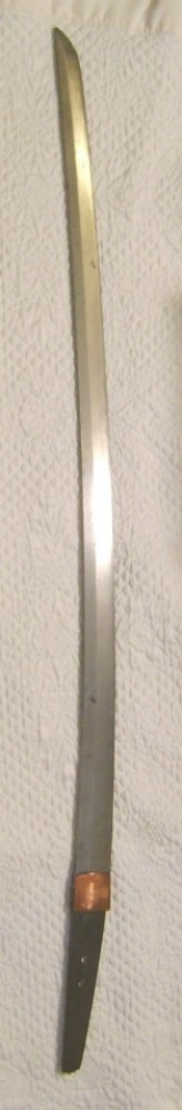

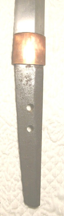

doug e lewis Posted September 7, 2010 Author Report Posted September 7, 2010 Here are pix of whole sword. Quote

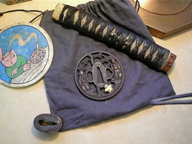

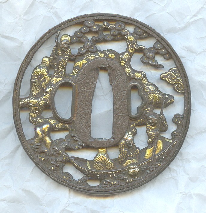

doug e lewis Posted September 7, 2010 Author Report Posted September 7, 2010 OOPS,, I am sorry. that is not the tsuba it came with; just one i like and had pix of . let me try again. Quote

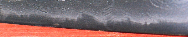

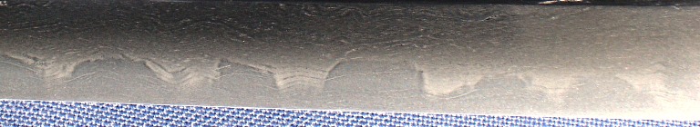

Eric H Posted September 7, 2010 Report Posted September 7, 2010 He took a quick look at the sword -- he was busy making shiasaya for paying customer -- and said from the sugata it was Koto, Uda school, ca. 1560, a mass produced sword, over polished so some shingane or defects were revealed, and added the steel looked "wet". ?? The hada is obscured, no details are visible and I wonder that under these conditions an attribution to a defined school should be possible. Left - hada of a Uda Kunimune Tachi, Oei days. Right- hada of a Katana attributed to Uda, late Muromachi period. Eric Quote
Jean Posted September 7, 2010 Report Posted September 7, 2010 Eric, I agree with you that from the pictures nothing can be seen but we have to assume that Doug who have the sword was able to see that the blade had muji hada, which is surpring when one has seen Uda hada which is among the strongest in Nihonto with fantastic chikei. Some examples are available on Aoi Art/Tokugawa websites : http://www.sanmei.com/contents/media/N4 ... PUP_E.html http://www.aoi-art.com/sword/wakizashi/ ... 7478-2.jpg http://www.aoi-art.com/sword/wakizashi/04139.html The wetness of a blade, if any, this being a subjective term, is invisable on an out of polish blade. Quote

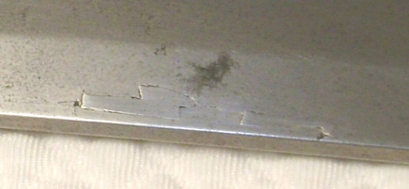

Eric H Posted September 7, 2010 Report Posted September 7, 2010 Jean, Even the sharpest eyes cannnot see more than a shinogi-ji and hiraji completely uniform in appereance, pitted and stained, no hamon is discernible. What to do is to open a „window“, if a proper restoration is desired...but that would have to think twice...just my opinion. Eric Quote
Jean Posted September 7, 2010 Report Posted September 7, 2010 I agree with you Eric, but I thought that such a hada (Uda) even on an off polish sword could have left some trace, - I was wondering : If there is no trace of any hada (muji) then how any kantei can have been done on Uda? Perhaps there is nothing and this blade could be Bizen as well All this to say, Doug, that nothing from your pictures/description supports the Uda kantei and above all the hada which is Uda kantei point Sori and length could support end of Muromachi theory, that's all which can be said Quote

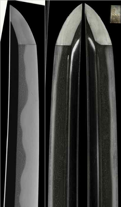

Jean Posted September 7, 2010 Report Posted September 7, 2010 Uda school = Northern provinces: Smiths : Go Yoshihiro/tametsugu/Norishige. Exactly the opposite of muji hada. The strongest hada one can see, look at Eric's oshigata. Blackish hada. Quote
Amon Posted September 7, 2010 Report Posted September 7, 2010 Perhaps I'm out and riding a bicycle but I find it very hard to see any kind of muji hada on a blade that is out of polish, pictures or not. If it is somehow difficult to spot on a polished blade how would it be on blade out of polish? Kind regards, Quote
doug e lewis Posted September 7, 2010 Author Report Posted September 7, 2010 WOW!! Jamie-san. Amon-san, you are right. My katana is so out of polish it never showed a wisp of hada like those... and I have already mentioned my difficulties is seeing hada on swords in polish that I have held. Only in NMB member photos like those and in books have seen hada. My ji just looks like shiney steel. The ha-mon, when it was visible years ago, looked very similar to the ha-mon in your bottom Uda example. There is a faint bit of it still visible, but my current attempts to photograph it failed. Will keep trying. Gonna have to do as much research as I can on the web, though. If I buy anymore books on swords its KP for the rest of the year. Tsuba/menuki books would be OK. My wife is a real fan of tosogu. She just hates edged weapons like swords, knives, etc, and doesn't see what I see in them. she does wants to get a shotgun for self-defense of our backwater, High Mojave Desert home. Go figure! And I dislike guns -tho I know how to shoot. Just doesn't much courage, or brains,to stand off a hundred feet and shoot someone. Very much the same distaste samurai had when firearms were 1st introduced in Japan. But am reminded of the answer my 9th Dan Shotokan sensei, Mr. Okazaki, said when I asked one day at the shooting range of our karate summer camp why he was practicing with a .44 pistol when he was an expert in foot techneques. "Sometimes legs not long enough" thanks for the help all I Quote
doug e lewis Posted September 20, 2011 Author Report Posted September 20, 2011 been some time since last postings on this, but anyone (Jean?) is interested here is a wrap up: returned katana to brother -- hope he takes better care of it. In Bizen style; late Edo; smith unkown. just as you thought jean doug e lewis Quote
