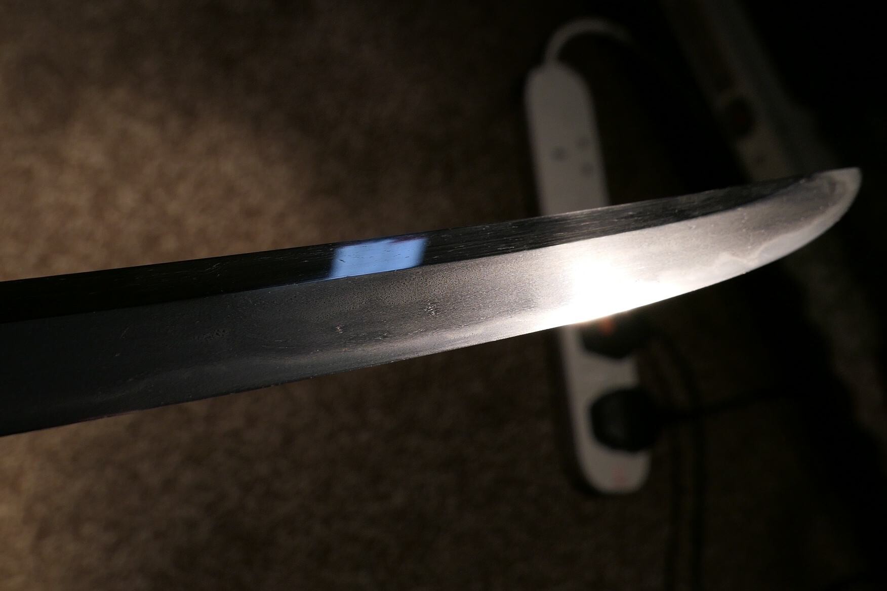

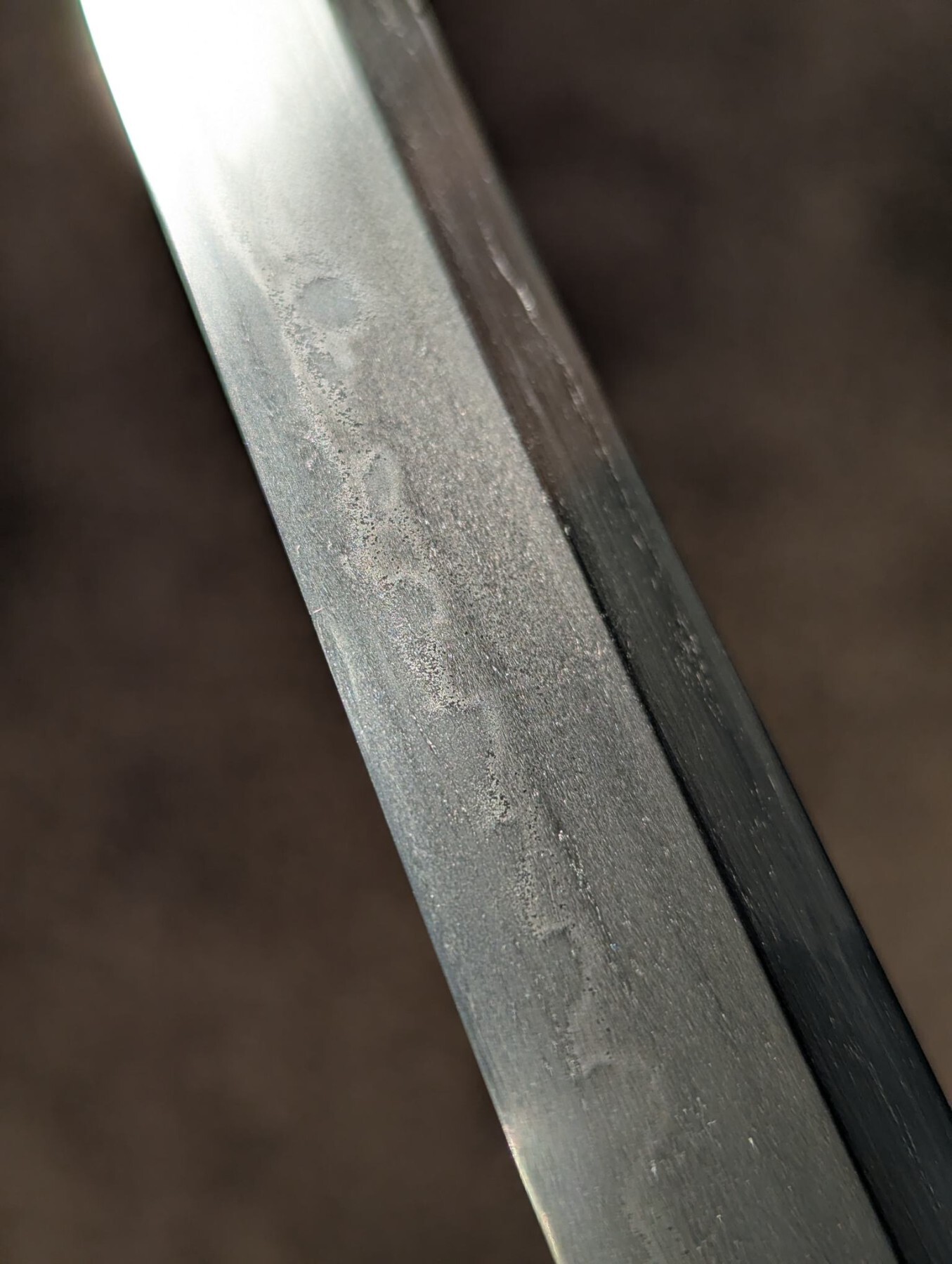

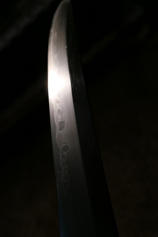

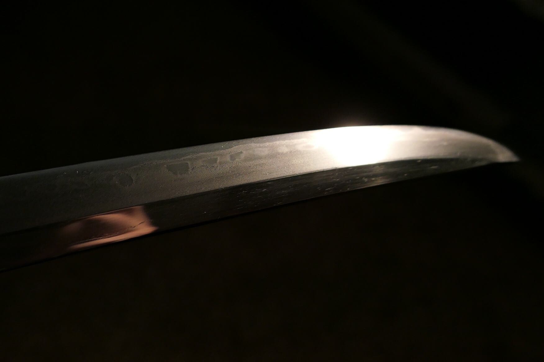

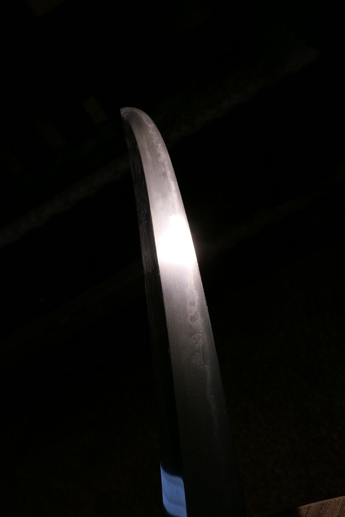

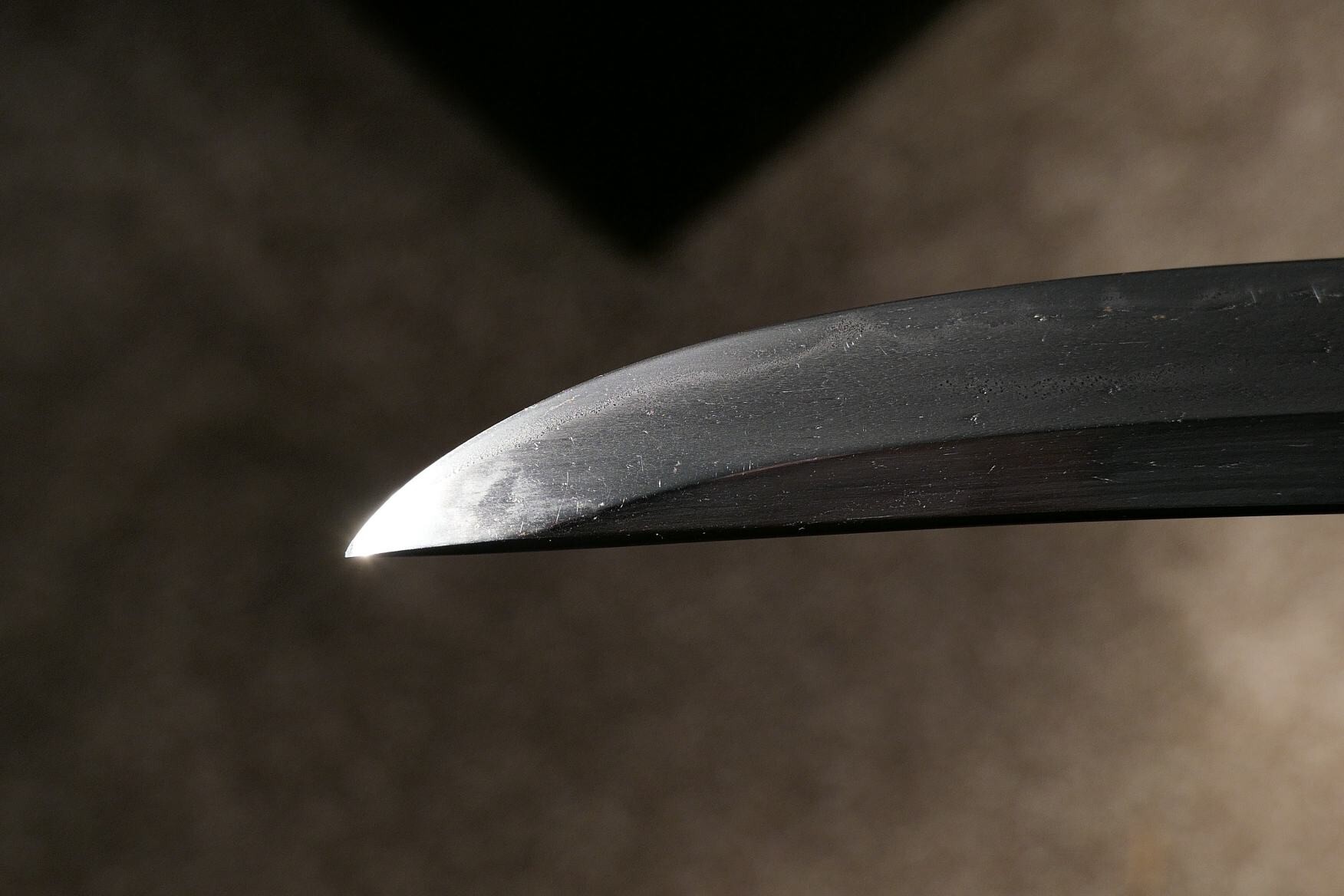

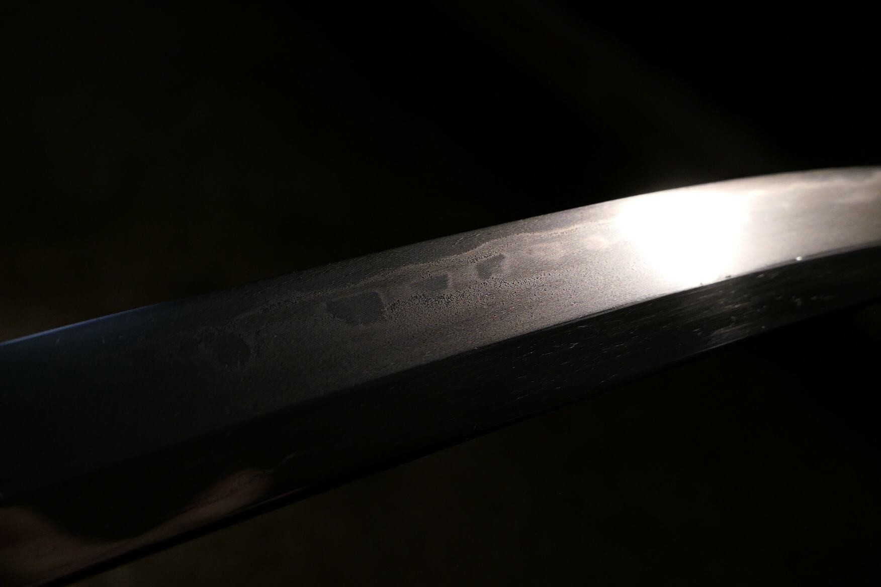

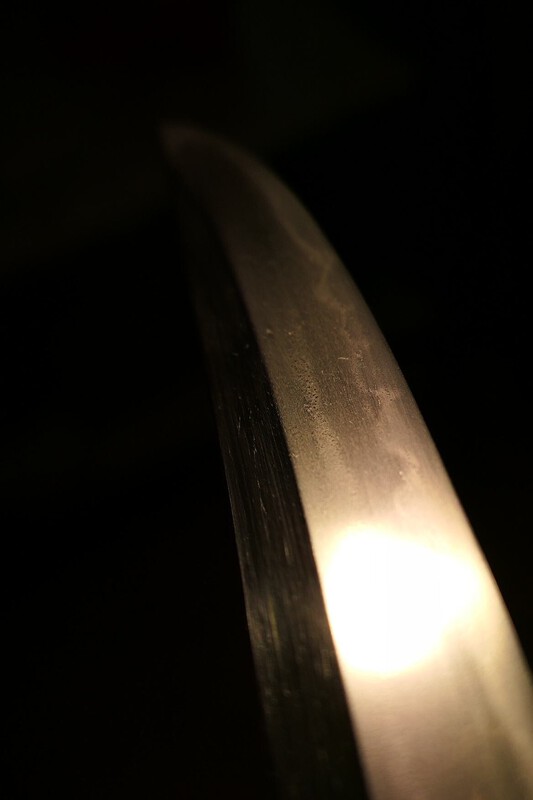

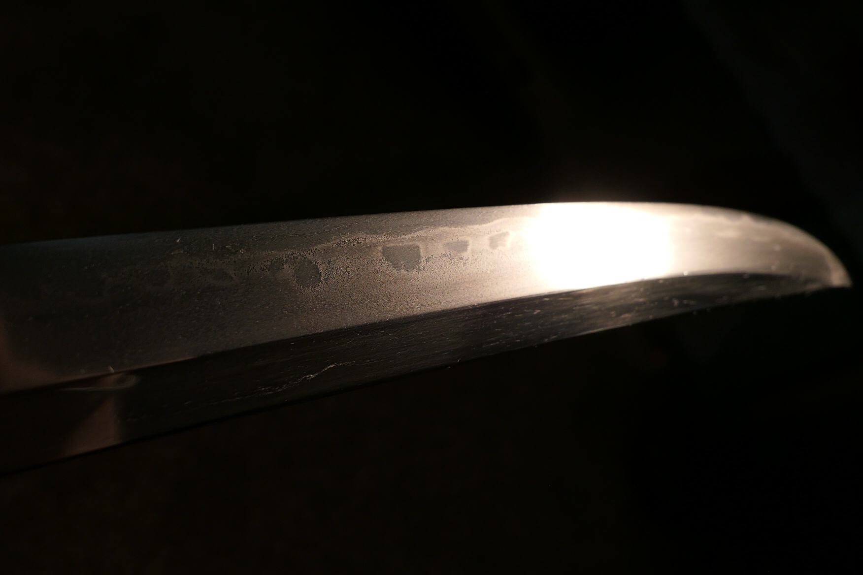

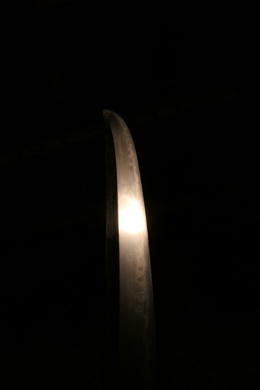

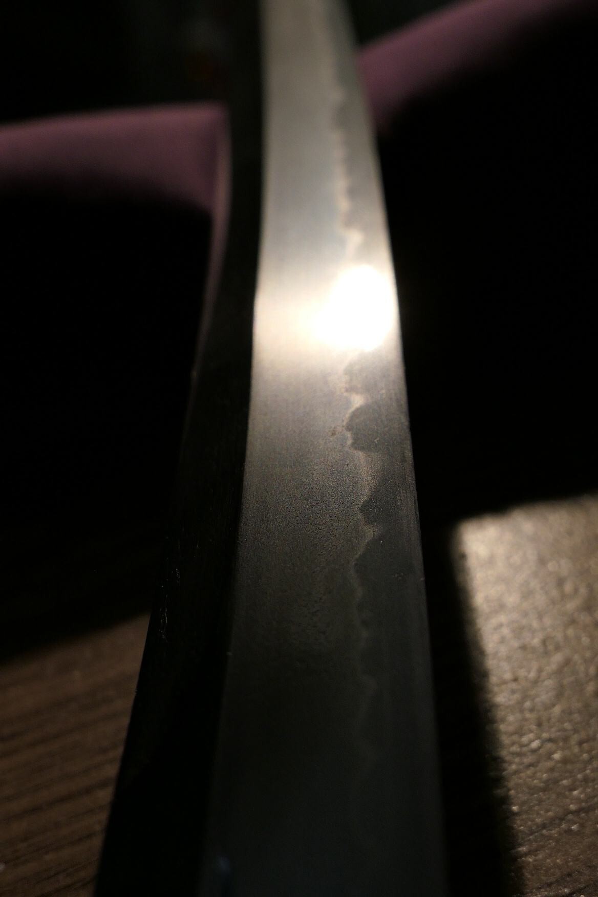

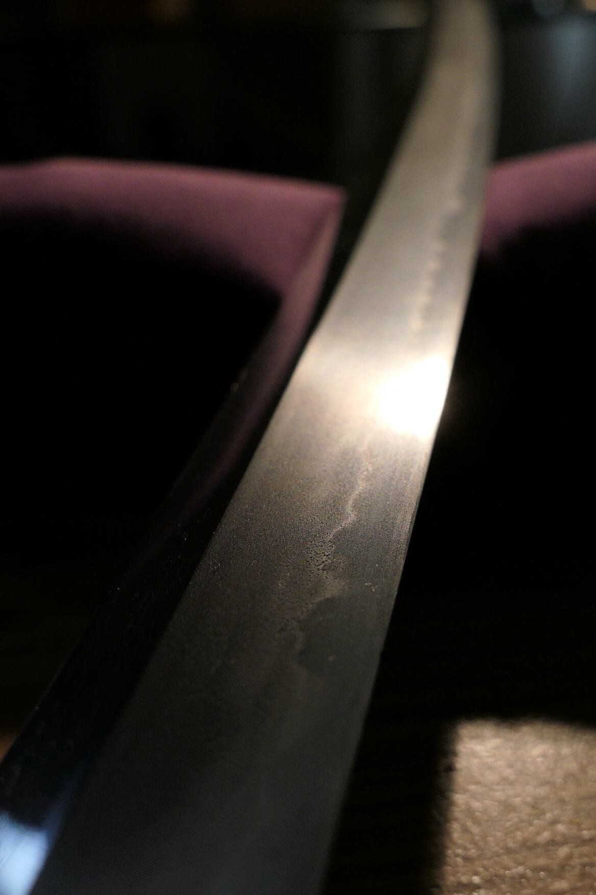

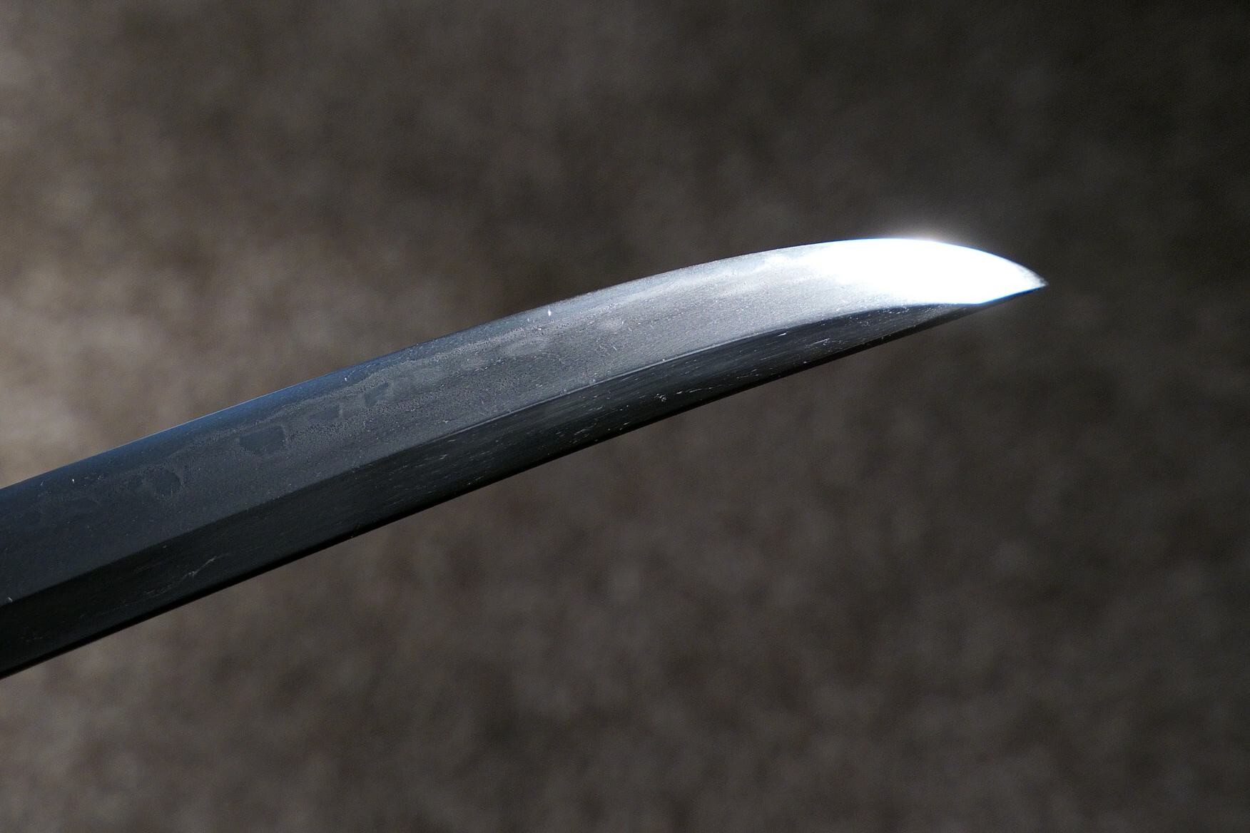

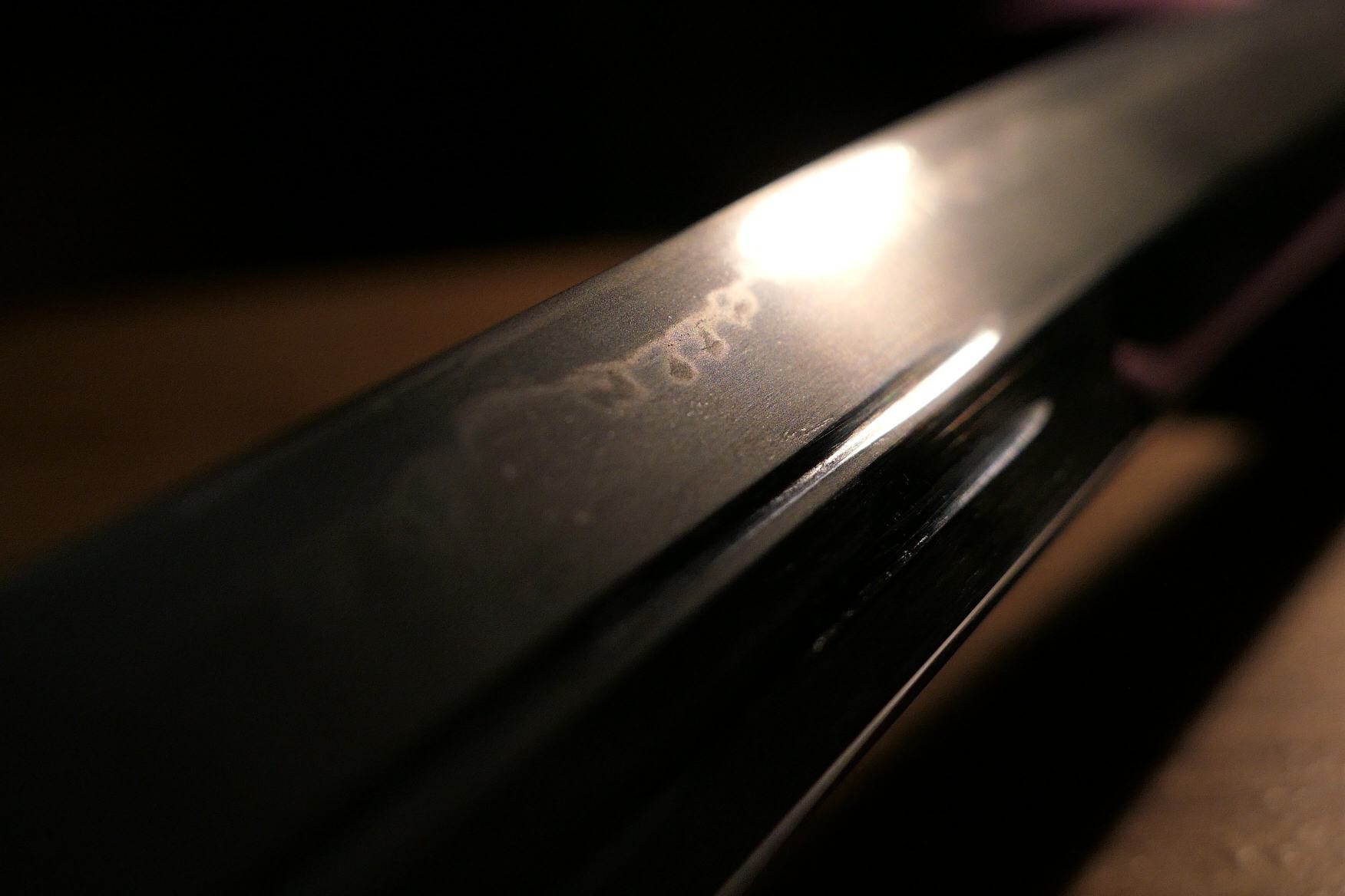

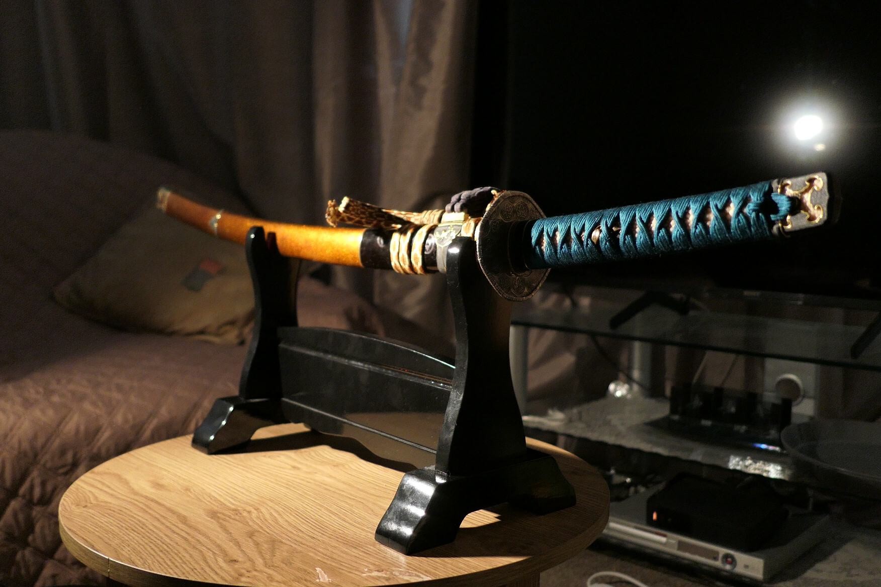

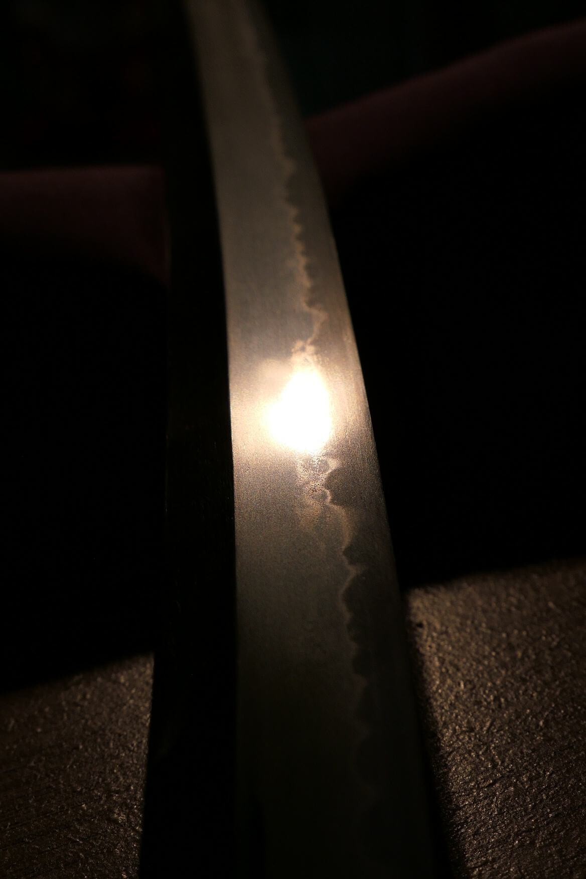

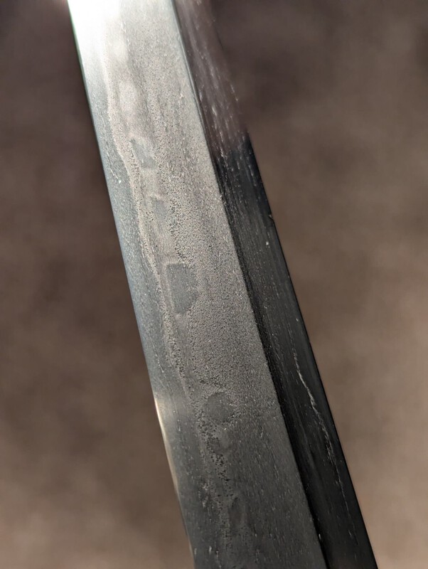

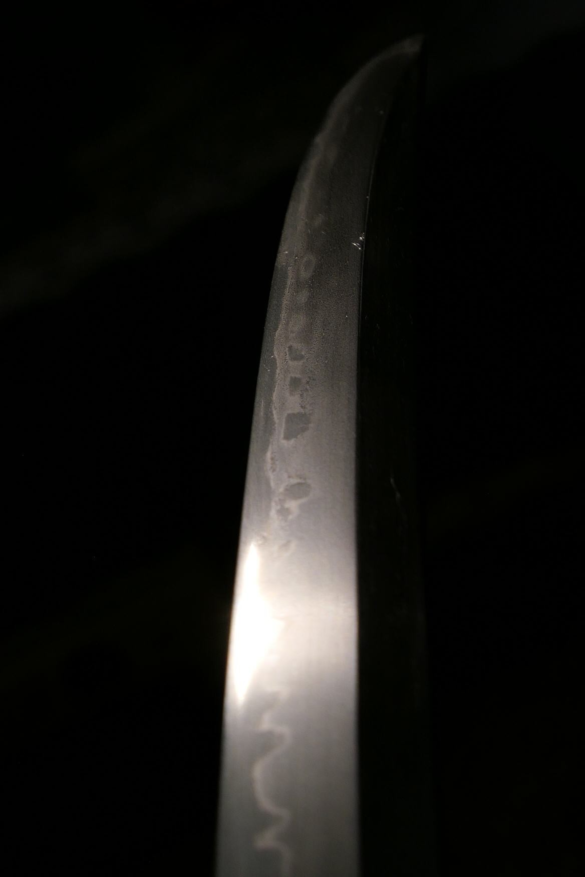

Marcus Devonport Posted August 26 Report Posted August 26 (edited) Evening guys, I hope each of you are doing well. I would like to get your thoughts on a 'nagamaki-naoshi' katana I've recently taken into my collection. An article on this particular sword made its way into the Token Society webpage a number of years back, so it's been an interesting sword to be able to study in person (accompanied by a great write-up 😁) It looks to incorporate some elements from both Bizen and Soshu-Den workmanship, which makes me lean closer towards Soden-Bizen as a start point to my research. There's certainly no shortage of visible activity within the steel. There's large concentrations of Nie throughout, with bucket loads of utsuri present (which admittedly doesn't come through too well on the photography). This sword came paired with a particularly interesting set of "convertible" handachi mounts, which I'll hopefully be able to share onto the Tosogu page (as I think it's worthy enough of it's own post 😁) https://www.militaria.co.za/nmb/topic/56696-a-convertible-handachi-koshirae/ The sword has yet to be sent through Shinsa, however it's definitely something I'll be keen to pursue in the future. Measurents as follows: Nagasa 68.5cm Sori 2.5cm Kasane 0.7cm Motohaba 3.0cm Sakihaba N.A. I'll drop some photos down below. Edited August 26 by Marcus Devonport 1 Quote
Lewis B Posted August 26 Report Posted August 26 Interesting looking nagamaki-naoshi. I would also say Soden Bizen is a good place to start. It would be great to see the write up on the Token Society if you can link or copy and paste. 1 Quote
ROKUJURO Posted August 26 Report Posted August 26 Do I see it correctly that one side of the blade has no SHINOGI? In this case, I would call it KATAKIRI-BA shape, combined with MOROHA-ZUKURI. I am missing evidence for NAGAMAKI shape but that may be my old eyes. Otherwise very impressive blade! 1 Quote
Marcus Devonport Posted August 26 Author Report Posted August 26 May be one of those things I'd need permission from the author for, but I'll happily drop a few extracts if I'm given the okay to do so 🙏 1 Quote
Marcus Devonport Posted August 26 Author Report Posted August 26 I think Its a combination of both the lighting and angle of photography; the shinogi-ji is same to both sides 🙂 1 Quote
Rivkin Posted August 26 Report Posted August 26 (edited) An interesting piece. I think its circa 1530 and unfortunately such Soshu-inspired pieces in harsh nie tend to paper rather randomly. Fun fact, Tsunahiro or Shimada are not much of an option, lacking typical togari and with very harshly defined nie it is. You can always get Bungo or something much stranger, but in my opinion period roundish gunome with such nie is Mino Kanabo. Ofcourse there is an optimistic view, which would point towards Hojoji which sort of pioneered such style. Edited August 26 by Rivkin 1 Quote
Marcus Devonport Posted August 27 Author Report Posted August 27 Thanks, Rivkin. Interesting, to see Hojoji come up as a potential option. I was guided towards such names as Esshu Kuniyuki, Tametsugu, Sanekage, Hojoji Kunimitsu as potential smiths, when I initially approached Ray Singer on this sword earlier in the week. 7 hours ago, Rivkin said: An interesting piece. I think its circa 1530 and unfortunately such Soshu-inspired pieces in harsh nie tend to paper rather randomly. Fun fact, Tsunahiro or Shimada are not much of an option, lacking typical togari and with very harshly defined nie it is. You can always get Bungo or something much stranger, but in my opinion period roundish gunome with such nie is Mino Kanabo. Ofcourse there is an optimistic view, which would point towards Hojoji which sort of pioneered such style. Quote
