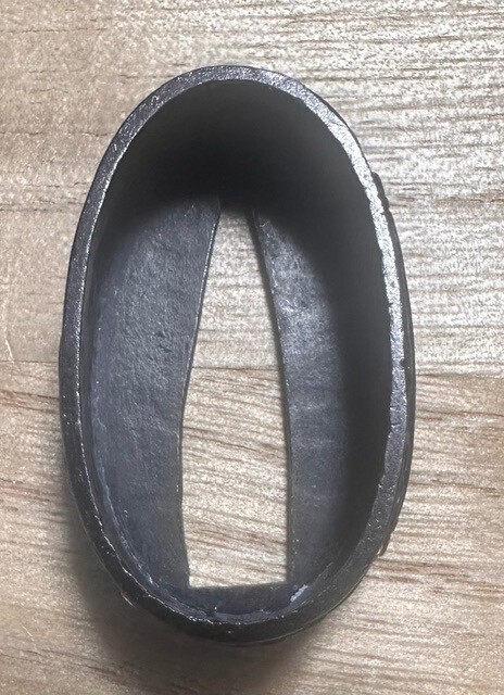

I picked up this FK set around two years ago thinking it was just a good quality modern replica.
The design is crashing waves with gold droplets and a raft is depicted on the fuchi.
Now I'm not really sure what it is. The shitodome are definitely modern - I bought them from Namikawa Heibei but the overall workmanship is confusing.
Pros:
They are not cast; the fuchi is soldered in two pieces with a reinforcing strip at the seam.
They appear to be made from real shakudo - even the main plate of the fuchi which is usually red copper.
The detail is crisp.
Cons:
The nanako does not look hand punched to me.
I cannot see any chisel marks to confirm that 'human touch'.
All opinions welcome - and apologies for my usual, bad photography.

Based on these photos, it does not appear to be shakudo, it is more likely a later alloy. However, the construction looks original and does not appear to be a modern reproduction. I think it is simply an ordinary late-period piece.
Thank you Viktor.
Your (lone) opinion was very welcome!
I wouldn't be able to recognise real shakudo so your observation of a later alloy is definitely worth some more research on my part.
Shakudo with a high gold content almost always has a rich bluish-purple tone with an iridescent sheen in the light. My observations are based on those of Ford Hallam. He mentioned that, by the late Edo period, gold was no longer used to achieve this kind of black patina. These are only my own observations, but it certainly doesn't look like modern work to me.

Hector…..difficult to say for sure because images distort colours etc but they look genuine, not the best quality and possibly Nigurome which was also used as a shakudo lookalike during Meiji on all manner of works of art where large amounts of shakudo would be very expensive. Or they could be shakudo!
