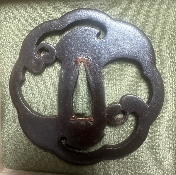

Michael 101 Posted July 22 Report Posted July 22 From the pictures I think that this is a Higo tsuba but that it’s not a main school work. The tagane marks around the nakago ana are only loosely based on the ones used by the 3rd Kamiyoshi master Rakuju but the work is definitely not crisp enough to be his hand. The seppa dai area is not very well shaped and overall the work is crude in comparison with that of the Kamiyoshi school. The iron surface is also of a different rougher finish. Kamiyoshi works were fashionable and expensive at the time and like all such things over the ages they were highly copied. Id say this is a late Edo Higo copy by Kumagai or other such artist but excellent value for what was paid. kindest regards Michael 1 1 Quote
Hector Posted July 23 Author Report Posted July 23 22 hours ago, Michael 101 said: From the pictures I think that this is a Higo tsuba but that it’s not a main school work. The tagane marks around the nakago ana are only loosely based on the ones used by the 3rd Kamiyoshi master Rakuju but the work is definitely not crisp enough to be his hand. The seppa dai area is not very well shaped and overall the work is crude in comparison with that of the Kamiyoshi school. The iron surface is also of a different rougher finish. Kamiyoshi works were fashionable and expensive at the time and like all such things over the ages they were highly copied. Id say this is a late Edo Higo copy by Kumagai or other such artist but excellent value for what was paid. kindest regards Michael Many thanks for that very thorough analysis and explanation, Michael! A lot of things make more sense now and I will definitely give the shinsa a miss. (I'm going to put three tsuba into the next one in November and was toying with the idea of adding this piece. However, I think you've just appraised it for me - thus saving me a lot of yen!) Of course, I fully defer to your expert eye but I thought I should mention that the odd shape of the seppa dai seems to be, in part, due to the insertion of the shakudo edge - almost like the steel was deformed slightly as it was hammered into place. Best, Hector Quote

Hector Posted July 25 Author Report Posted July 25 It had absolutely no active, red rust on it so I sparingly applied a little Renaissance Wax to keep it that way - and, wow, the patina really sprang to life! Best, Hector 3 Quote

Kiko Posted Wednesday at 10:10 AM Report Posted Wednesday at 10:10 AM Found this mumei daishō, made of iron with spiral gold inlay and numbered 339–340 in the 1964 Higo Kinkō Taikan (肥後金工大鑑). The description identifies the pattern as "Kumo-gata-tomoe-sukashi" and attributes the work to Rakuju (楽寿). 3 Quote
ROKUJURO Posted Wednesday at 10:56 AM Report Posted Wednesday at 10:56 AM So Hector's TSUBA is probably KUMO ni TOMOE zu HACHI MOKKO GATA SUKASHI, and I was wrong. Everyday, you learn something new..... 3 Quote
Hector Posted Wednesday at 11:31 AM Author Report Posted Wednesday at 11:31 AM 1 hour ago, Kiko said: Found this mumei daishō, made of iron with spiral gold inlay and numbered 339–340 in the 1964 Higo Kinkō Taikan (肥後金工大鑑). The description identifies the pattern as "Kumo-gata-tomoe-sukashi" and attributes the work to Rakuju (楽寿). Wow! 😳 Thank you Nicolas. m(_ _)m 2 Quote
Kiko Posted Wednesday at 11:48 AM Report Posted Wednesday at 11:48 AM (edited) You're very welcome, Hector; I’ve only just received this new reference book, and I’m delighted to have been able to put it to use so quickly! Furthermore, now that the cloud motif is confirmed, I am quite tempted to interpret those perfectly round tomoe as a reference to the taiko Raijin uses to create the sound of thunder. In that case, the tsuba’s theme could be elegantly summed up as "the storm." The spirals on "my" particular pieces seem to lend further weight to this hypothesis, as this geometric shape is frequently used to visualize invisible phenomena such as air currents, eddies, turbulence, gusts of wind, or the rapid movement of clouds. It would be Raijin and Fujin at work together ! Edited Wednesday at 11:49 AM by Kiko 1 Quote
