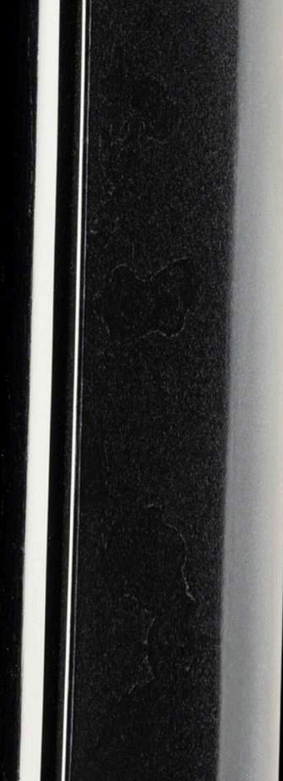

In my effort to observe and evaluate hada I'm curious how more knowledgeable viewers would describe these 'islands' on the hada. I have a hard time believing it's shintetsu but even so I personally find it quite unattractive.
Photo1.thumb.jpg.b1b4b086348dc1e72e9cd5d78fffefec.jpgPhoto2.thumb.jpg.c92f58109b7502c9dcf7ff6019108e04.jpgPhoto3.thumb.jpg.c6e96f0be7fbde62d7b0946265fa2dc1.jpg
From what I can see, this is shingane. The appearance is typical (a patch of darker, fairly featureless jihada as an island in a more 'normal' body of jihada for the kawagane).
It s often hard to tell on old high quality swords as even the core steel often had beautiful forging as well. I can definitely see clear hada in the above pictures so I personaly would lean towards it being part of the hada. Maybe patches of O Hada
“…the shingane appearing is a distinctive feature throughout all of middle Aoe as the sumi hada of Aoe.”
From Fujishiro Koto hen

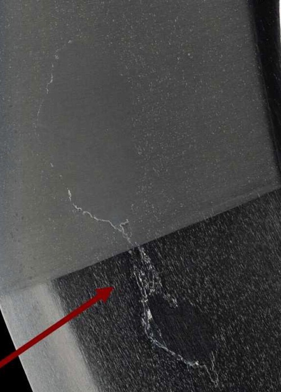

A couple of pictures from my mu-mei blade attributed to Chu Aoe Yoshitsugu by NTHK-NPO
image.thumb.png.af1e24985da9ed58827fc89ce91e5c76.pngimage.thumb.png.cdb1f869351b5232a3b554c66e3c6ec8.png
