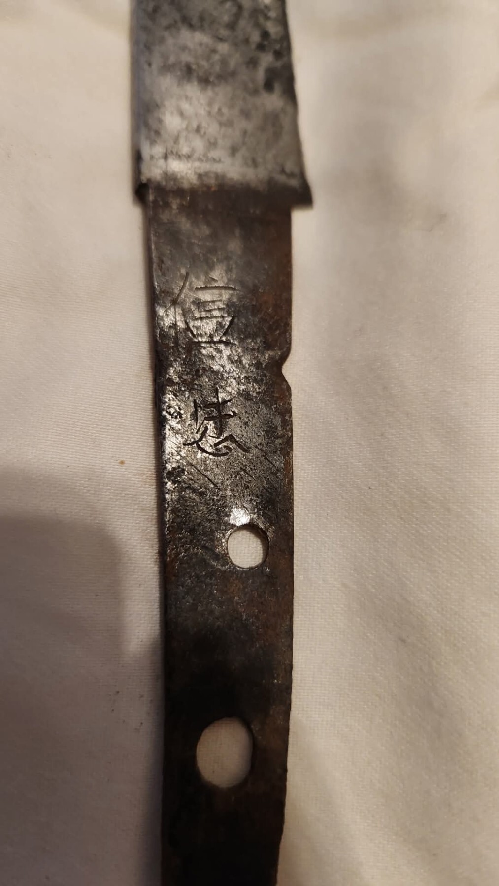

Hi everyone,
I recently won this sword at an auction.  Upon receiving it I found it to be unlike most Japanese swords I've seen.  After some research I was told it was Ainu.  Unfortunately I can't find much more information about it and the auction description just said "Japanese Wakazashi".  If anyone may know how old it is or anything else about it I'd be very grateful to know.
Well, it seems to be made with 籐 (Tou) equatorial rattan, wood and stag antler. The blade steel does not show us much much in that state, but with a bit of negative sori it does have Japanese blade characteristics; without a photo of the hidden nakago tang, however it is difficult to make too many more comments.
4 hours ago, Bugyotsuji said:
It looks like 信忠 Nobutada from here…(?)
Hi Piers, this item is also being discussed in this thread……
Always confusing when we get two threads going on the same item….
Best.C.
