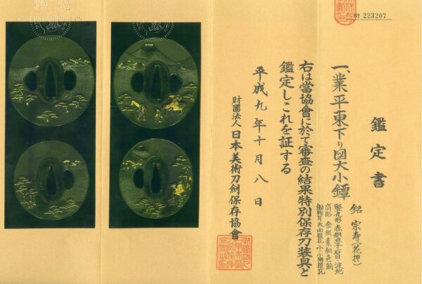

Sharing a papered daisho tsuba set from my collection. I suspect later Edo daisho tsuba are more common than the daisho blades you are discussing, but wanted to share nonetheless.
