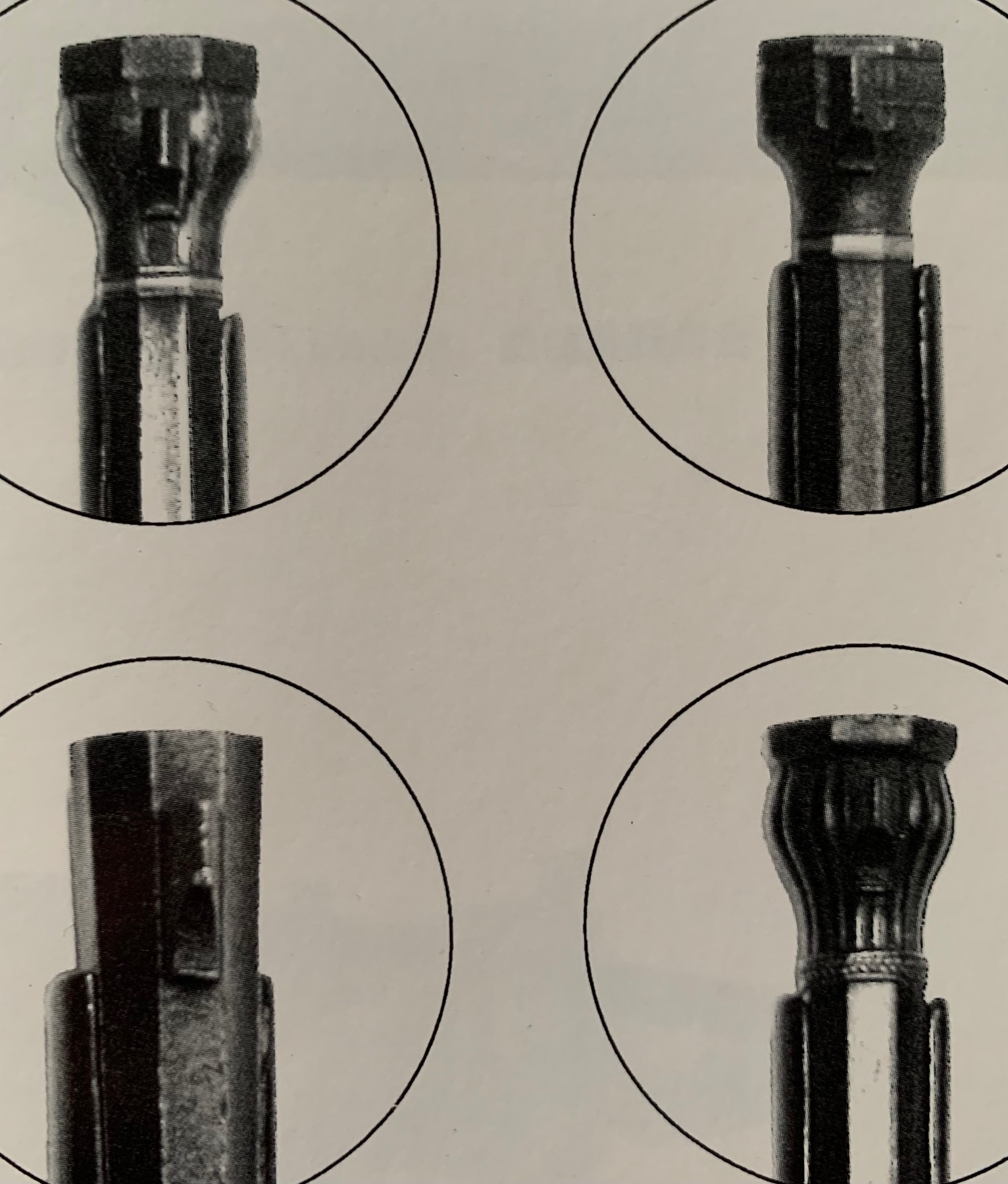

Here are four examples of Ōsaka muzzles from Sawada San’s book Nihon no Furujū.
