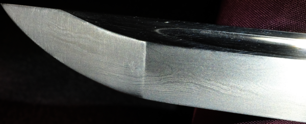

Niceke Posted September 26, 2024 Report Posted September 26, 2024 I made few videos with overall view and from under microscope . I have an old (bit worn out) microscope but still doing pretty good. Had to be an artist to hold my phone straight to the lens to capture pictures and video´s. Not an easy job after drinking 3 cups coffee Not all video´s are perfect but hopes it is some helpful. Here is the link --> Youtube playlist Here some pictures: 1 Quote

Niceke Posted September 26, 2024 Report Posted September 26, 2024 I noticed a "dents" (I don´t know the right words in English, in Dutch is Reliëf) when I goes over the hamon. Tried to capture it but not easy with the focus points. https://youtu.be/-MqgvSdRG88 Quote

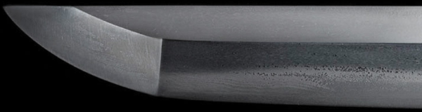

Rivkin Posted Monday at 01:00 PM Author Report Posted Monday at 01:00 PM If I remember correctly it has papers to Senjuin if only because sugata is earlier and Taima is not used for earlier than end of Kamakura blades otherwise it would be a contender - tight itame, wide suguha-based hamon in nie. 1 Quote
Lewis B Posted Monday at 01:13 PM Report Posted Monday at 01:13 PM Thanks. The reason asked is because there are elements that can be picked out in my Senjuin kodachi. The ko-nie in the monouchi being noticeably more refined on my example. The boshi with a tendancy to kaen and sunagashi appears not dissimilar to the blade you posted. 2 Quote
