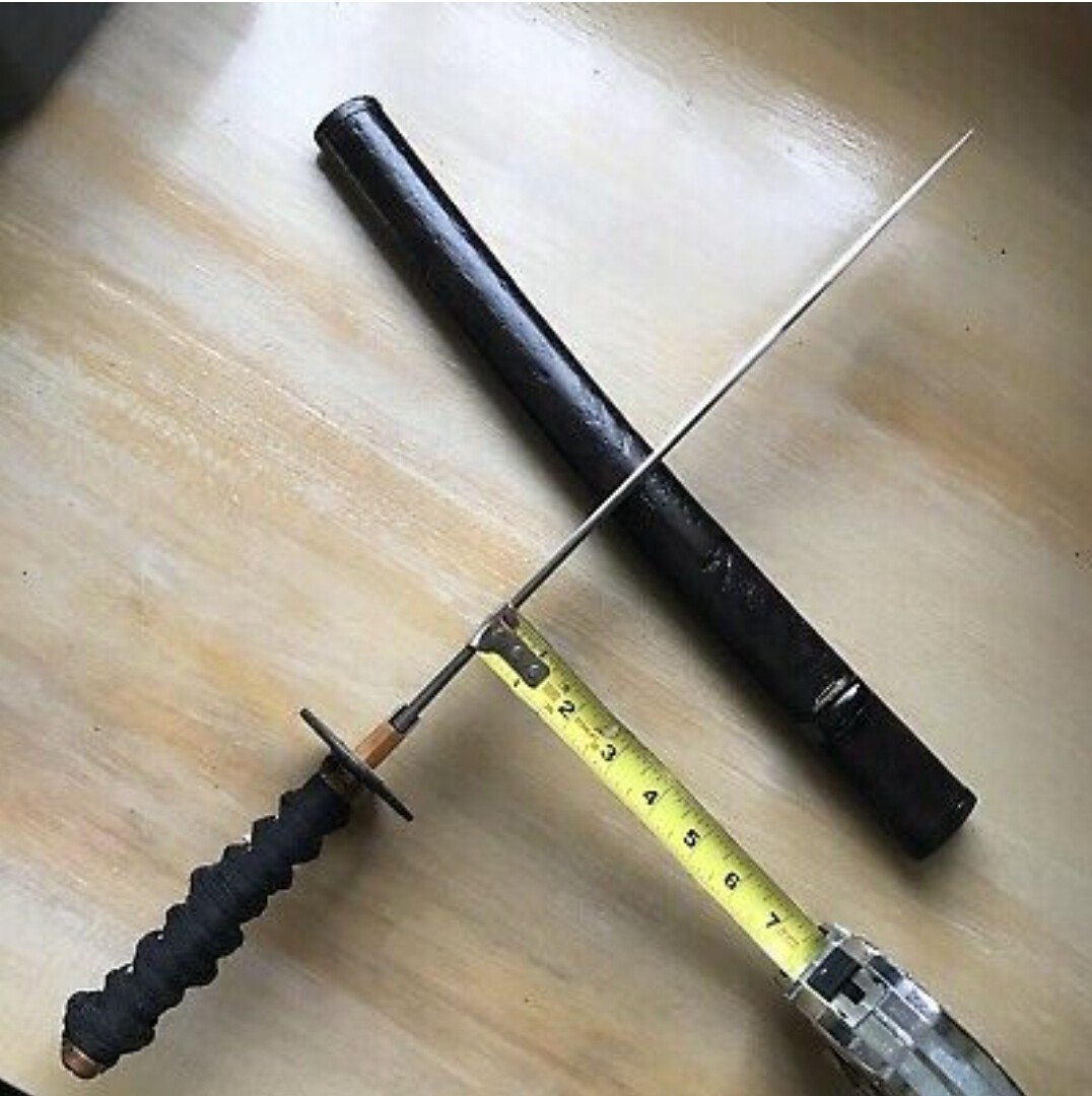

so bought this  blade has bad polish looks like they took a  buffing weel  it has  flaws etc but the nakago has not been messed with i  believe this was a World War II bring back but cant date the blade looks muromachi but cant tell  not trying to fix it but get a date on it  hamon is slightly  visible blade is  tired but if i can get a rough date on it .Micah
it kinda does remind me of my muromachi example and kinda look like #5 and #6b(muromachi). I don’t know enough to weigh in. But I’m sure photos without the habaki, and over head, including the nakago would help others. Also Nagayama’s book says kasane is useful for attribution so would help if we had a photo of the mune. Not sure if I’m just paranoid but the nakago looks odd somehow.
It’s a shame when eBay vendors break their stuff with a buffing wheel. I made the mistake of buying from someone this forum warned amateur polished/acid washed his wares. He used low res photos hiding damage and promised me it was okay. Needless to say I regretted it and should have listened to the warnings here.
Saying anything about a blade based on the information you have presented is speculation, - but based on the nakago, I'd have to wonder if this isn't Bizen production...

well dont have it in hand yet so cant really get better photos as of now but will when it comes i thought it looked muromachi has flaw but here is a full mune pic

I wonder if the buffing wheel guy made the kasane thinner than it should be?
what do you think about it?
I think what would be most helpful would be overhead views. Especially if you can take one of the mune, with the habaki removed. If the nakago is much thicker than the blade itself I would think so.
