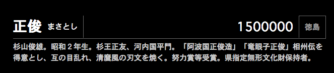

SwordGuyJoe Posted March 7, 2013 Author Report Posted March 7, 2013 I did find this. It was a bit tough to pin down (couldn't copy and paste) so had to take a screenshot. What does this say? From http://katananokura.jp/hpgen/HPB/entries/45.html Sorry to bug you guys, but google translate is of very little assistance. Quote
cabowen Posted March 7, 2013 Report Posted March 7, 2013 It is an entry for a smith named Sugiyama Masatoshi. He was a student of both Masatomo and Kunihira. He was a Tokushima prefectural intangible cultural property. I would bet that Kawachi Kunihira would know something about Masatomo. Perhaps you can ask Paul Martin to ask him- I think he knows him well. Quote
