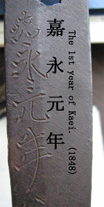

A fellow collector that i know has a katana that was mounted with edo period koshirae but also adapted for the war with a leather casing for the saya. The blade was signed but i cannot remember who made it at this point but i do remember that the blade was made in 1215.
  • 4 weeks later...
Any chance of some pictures of this 1215 blade?
