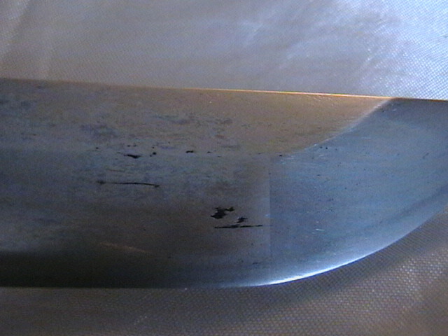

This is a scan of the visible core steel on my tanto.
Apologies for the quality. Tricky getting good focus along the full length.
There are two large spots around the hamon, as outlined, and what you see adjacent to the mune.
You can see a 'choji' shape extending above the hadori line on the right hand side. That choji - extending partially to the right, down to the habuchi, following the habuchi all the way to the left then back to the hadori line coming to the choji - is core steel. (hope that makes sense)
It's fairly clear along the mune. Adjacent to the mune is core steel.
It's fairly subtle in hand and certainly not glaringly obvious. The colour change is minor.
