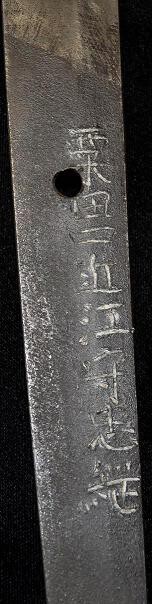

Greetings ! I found this Katana over the week-end, in an old Shirasaya, old polish, mei translates to, I believe , Awataguchi

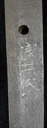

Omi Kami Tadatsuna, not 100% sure that I have it right. I have been comparing the mei with some shown in previous threads, and there are many strokes that do not match up. Other side of tang has three Kanji that I was told was a date but I think that info is incorrect, can not make out what it says. Any possibilities this is an original Tadatsuna and that I am looking at the wrong generation, or am I totally incorrect in the translation? All comments and help greatly appreciated. Best Regards, Mario P.

I have to second Chris. It is as gimei as it can get.
Please compare the original signature below.
FYI: The other side of the tang bears the owner´s name: Mr. Asai (浅井氏)
