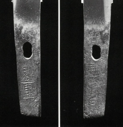

With Norishige however unlike other Koto smiths we have something very unusual. We have three very special blades that are not only dated but have his full title including where he is from.
It is very unusual to see a blade signed in this manner, especially during the Kamakura period, so why did Norishige sign these blades like this?
1.    They were for a particularly important commission or high-status client – Possible but unlikely unless the person was his father or the like - Norishige was a good smith but his reputation grew after his death.
2.    A carefully finished or presentation blade – Potentially? But again who would have wanted such a blade. Very unlikely unless it was to showcase a Etchū smith?
3.    A fully signed and dated work was intended as a formal record – This is the most probable outcome, but why?
4.    Personal pride in lineage -  I would suggest that this is again more than likely, but why?

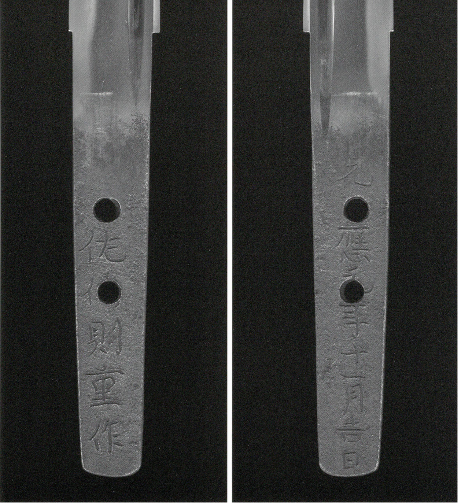

The TokuJu 24/ Juyo 33 (Tanto)
佐伯則重作 / 元応元年十一月吉日
Saeki Norishige saku / Auspicious day of the eleventh month of the 1st year of Gen'ō 1 (元応元年) (November 1319)

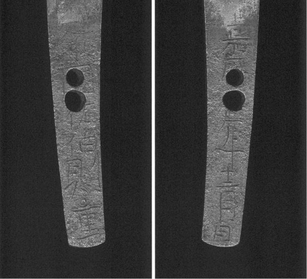

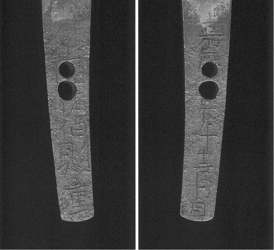

TokuJu 28 / Juyo 68 (Tanto)
越中国佐伯則重 / 嘉暦 □年十二月日
Etchu Saeki Norishige /  Kareki □, December
Here the exact date has been drilled through but it was sometime between 1326 and 1329.

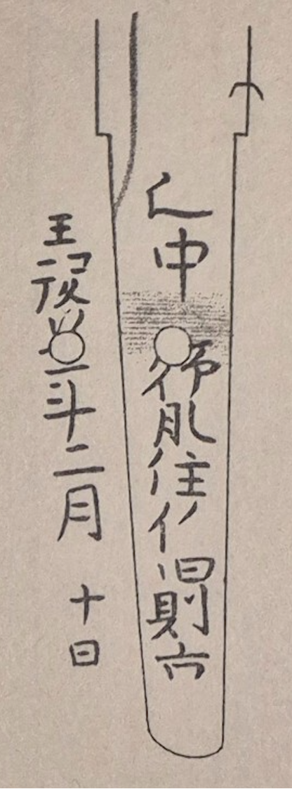

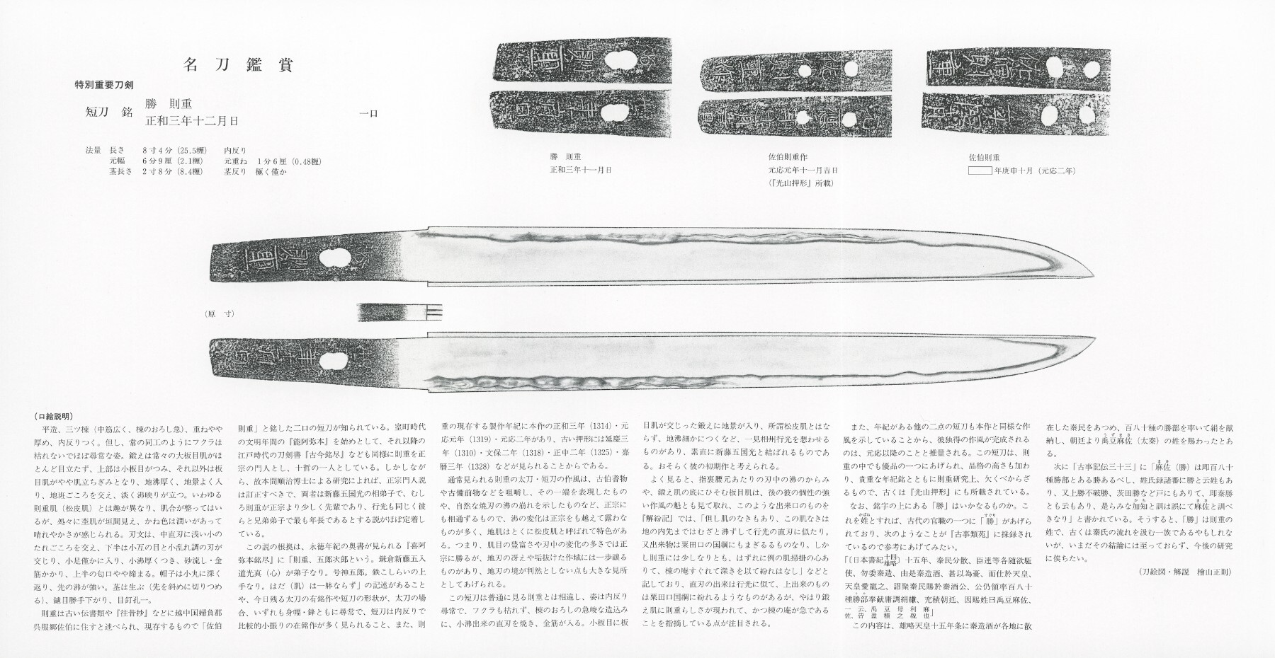

The Tanto in the Umetada Oshigata this is the same blade found in the Tokyo National Museum: https://colbase.nich.go.jp/collection_items/tnm/F-255?locale=ja
The date for this blade is a tough one to work out.
The museum suggests the first letter for the date is 嘉 for Ka with means the only logical suggestion after that being 暦 or reki meaning 嘉暦年二 Kareki Era Year 2 (1327). The previous blade above was made in Kareki but the kangi do not match and I cannot see 暦 fitting in that mekugi hole. Also, if this was a blade made around the same time as the the second blade above then I would imagine the kanji for Ka 嘉 would match?
Before we continue, one of the main reasons why the kanji may not match if it was years apart was because Norishige has been suggested to be illiterate and being illiterate he would have needed someone to help write down the Kanji for him so that he could copy it onto the tang. As such who wrote this down? That the dates changed and even the way he wrote it changed tells me he engaged someone (potential not the same someone) on three different occasions to help him with the words. It also explains why his writing is so poor making it hard to decipher 700 years on.
Back to the date kanji translation, another option is 壬辰年 or Year of the Water Dragon (1312) but Norishige never used the Chinese Zodiac for any of his other blades. It was also not very common for Kamakura smiths. So I am not buying this one. Also that "loop" above the Mekugi hole does not work.
The final possibility is 正応二年  or 2nd year of the Shōō Era (1289). This is my favourite as it matches the writing more than the other two even around the loop that gets cut off by the mekugi hole.
Thus we get:
正応二年二月十日 / 仁中御服住伯則重 (越中御服住伯則重)
Shōō 2 (1289),  2nd Month, 10th day / Etchū, Go-Fuku Resident, Saeki Norishige
This is a rather special inscription on the tang as it literally gives us his town Go-Fuku in Etchū. It tells us that Norishige was a resident of this little town, whilst the other two blades simply state that he is either a member of the Saeki Clan or the Saeki Clan from Etchū. As such we can also conclude that of these three blades two could be whilst he is not resident of Etchū, that is he was living in Kamakura. We can also assume that as he has written Resident on this blade that he must be living in Go-Fuku when he wrote this on this blade but before we do we also need to consider that this is also considered one of his earliest blades and therefore this one may also come from Kamakura but captured by a youngster who still identifies as being from Go-Fuku and is only in Kamakura to study under Shintogo. Logic being that he may have wanted to capture the name of the town he grew up in on one of his first swords - pride of place is a huge part of ones life. A student in Kamakura but not a resident as his home town is still Go-Fuku. As a zealous up and coming smith I can certainly appreciate wanting to capture his whole story on one of my first blades. First sword smith from Go-Fuku? Making it big in the big smoke.
But the date 1289 poses a problem. Norishige we are told in the Kotō Meizukushi Taizen was born in the 3rd year of the Shōō era (正応三年, 1290) in Gofuku-gō (御服郷 / 呉服郷), Nei district, Etchū Province. As such according to this book written in 1792 this is not possible. However, let's consider this. 1792 is some 500 years after the fact. As such this book would need to reference earlier books to give us this date. Making this book a 2nd or 3rd source book. And as such, whilst this book is great for reference we need to consider that this is not a contemporary account.
The blade however is written by the hands of the man. It is as contemporary as you can get a sort of time machine - assuming it is not gimei, which most experts agree it is not.
And so whilst this date does not make sense to his already being alive and making swords in 1289 perhaps it is telling us something else. Perhaps he is actually giving us his birthday? It is certainly the only blade with a month and a day on it. As such, is Norishige capturing the date of his birth and preserving it for history: Saeki Norishige, resident of Etchū was born in the 2nd year of Shōō 10th day of the 2nd month or the Gregorian Calendar, the 3rd of March 1289. Now if that is the case then that is one of the rarest things in the sword world. It would certainly be the only blade that I am aware of with a birthday on it to give us the exact date when a sword smith was born.
I do not think this is the correct reading (and I could be wrong) - if it is, it would reshuffle my understanding of this smith, for reasons that I will elaborate on later.

I don't know Sōshū that well and it is a school I do really struggle to understand, I can't understand the fame. I got gifted the wonderful Sōshū-den book by NMB member and I admit I am puzzled by many things in the wonderful book. It is very well researched so it is most likely correct information.
However I would think even late Kamakura Sōshū smiths would sign their tachi. There are several signed Shintogō Kunimitsu tachi, there is a signed Masamune tachi etc. I cannot see any reason why they would make mumei tachi, now I agree that the amount of ō-suriage mumei above certain length does not make logical sense, as not all of those surviving swords were in my mind ōdachi. I do personally believe not all remaining ō-suriage mumei are ō-suriage mumei, however I do not have skill or knowledge to prove my theory. I also think that several of the tachi that are currently judged as ubu mumei would have had a signature originally. Just my personal thought and way of thinking.
Thank you for posting the item in Umetada oshigata and the connection to Tokyo National Museum item Brett. That was a new thing for me.
What is interesting I personally think TNM might be skeptical of few Norishige tantō they have in the collection, as they haven't published pictures or information about the items on the website. I cannot see other logical reason why they wouldn't publish and document these extremely valuable signed examples well. They do have another interesting signed Norishige, and it is with Kamakura signature, that might be extremely interesting to the Sōshū lovers on board.
It is signed □□国鎌倉住則重 / 保元年十二月三日 □□ Kuni Kamakura jū Norishige. As there is no picture it is impossible to say anything about the year but using logic I would think it is missing first character and it would be 文保元年, as in 1st year of Bunpō (1317). That would probably be fitting the timeline being established for the smith. https://colbase.nich.go.jp/collection_items/tnm/F-247?locale=ja
Also it seems there has been Imperial collection item signed 相模国住人則重 and dated to 正中 (1324-26), however it seems Honma Junji doubted the legitimacy of this item.
One thing is that whose authority will you accept on items. At Ōyamazumi-jinja there is a dated naginata by Norishige It is signed and dated to 1325, 正中貮□十月日越中国住人則重. Now I think it is easy to discard the shrine items that do not have authentication by Bunkachō or NBTHK but I feel they are extremely valuable items. I have seen the naginata several times, I cannot of course say if it is legitimate Norishige. However what is interesting is that several dated tachi oshigata by Norishige on Sōshū-den book have the similar form where year is written first and then Norishige signature on same side under it.

TokuJu 9 / Juyo 31
勝 則重 / 正和三年 十二 月日
Katsu Norishige / Shōwa 3 12th month or December 1314
Note as this is not one of the decade birthday blades as such it falls in the middle between 1309 and 1319. In December 1314, Norishige would have been 25. He also as such does not call himself Saeki here nor does he reference Etchū. He instead uses the word Katsu 勝 (Win/Victory) above the mekugi hole and before his name.
In terms of dates;
1312 - Shintogo dies
1312-1317 - student of Yukimitsu.
It is unclear why he signed with the Katsu 勝 (Win/Victory) Norishige with a date however, scholars including our own @Markus suggest this is Norishige deliberately paying homage to Sanemori showing his Ko-Hōki affinity as the 勝 is placed in the exact same location that Sanemori placed his on the Nakago. Sanemori is the only smith prior to this blade that used this character in this position. It makes sense that this happens whilst he was apprenticing under Yukimitsu who together with Masamune were certainly greatly influenced by ko-Hōki Smiths... certainly more than Shintogo. In fact the older writings suggest Masamune was trying to imitate Yasutsuna - as such clearly that was his love.
It should be noted that whilst Norishige appears to be showing his love for Sanemori's work here. Yukimitsu whilst being influenced by the Ko-Hoki was alot more conservative in his approach and in this regard even though he is expressing his love for the Ko-Hoki smith Sanemori here, this blade is also more conservative and reflects Yukimitsu and Shintogo's conservative teaching more than Norshige's more flaboyant later works.
As such this also may be the first time he attempts to break from Etchū with his own makers mark - certainly he has done this for a reason, although this reason at this specific date remains unclear. Perhaps this is the moment he decided what type of smith he wanted to become. This signature however is not something he turned into a ongoing habit when signing. A moment in time perhaps as he found himself - expressing his love for ko-Hoki.
Regardless this signature strengthens the theory that Norishige signed his blades at times to express his individuality and not purely for commercial reasoning.
