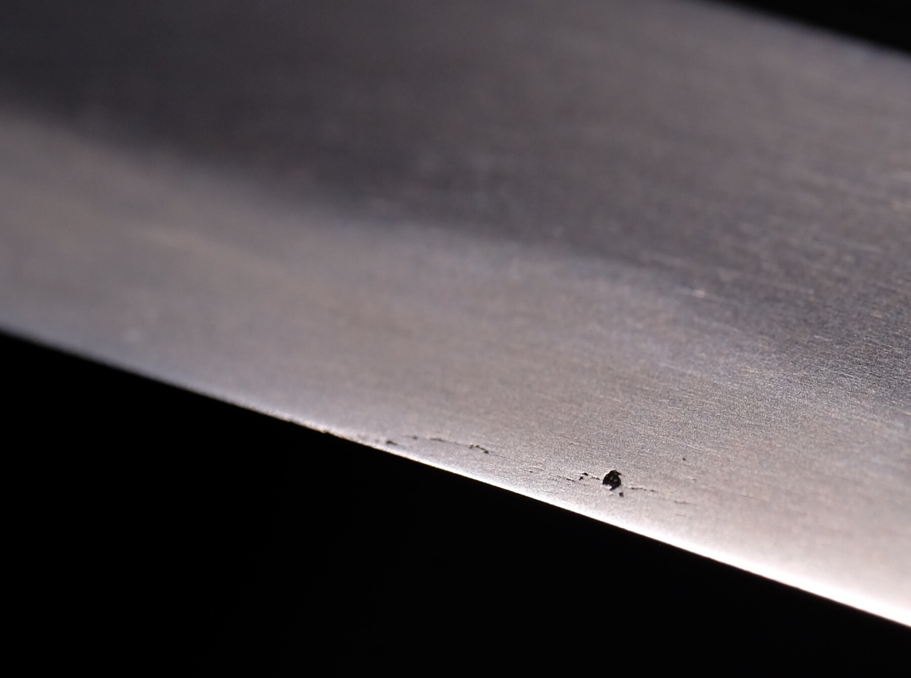

For me a forging issue/inclusion exposed after many polishes. The shape doesn’t suggest corrosion but that could be another explanation.
yeah I think the same. You can see what look like small forge pattern lines coming off of the main exposed area which signals to me just an old opening. It is about 1mm.
Posted (edited)
I have something very similar on my senjuin Kodachi sword. I think it’s called hagarami. The crater is about 1/4mm and the horizontal line 2mm. Looks more significant under a macro lens and only visible on one side.
