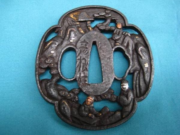

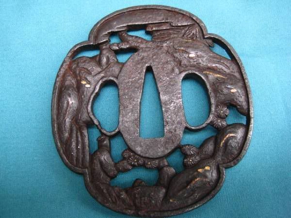

I saw this on an auction site, and I've been wondering if this is a Soten? I can't read the mei so I really can't tell. Could you also please tell if it is real? Measures 77mm x 71mm. Also, there seems to be recent file marks in the nakago-ana... what does this indicate aside from widening it?
Thanks,
Aldwin
Dear Aldwin
The tsuba that you have posted is an example of the poor quality, Hikone-bori work that was extensively produced during the late Edo perion by shiiremono makers. The inscription reads HIKONE (NO)JU. A copy of Soten work, this tsuba has never been mounted, and I suspect that it may be cast.
Regards, John L.
Hello John L.,
Thanks so much for your reply, that was very informative.
I read about these shiiremono makers producing copies of Soten work, but never seen an example until this one. Once again, thanks.
