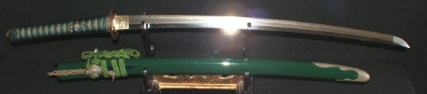

This was an auction purchase from some time back that finally turned up. I am a Nihontophile but still a novice as far as I'm concerned so thought it wise to consult the more senior Jedi here as to its origins.
Overall length: 30.75"
Nagasa: 24.25"
I believe that puts it right on the border between Daito & Shoto.
The "shira-saya" if you can call it that is in appalling condition with cracks, tired laquer reddening and god knows what else, but inside the blade seems to have reasonable geometry and certainly a hamon. I don't know enough to rule/out gunto or modern production origins myself, but to me the blade seemed to have a little too much sori and erratic hamon for a gunto, and too battered to be post-war. It also seemed like a rather nice habaki for a non-nihonto from what I've come across.
There is black & brown oxidation, some opening of the grain and small chips in the edge near the habaki. Blade seems to be sharp all of its length.
Will try and get a shot of the nakago in daylight later. Seems to be mumei, with two mekugi-ana. More than just light rust.
Thoughts? Nihonto? Era? Shortened? Stubby katana or lengthy wakizashi?

Please sign your name on all posts - it's a rule here. I have put my foot in my mouth more than once, but here goes. Your sword is too long to be considered a wakizashi. It's a daito. It's definitely not modern or reproduction. It's the real thing. I can clearly see the hamon and activities in the hada. It probably needs to be polished to see more activites, but the cost is high (~$100-$150/in). Overall, I like your sword, but there is a fairly long opening. It's not a fatal flaw, but lowers the value of the sword significantly. If you want to get new shirasaya without polishing the sword, it will probably run around $400-$450 (re-using the old habaki, which I think is very nice). Hope my two cents help.

Yes, I wasn't sure on the length as it's the shortest daito I've scene, even including gunto - and I understand some shoto were deliberately on the borderline in length as chonin and other wealthier non-warrior caste members sought to bend the rules. Modern Iaito seem to be much longer on average by comparison!
My hope was indeed to get the blade polished & remounted one day, funds allowing. I've not encountered an urushi lacquered shirasaya before but whilst this one may once have been grand (there is gold paint/laquer at the koicguchi) it is somehwat dilapidated now and probably responsible for the condition of the blade. Could polishing correct the open grain(s)? And if not, are they enough to make repolishing and remounting a bad investment (financially)?
I paid about 600$ US in the end, which I felt was a bit steep if it proved to be Gunto, but reasonable for Nihonto.
Could anyone offer any suggestions as to age, etc? Or signs of suriage?

Sometimes kitae-ware can be polished away... it depends on how deep they are, and how much material needs to be removed to restore the sword to proper shape. On the other hand, more ware can surface during polishing, so...

I'm a beginner, too, so take what I say with a grain of salt. I figure if I offer my two cents and they happen to be wrong, the more experienced membership here will correct me, and both you and I will learn in the process - no harm done. No thing ventured, nothing gained, so to speak. Having said that ... since the two mekugi ana are fairly far apart, I think the sword is osuriage. The sword has a very nice suguta (to me anyhow). Since I believe it is osuriage and the shape has some curvature to it, plus the hada is is very active, I would guess koto, but in the past, I have been been wrong more often than right :steamed: The lighting on the nakago is too dark and I can't tell the color of the patina - this is one indication of age. Please weigh in, guys!!!!
Adam is an experienced member here, and he is absolutely right about polishing: it could remove relatively shallow openings, but could open up new ones just waiting under the surface. If you are serious about polishing your blade, I would suggest dropping Bob Benson an email (bushidoswd@aol.com) and ask him if you could ship your blade to him for his professional evaluation. All it will cost you is the round trip shipping, say about $100 (including insurance). He will tell you if the blade can take a polish, and if it is economically viable. Here are some numbers for you to consider. The cost of polishing will be around $100/in, e.g., about $2500 in your case. If you polish with Bob, ask him to get new shirasaya and a new habaki. He will coordinate with John Tirado to get things done properly. He will do the initial foundation polish. Then, send it to John for habaki and shirasaya. Then, everything goes back to Bob for the final polish. Habaki + shirasaya for a daito will run about $850 ($400 for habaki and $450 for shirasaya). Add on top of the cost of shipping both ways, about $100. The total cost will be $2500+$850+$100=$3450. I don't think you will get it back out when it's time to sell your sword. So, it's up to you. For $3,450+$600 (your original cost)=$4,050, you can get a decent sword with NBTHK papers already.

Having this blade polished might make sense; might not. A properly trained polisher (like Bob Benson) can give you that answer.
I can tell you that it doesn't make sense to have koshirae made for this sword. Whatever you come up with will always be a modern made, assembled by a western collector, jumble of newer and older parts. When the time comes to sell (and it will) you'll be lucky to get half back what you put into it.
If you want a sword in mounts save your money and buy one; easier, cheaper, and better at holding value than plan A.

Does anyone have any light they could shed on the sword's past? Do signs indeed point to O-suriage Koto as Hoanh posited? I am out of my league here - the condition of the sword made me think Gunto/Edo period most likely, but the decent sori and coarse hada...
I had a suggestion on SFI than the sword may have been cut to fit Russo-Japanese war mounts or WWII Naval (Kaigunto?) mounts and since put back in Shirasaya...

My initial thought was/is that this is a suriage late Muromachi blade (this might be way off though...). I think the sword is bit too slender to be an early Edo blade. Also this seems to have shallow sori (it might be just my eyes), but as I think this is suriage with lower ana being the original one, that would slightly increase sori and together with slenderness that wouldn't fit my stereotypic view of Kanbun Shinto or later Edo blade (of course there are variations but I tend to have my own mental image). Also like Hoahn and yourself noted the coarse hada would be one point that I too as a novice would classify as koto feature. Can't see hamon really well but could it be suguha based midare?

Looks to be suriage but I don't think I can say from the photos it is koto. The hada looks more shinto to me.....

Another thing I was wondering apart from the age is that the hamon seemed unusually thin. Is this a sign of a low-quality or tired over-polished blade? Or a poor polish?
As an aside, does a thinner/thicker hamon make a sizable impact on a blade's performance, altering the levels of austentite etc?
Share this post
Link to post
Some say a bright hamon is a sign of good steel and proper hardening, but polish can have a lot to do with how bright the hamon looks. As far as performance, you want the yakiba to be hard enough to keep a sharp edge, but not so hard that it becomes too brittle. It's hard to tell these qualities by eye, which is why they put swords through cutting and performance tests in the past.
