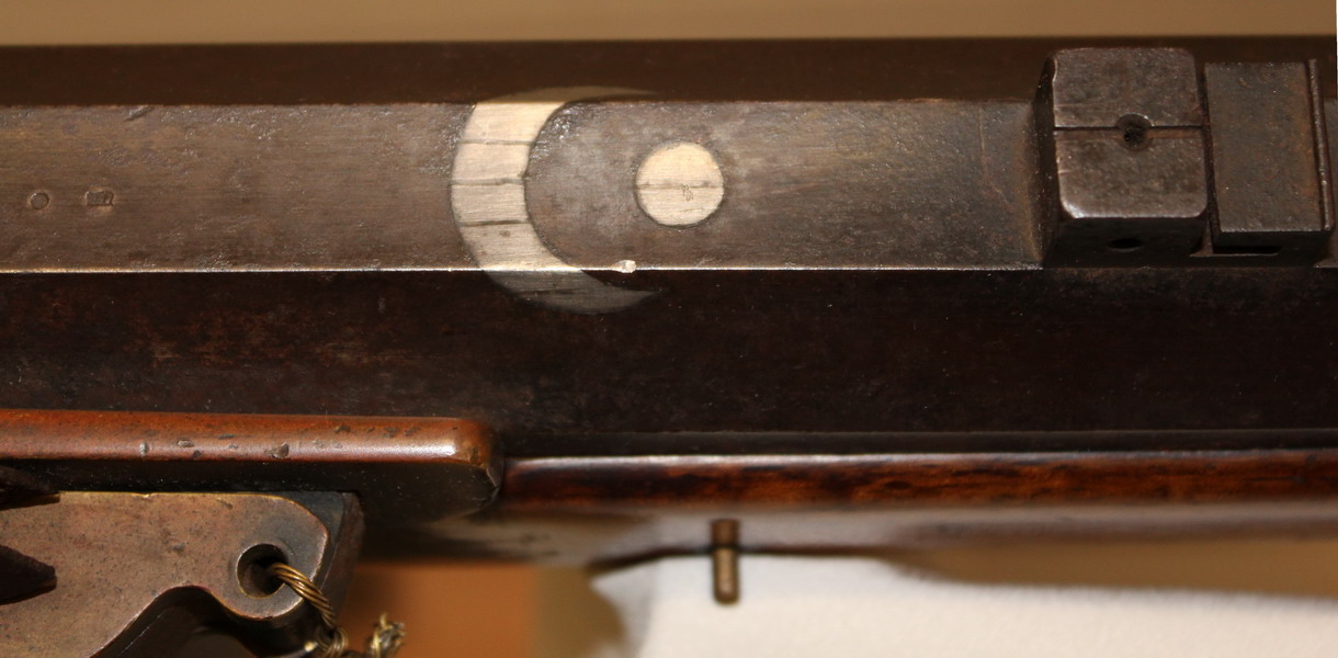

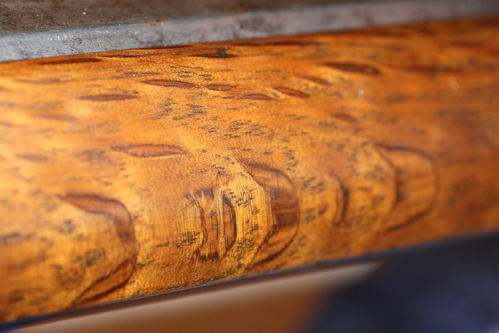

Teppo mei!
After I adress the horrible "cleanup-job" done to the barrel I think it will be a rather good looking old gun in my collection. Here´s some pics of the amazing woodgrain. If only my IKEA-furniture could sport this patina...

Beautiful woodwork. Someone on this site mentioned on another thread that when the wood is 'quarter cut' those jewel-like patterns can be seen at their best.

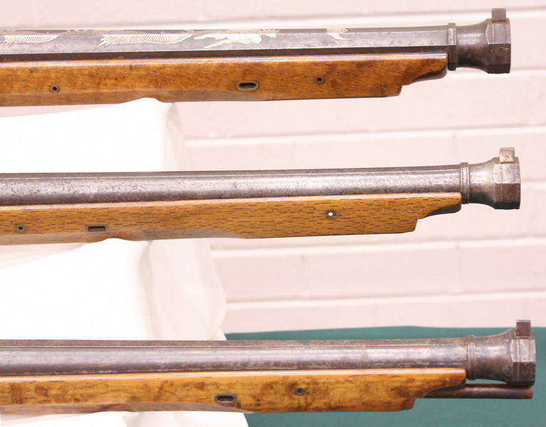

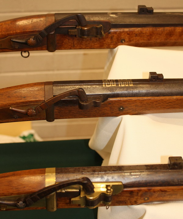

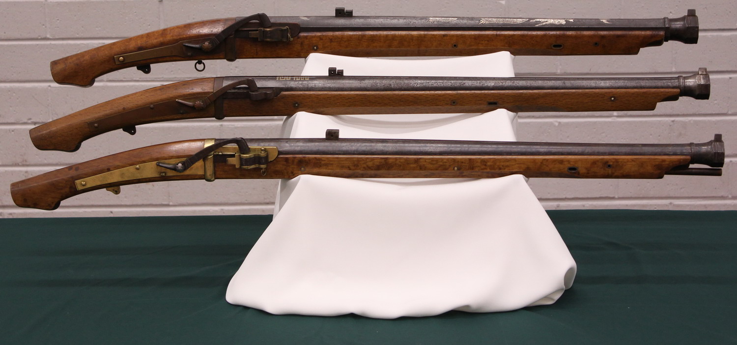

Ahh, thanks for that Piers. Now. I've got some photos and I'm going to puddle around trying to attach them. These are just the display shots with self-explanatory titles. I'll try and do the bbl and stock etc inscriptions later.
Regards,
BaZZa.
Dear Barry,
All three guns are Kunitomo work. It would be of interest to have photographs of the signatures. I am rather surprised that you found three guns of virtually identical proportions and style together. Wonder what the story is behind that :dunno: ! Thank you for the photographs.
... Ron Watson
Nice little collection of teppos. I agree that someone gone to some length to get hold of similar teppos. All three have dif woodgrains. Very intresting to see the signatures, if present. Perhaps the same group of gunsmiths have produced them.

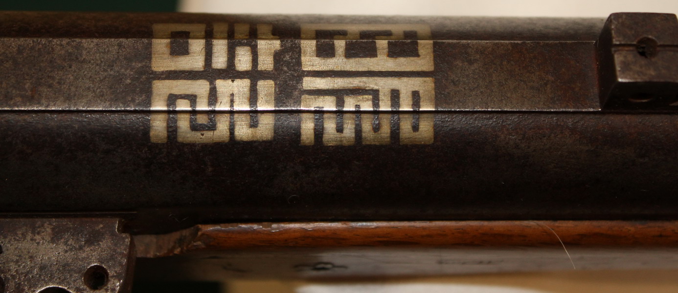

The top teppo belongs to the Ito-clan. The bottom bottom to the Abe-clan. The middle one I would take a stab and place it with a sohei from a buddisttemple. I have never come across this mon before. I can be way wrong here, but what´s life without some gamble once in awhile :D

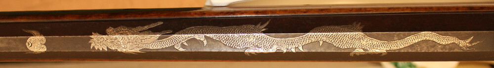

Regarding the middle teppo:
Is mei of middle teppo "Kunitomo Tobei Yoshimasa" ?
9th gen,Kunitomo Tobei Yoshimasa 国友藤兵衛能当
If so, his art-name(GO) was "Min-ryu or Nemuri-ryu".眠龍
The 2 characters of the inlaid work on the barrel says "Min-ryu/Nemuri-ryu" (a sleeping dragon)眠龍.

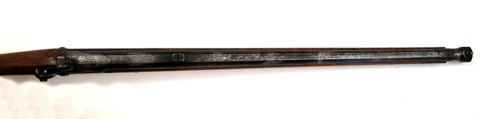

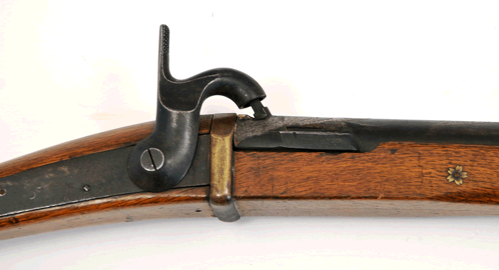

Here´s a teppo that was up for an auction in Sweden a couple of years ago. I don´t know the correct english term for this kind of model. But the stock and firemechanism are different compared to older teppos. I would place it at 1800-1850:ish. About 107 cm and 15mm caliber. Kind of the next generation of teppo I guess. Personally I like the older mods.
Jan
Piers, These are indeed an interesting and rare collection of SE Asian guns. I wonder how accurate the origins claimed for these guns are.
Jan, That gun is a very late one made after the American's had introduced percussion cap ignition. Prior to this the Japanese were making 'pill-lock' guns that used small pellets of detonating compound. These latter must have been very difficult to use, the tiny pills being about 2mm diam, and explosive to boot.
Ian Bottomley
Dear Jan,
To slightly correct Ian's description .. " That gun is a very late one made after the American's had introduced percussion cap ignition. " This gun was not MADE after the introduction of the percussion cap, ... rather it is a CONVERSION of an existing matchlock to the percussion system.
A few guns were made by the Japanese using the percussion system, ... but this example is not one of them.
... Ron Watson
Ron, You are quite correct. I was sloppy in my wording. There is something odd happening to the breech area of the barrel on the opposite side to the lock. On the lock side the barrel seems to have been roughly filed down where it butts against the brass band. It also seems to have the same treatment on the back as well - one wonders why.
Ian Bottomley
This looks like a good example of a percussion cap update to an older Ogino-Ryu matchlock. The lock looks completely replaced, and the breech end of the barrel looks as if it has had a wedge section ground away and a new nipple section inserted somehow.
