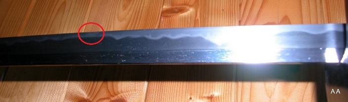

On the photo the sword looks to have a nioigire at the point I've highlighted. I could be wrong and its just an illusion from the photo but its probably worth checking that spot carefully.
Your probably aware but the fuchi kashira are typical Jakushi school work.
Nice catch.

I'll be very carefull about this fatal flaw because of the Hadori polish, has to be seen in hand

Hi,
Save your money unelss you want to learn what is the result of over polishing.
Peter,
This kind of flaw (hamon running out the ha-saki) is called kakedashi not nioi-gire.
