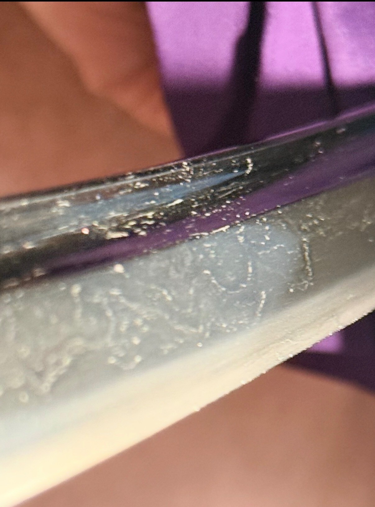

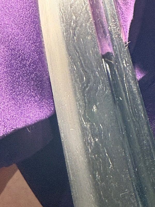

Raiden631 Posted July 11 Report Posted July 11 Hey all, Picked up a mid-kamakura tachi to Den Hoju with TH. I know there are very few examples so thought this would be a good reference. Nagasa: 65.1 cm Sugata: Torii zori/Ubu Sori: 2.3 cm Motohaba: 2.6 cm Sakihaba: 1.8 cm Moto kasane: 5.7 mm Saki kasane: 4.0 mm Kitae: Itame/Mokume with running nagare forming some ayasugi. Ji-nie and plenty of chikei. Hamon: Ko-midare with hotsure, ashi, yo, yubashiri and kinsuji. Boshi: Thin o-maru 2 1 Quote

Lewis B Posted July 16 Report Posted July 16 I recognize this kodachi. I had an opportunity to purchase it from the dealer in Japan. Nice study piece with lots of activity. Papered as a tachi. Bohi is in all probability atobori. The hataraki is quite complex. 2 Quote
Raiden631 Posted July 16 Author Report Posted July 16 1 minute ago, Lewis B said: I recognize this kodachi. I had an opportunity to purchase it from the dealer in Japan. Nice study piece with lots of activity. Papered as a tachi. Bohi is in all probability atobori. The hataraki is quite complex. Indeed. Quite complex. Has quite a bit of depth. And could be atobori, but ubu from NBTHK. Still wondering why the Den. Quote
